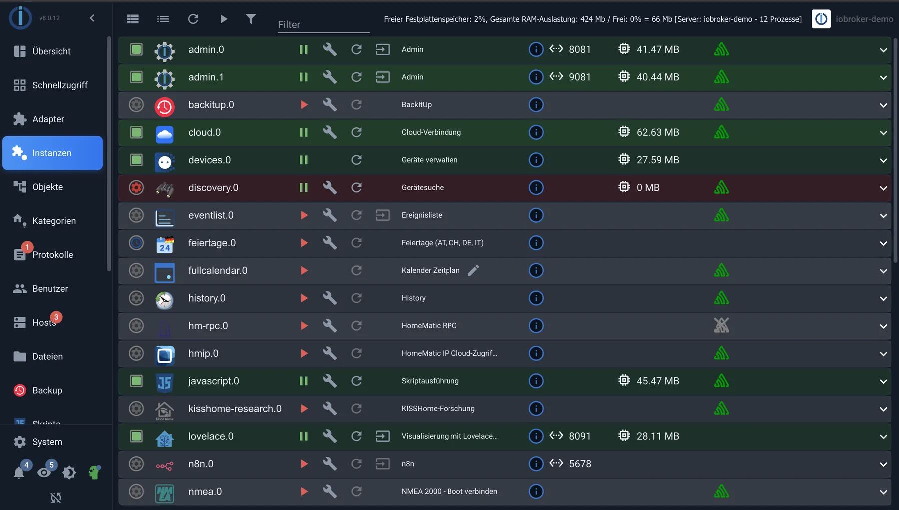

The page consists of three areas: on the left the menu bar with the tabs, to the right of it the main window and above it a toolbar , the content of which depends on the currently open tab.
The system settings are located at the bottom left. The system settings are configured there, and next to it is the switch for expert mode.
The three areas: on the left the tabs, at the top the toolbar of the open tab, in the middle the main window, here the list of instances.

| Instance | The ongoing connections: configure, start, stop, and see if they are running. |
