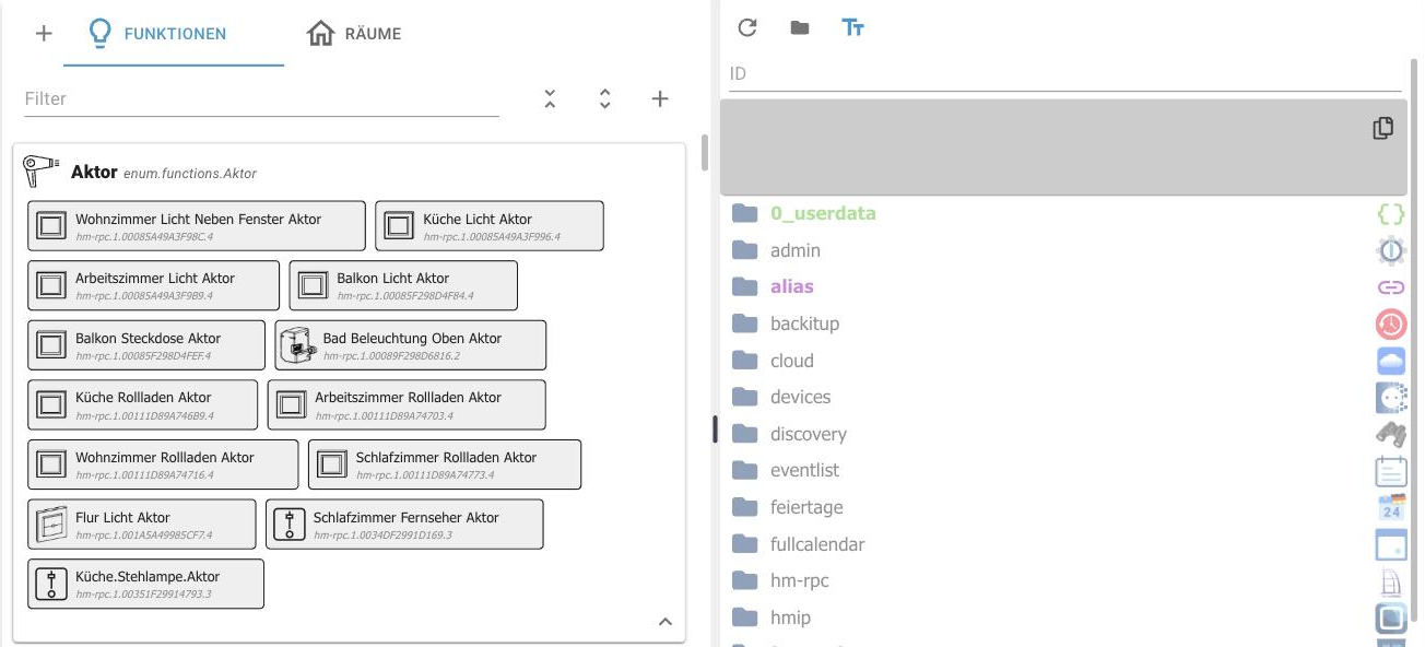

functions
Der Reiter Kategorien mit den Funktionen
On the left are the categories with their associated data points, on the right the object tree. A data point is assigned by dragging it from the tree onto the desired category.
Above the list are a filter , buttons to expand and collapse all categories, and a "+" icon to create a new category. The "+" icon in the top left corner creates a top-level category.

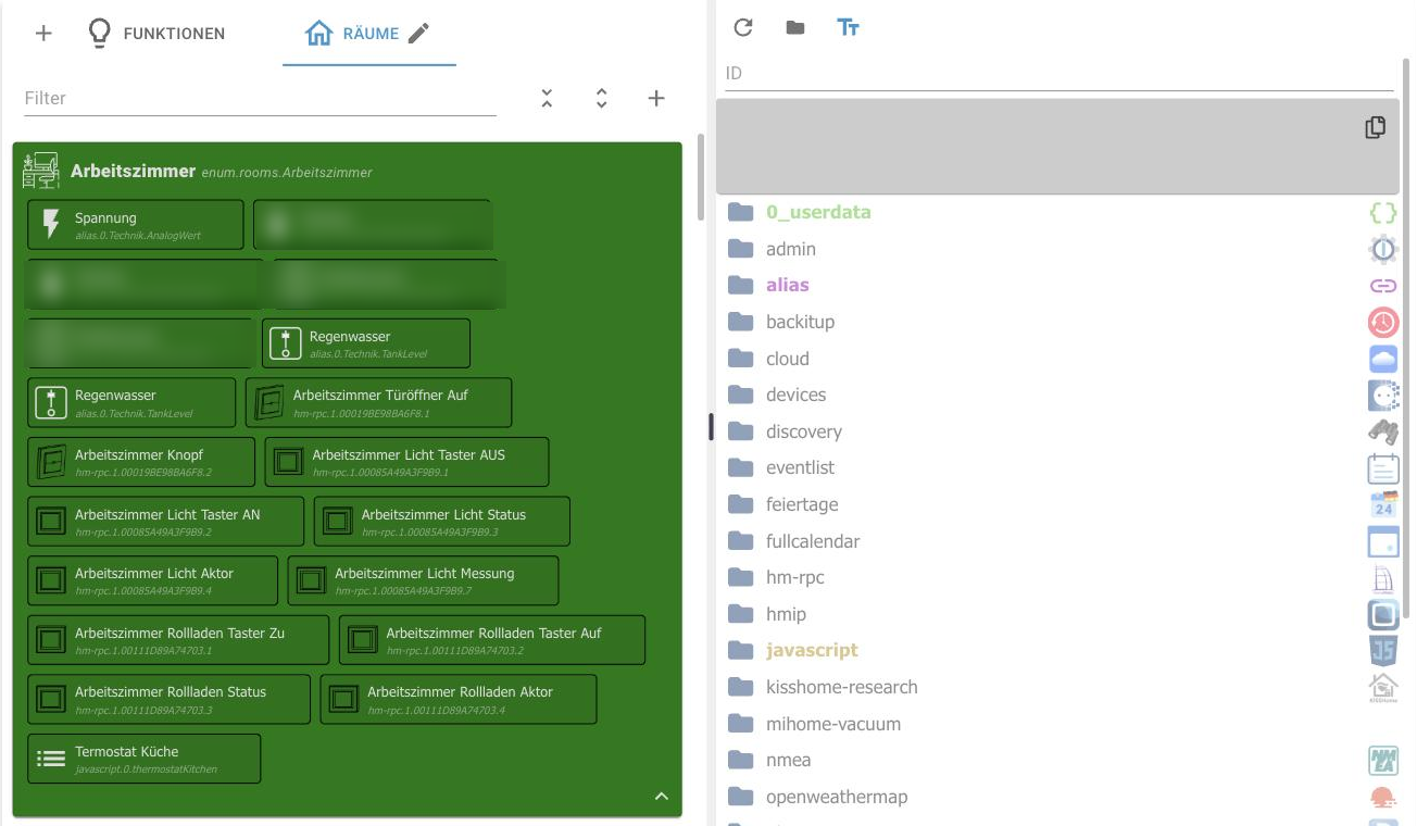

Rooms
Der Reiter Kategorien mit den Raeumen
The rooms work the same way. Using the pencil icon next to the tab name, you can change the name, icon, and color of a category. The color changes the entire group, making the list easier to read.
Rooms can be nested together: the ground floor can contain the living room and kitchen .
