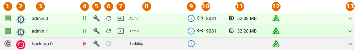

Read one line
| No. | Meaning |
| 1 | Status. A green square means: running. A gray gear means: stopped. A clock represents a time-controlled device that only runs briefly. |
| 2 | The adapter symbol. |
| 3 | The name of the instance . |
| 4 | Start/Stop. Two bars mean "running, stop here", the red triangle means "stopped, start here". |
| 5 | Settings : opens the adapter's configuration. The information displayed there is described in the documentation for the respective adapter. |
| 6 | Start anew. |
| 7 | Instance link : leads to the web interface of this instance, if it has one. |
| 8 | The title . It can be freely changed, which is helpful when using multiple instances of the same adapter, for example.hm-rpc.0 for RF andhm-rpc.1 for Wired. |
| 9 | The log level of this instance. |
| 10 | The port on which the instance is listening. |
| 11 | Current RAM usage . |
| 12 | Whether the adapter reports crashes to its developer via Sentry . |
| 13 | Expands the details row . |

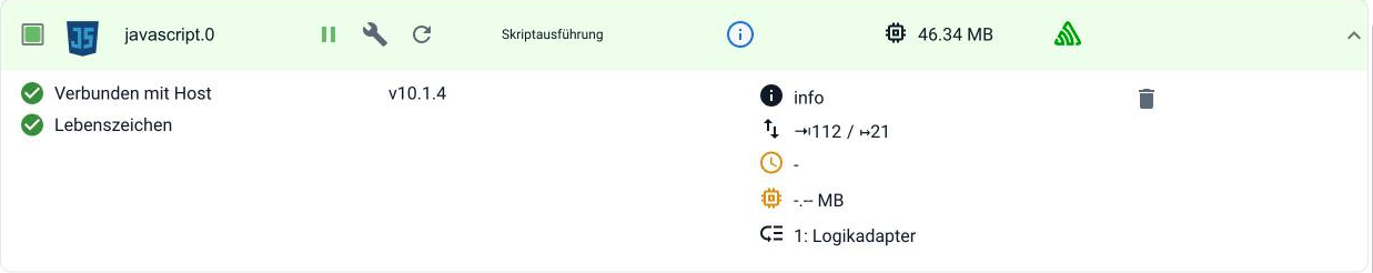

The detail line
When expanded, the left-hand line shows whether the instance is connected to the host and sending a signal, along with the installed version. The right-hand line displays:
- the log level : from
debugaboveinfoandwarnuntilerrorIf something isn't going smoothly, it helpsdebug; then reset it again, otherwise the log will grow quickly. - Input and output events : how many values the instance has received and sent since startup.
- Automatically restart : a schedule according to which the instance will restart.
- The RAM limit . It's an upper limit, not a reservation. Don't set it too high on systems with limited memory.
- The starting order (tier) . Smaller numbers start first:
1Logic adapters are followed by data and surface adapters. - The trash can deletes the instance along with its objects. Other instances of the same adapter and the adapter itself remain.
Two green checkmarks on the left don't automatically mean everything is correct: they only indicate that the instance is running and communicating with the host. Whether the connection to the device is established is revealed by the object.info.connection the instance.
