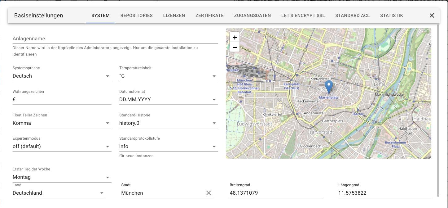

system
Here are the basic settings, which the adapters also refer to.
Der Reiter System der Basiseinstellungen
AttitudeMeaning
Plant nameAppears in the admin's header. Useful when managing multiple ioBroker installations.
System languageThe language of the interface. Not every adapter is fully translated.
temperature unit°C or °F. Some adapters use either.
Currency symbolFor example .
Date formatApplies to admin and vis.
Floating divisor charactersComma or period for decimal numbers.
Standard historyWhich instance records values when multiple instances of history, SQL, or InfluxDB are installed.
Expert modeWhether expert mode is already enabled when opening the admin interface. The switch in the bottom left of the menu bar only applies to the current browser session; this setting is permanent.
Standard protocol levelThe log level that new instances receive. Existing instances remain unchanged.
First day of the weekFor calendar and schedule displays.
Tips for getting startedThe administrator may display a "Did you know?" box with a tip when the window is opened. If you disable it within the box itself, you can re-enable it here. This setting applies to the entire installation.
Country, city, latitude and longitudeThe location of the system. Adapters for sunrise and sunset, weather, or astronomical time schedules are included. The map next to it is for reference only.
Anyone using schedules like "half an hour after sunset" should first set the correct location, otherwise ioBroker will use the preset location.

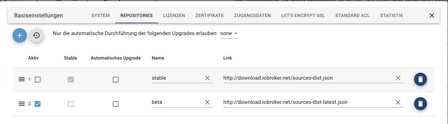

Repositories
ioBroker retrieves its adapter list from a repository. Two are included by default:
Der Reiter Repositories
  • Stable : the tested versions. This is the right choice for a system that needs to run reliably.
  • beta (also Latest ): the latest versions, not yet fully tested.
The checkmark in the Active column determines which repository is used. If beta is active, a corresponding warning appears in the Adapter tab.
If there are additional entries from an old installation, they should be removed. They are no longer maintained.
The " Allow only the automatic execution of the following upgrades" setting determines whether ioBroker Adapter is allowed to update itself and up to which version level.

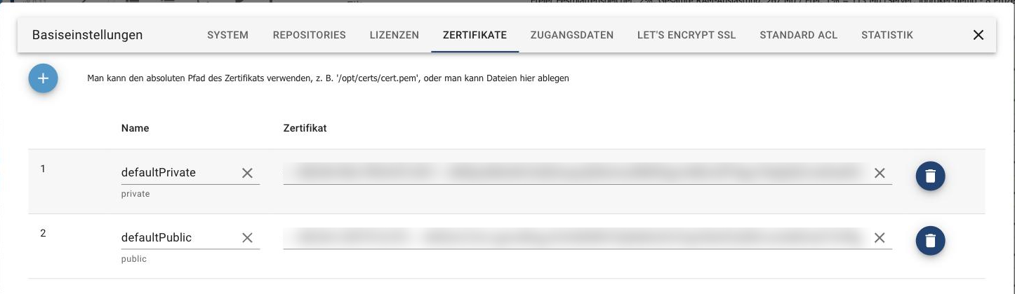

Certificates
The certificates for HTTPS are located here. They are used by admin, web, simple-api and socketio.
Der Reiter Zertifikate
Ex-worksdefaultPrivate anddefaultPublic These default certificates are the same in every installation and therefore insecure : they only allow an encrypted connection without any verification capabilities. For external access, you need your own certificates, either self-generated, purchased, or from Let's Encrypt.
A certificate can be stored as a file or specified as an absolute path, for example/opt/certs/cert.pem .
!> Try new certificates first with the web adapter, not with the admin adapter. Otherwise, you might lock yourself out.
Rights to the certificate files
If a path is specified, the user mustiobroker be allowed to read the file:644 for the file,755 for the parent directories. If the necessary permissions are missing, the log will report something like:
web.0 (24704) Cannot create webserver: Error: error:0909006C:PEM routines:get_name:no start line
This can be checked by the user.iobroker :
su iobroker
ls -l /pfad/zum/zertifikat
At the beginning of the line,-rw-r--r-- stand. Otherwise asroot :
chmod 644 /pfad/zum/zertifikat
chmod 755 /pfad/zum
If the entry points to a symbolic link, the rights of the target apply.

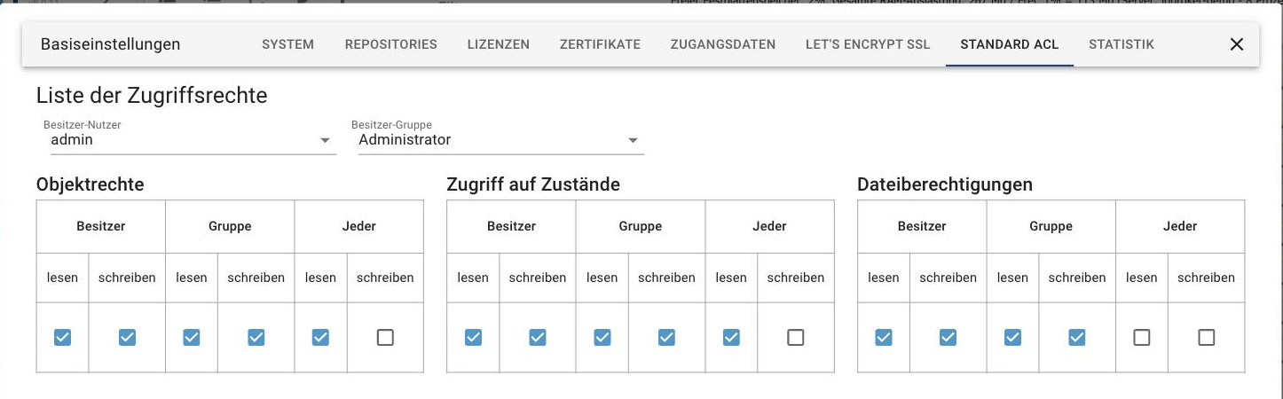

Standard ACL
Specifies which rights newly created objects, states and files receive, separated by owner, group and everyone else.
Der Reiter Standard ACL
This page does not change the permissions of existing objects. Users and groups themselves are managed in the Users tab.

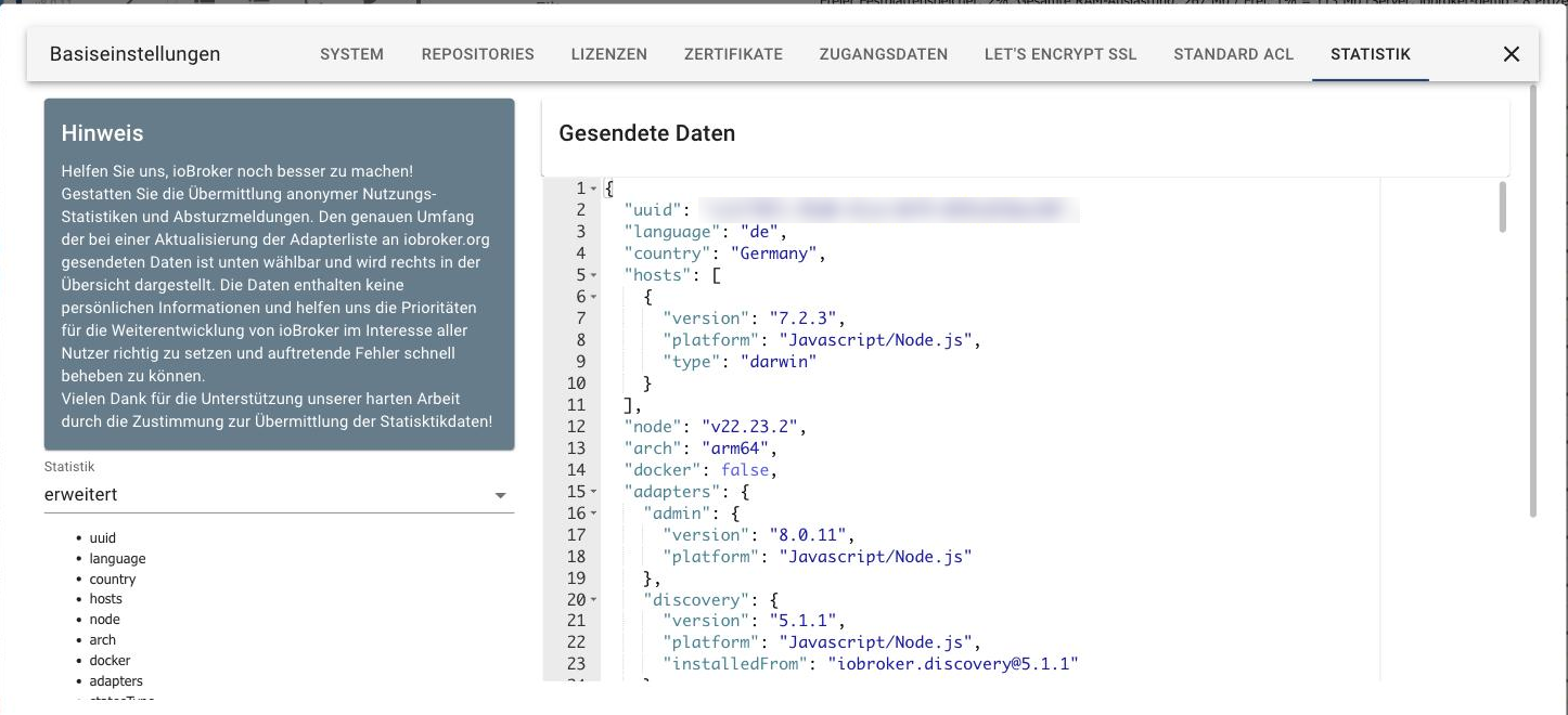

statistics
ioBroker can send anonymous usage statistics to the project.
Der Reiter Statistik mit der Vorschau der gesendeten Daten
On the left, you select the scope of data transfer; on the right, you'll find a clear description of what would actually be transmitted: from the installation ID and node version to the platform and a list of installed adapters. No personal data is included. This analysis helps the project identify which adapters and platforms are actually being used.
