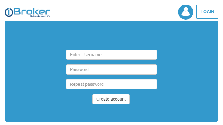

To use the iot adapter, you should first register on the ioBroker cloud https://iobroker.pro.

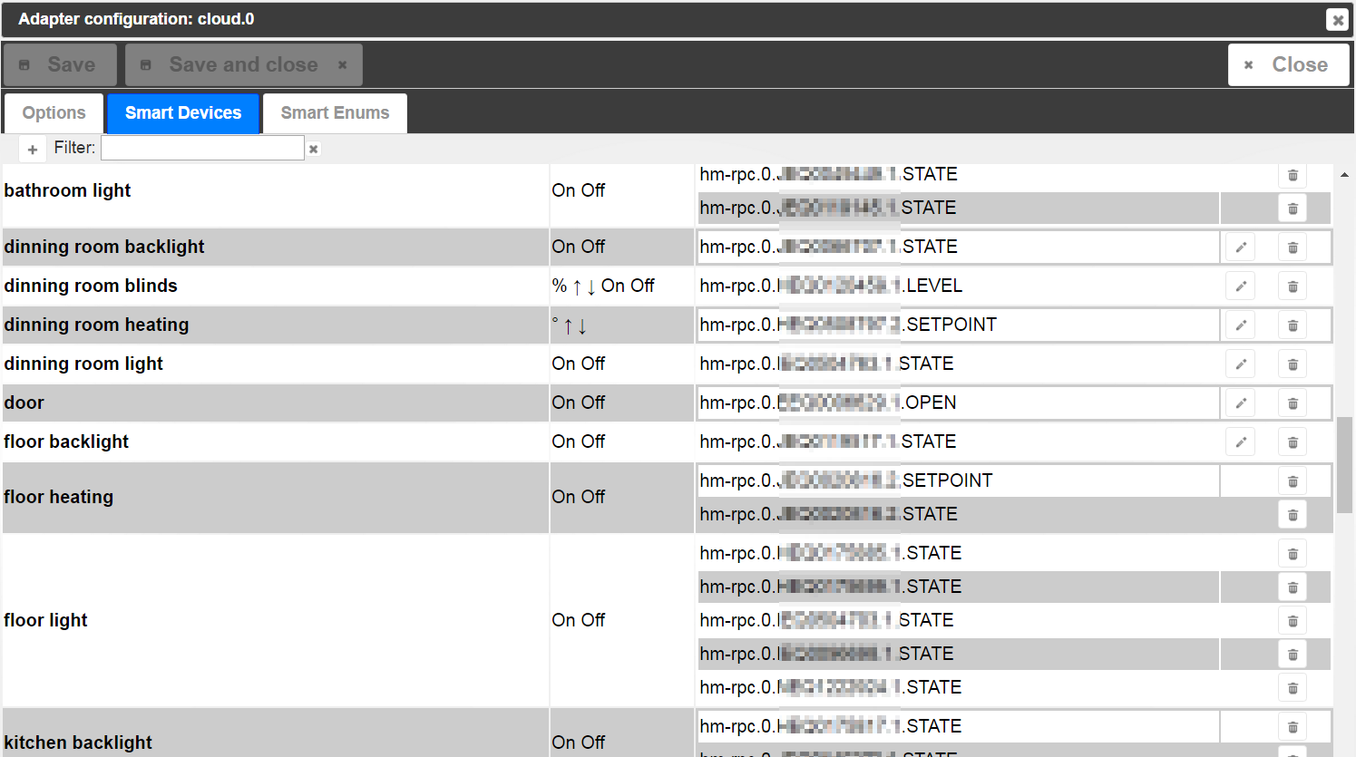

The configuration dialog allows you to manually adjust which states are included and how they are grouped: Configuration
Renaming:
  • Single-state groups: Can be renamed (uses the state's smartName)
  • Multi-state groups: Must be renamed by changing the enumeration names

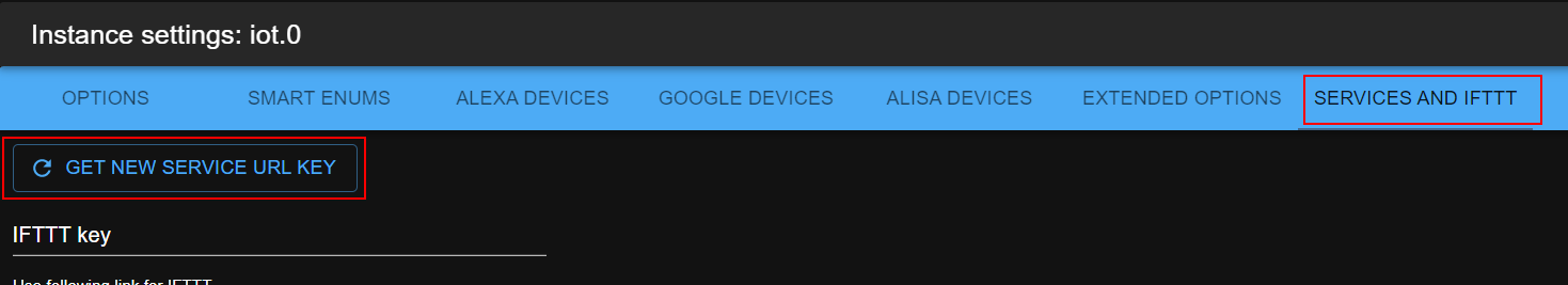

Services
There is a possibility to send messages to cloud adapter. If you call [POST]https://service.iobroker.in/v1/iotService?service=custom_<NAME>&key=<XXX>&user=<USER_EMAIL> und value as payload.
curl --data "myString" https://service.iobroker.in/v1/iotService?service=custom_<NAME>&key=<XXX>&user=<USER_EMAIL>
