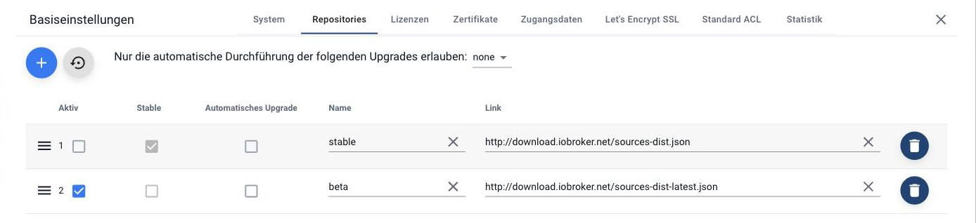

Convert the entire repository
If it is ever necessary: In System settings, in the Repositories tab, switch to beta in the Active column.
The Repositories tab in the basic settings
Then, in the Adapter tab, reload the list. If beta is active, a warning will appear. This is intentional and serves as a reminder to revert back.

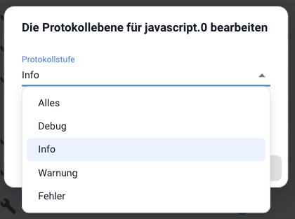

How do I switch an instance to debug mode?
In the Instances tab, expand the details row of the instance and click on the log level. In the dialog box, set it to Debug .
Der Dialog zum Ändern der Protokollebene
The setting is saved permanently. Without the " Without restart" checkbox selected, the instance will restart. This is usually intentional, as only then will it log the complete process from the beginning.
Then trigger the action that caused the error and check the logs .
!> After troubleshooting, reset to Info .
For an error message in the forum or on GitHub, please include an excerpt from the downloaded log file, not a screenshot of the list. Long lines will be truncated in the display.

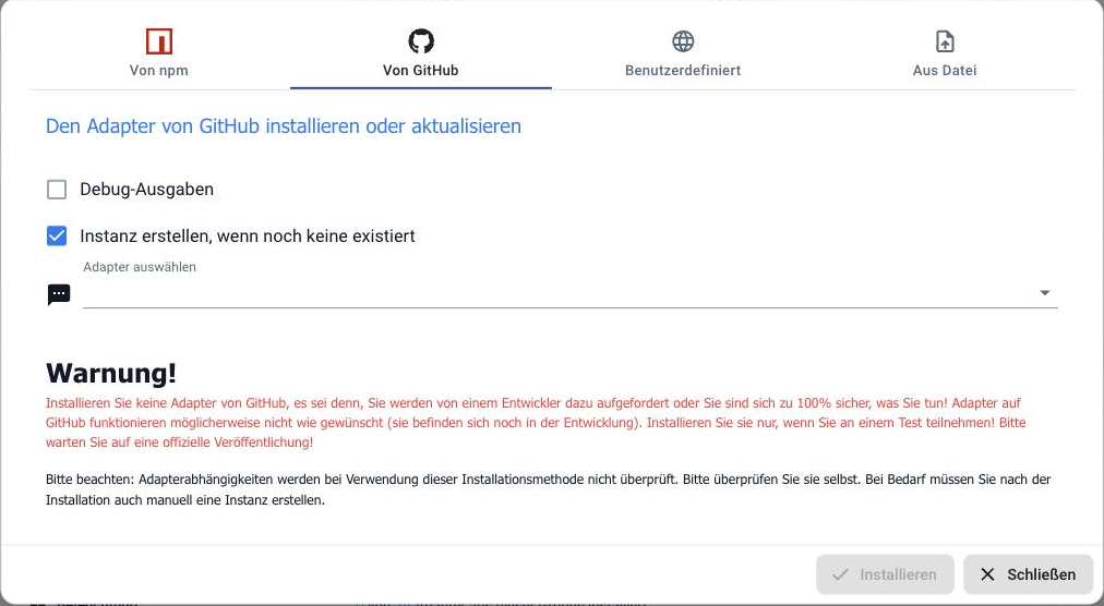

How do I install an adapter from GitHub?
Only if a developer explicitly requests it. Anything on GitHub is a work in progress and may be unusable in the meantime. Dependencies are not checked with this type of installation.
  • Turn on expert mode .
  • In the Adapter tab, select Install from local source .
  • Switch to the From GitHub tab and select the adapter.
Der Dialog Installieren aus eigener Quelle, Reiter Von GitHub
The "Custom" tab accepts any address, such as a specific branch or another developer's repository. "Install from file" installs a locally stored package.
