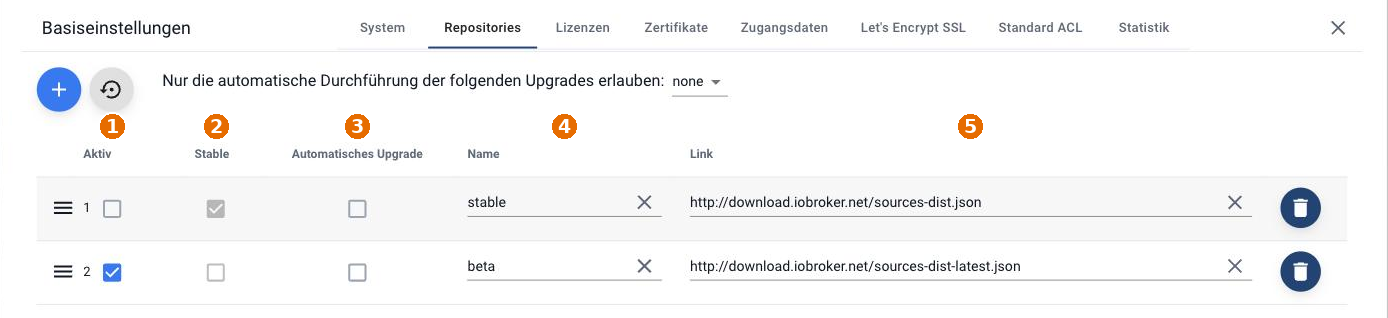

The setting can be found in the system settings under the Repositories tab. It can be accessed via the System menu at the very bottom of the administrator's menu bar.
Der Reiter Repositories in den Basiseinstellungen
No.Split
1Active : here you select which repository is used.
2Stable : is automatically set on the first read if ioBroker recognizes the repository as stable.
3Automatic upgrade : whether adapters from this repository may be updated automatically.
4Name : freely selectable.
5Link : the address of the adapter list.
The "+" button in the upper left creates another repository. The button with the arrow next to it resets the paths for stable and beta to their default settings and also deletes any repositories you added yourself.
The default paths are:
  • stable:http://download.iobroker.net/sources-dist.json
  • beta:http://download.iobroker.net/sources-dist-latest.json

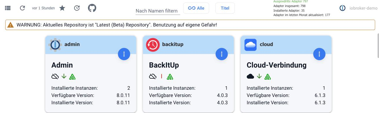

If the beta repository is active, the Adapter tab will display a warning:
Die Warnung im Adapter-Reiter, wenn das Beta-Repository aktiv ist

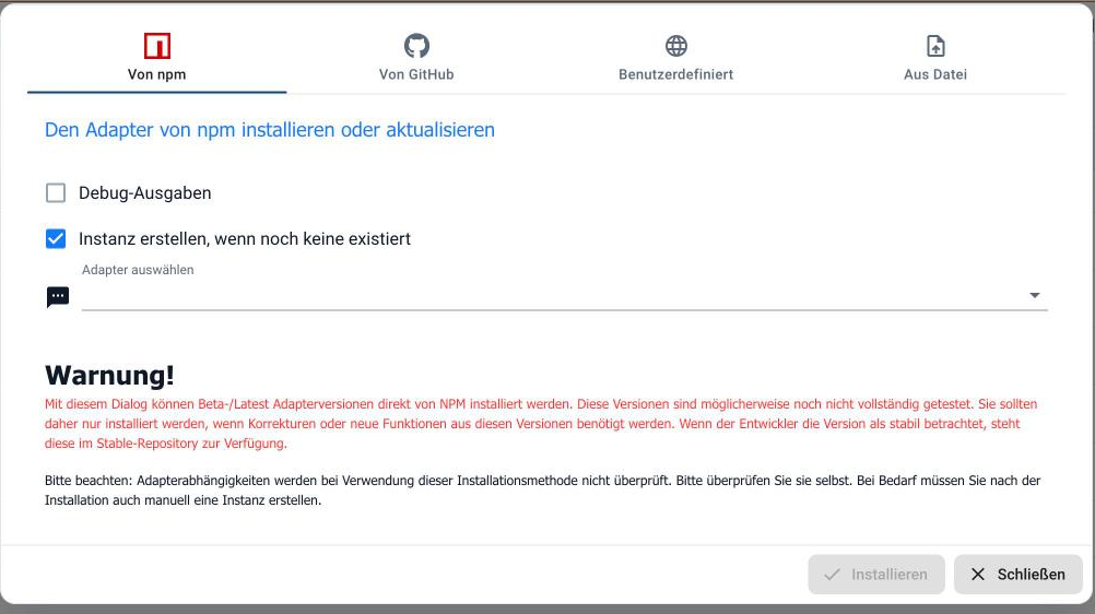

  • Turn on expert mode (the icon in the bottom left of the menu bar).
  • In the Adapters tab, select Install from local source . The icon is the Octocat.
  • In the From npm tab, select the desired adapter.
Der Dialog Installieren aus eigener Quelle, Reiter Von npm
This allows you to install the latest version of a single adapter without having to change the repository. All other adapters continue to come from the stable repository.
Dependencies are not checked using this method. An adapter should only be installed directly from GitHub if the developer explicitly requests it, for example, for testing or debugging. Such versions are in the middle of development and may not even work in the meantime.
