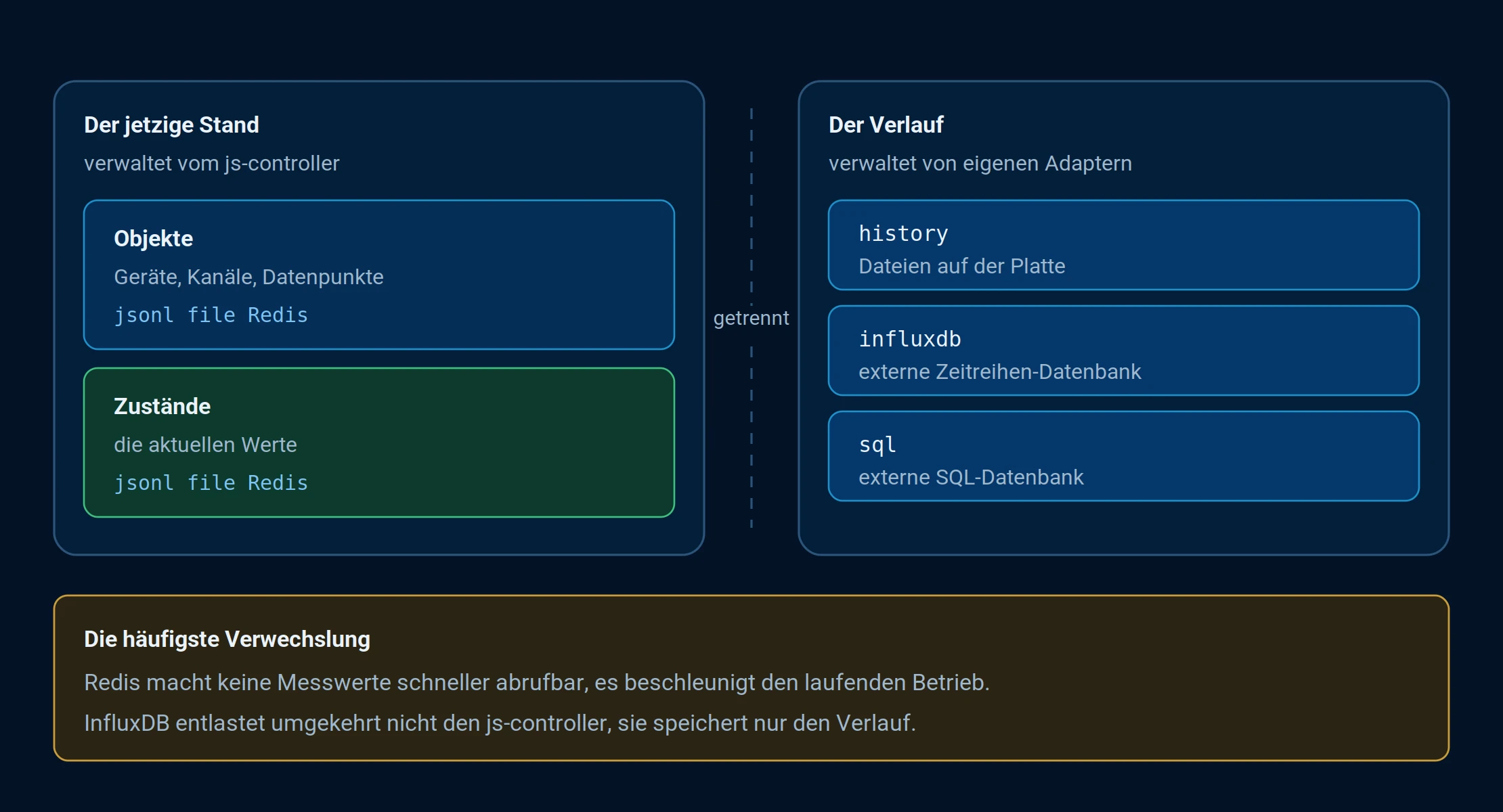

Which databases are meant here?
ioBroker maintains two databases: one for objects , i.e., the description of all devices, channels, and data points, and one for states , i.e., their current values. Both are managed by the js-controller, and both only ever retain the current state.
!> This has nothing to do with the adapters that record the history .history ,influxdb andsql They store their data separately and handle it under data logging . Setting up Redis doesn't make your measurements faster to retrieve, and setting up InfluxDB doesn't reduce the load on the JS controller. This confusion is the most common misconception here.
Objects and statesRecorded values
ContainThe current state of the systemThe course over time
Managed byjs-controllerhistory ,influxdb orsql
Filingjsonl ,file or Redisfiles or an external database
Read more atobjectsData recording
This page is about the first column, more specifically the possibility of keeping it in Redis instead of in files.
The two databases are configured separately . The usual approach is to only store the states in Redis and the objects injsonl to allow it. This brings the greatest benefit, because states change constantly and objects almost never, and it uses the least amount of memory.iobroker status shows what is currently in use.
Der jetzige Stand im js-controller gegenüber dem Verlauf in history, influxdb und sql
Two separate worlds: on the left, the current state maintained by the js-controller; on the right, the progress recorded by custom adapters.
