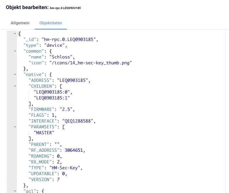

The structure of an object
Each object has four fields:
| Field | What it contains |
_id | the address from above |
type | what type of object it is (see below) |
common | ioBroker's view: Name, type, unit, role, read and write permissions |
native | The target system's perspective: everything that only the connected device or service understands. |
The image shows a Homematic door lock.common It states what ioBroker needs to know about it – the name and a symbol.native The device's world is defined: address, firmware, radio address, device type. ioBroker doesn't read any of this; the adapter needs all of it.
The separation ofcommon andnative This is the reason why a widget in the visualization can handle a Homematic data point just as well as a Zigbee data point: What ioBroker needs is always located in the same place incommon As far as the device itself is concerned, it remains innative and doesn't bother anyone.
