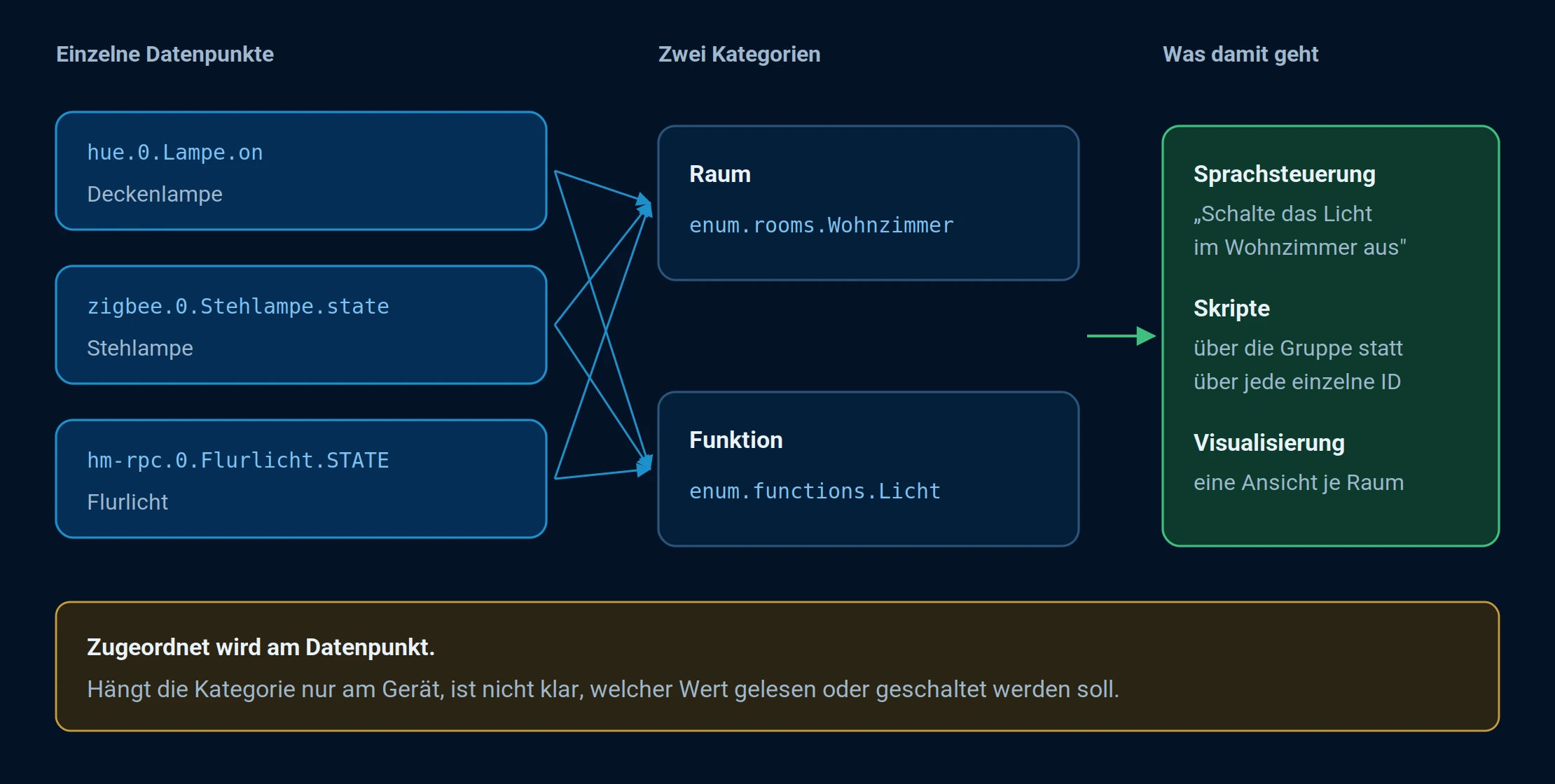

Each data point is associated with a room and a function. Only together do the two make "light in the living room" a definite selection.

Rooms and functions are predefined because many adapters evaluate them. Custom categories can be freely named and are intended for anything that cannot be described as either a room or a function.
Devices, channels, and data points can be assigned. For voice control and most evaluation adapters, the assignment must be linked to the data point . Otherwise, it's unclear which value should be read or switched.

Create and assign categories
Three paths lead to the same result:
  1. In the Categories tab, create a category and select the members.
  2. In the Objects tab, assign the Rooms and Functions columns directly to the data point.
  3. Via script, if many assignments need to be created at once.

When a device is added, simply assigning it to the category is sufficient. No changes need to be made to the script.
Use in visualization
Adapters like the Devices adapter or Lovelace readenum.rooms andenum.functions They extract the data and build their views from it. Spaces become pages, functions become groups within them. A newly assigned data point then automatically appears in the correct position.
Use in voice control
Alexa and Google Home receive location and function information via cloud adapters. Only then can commands like "Turn on the living room light" understand which data points are being referred to. Without this information, only the individual device name remains.
