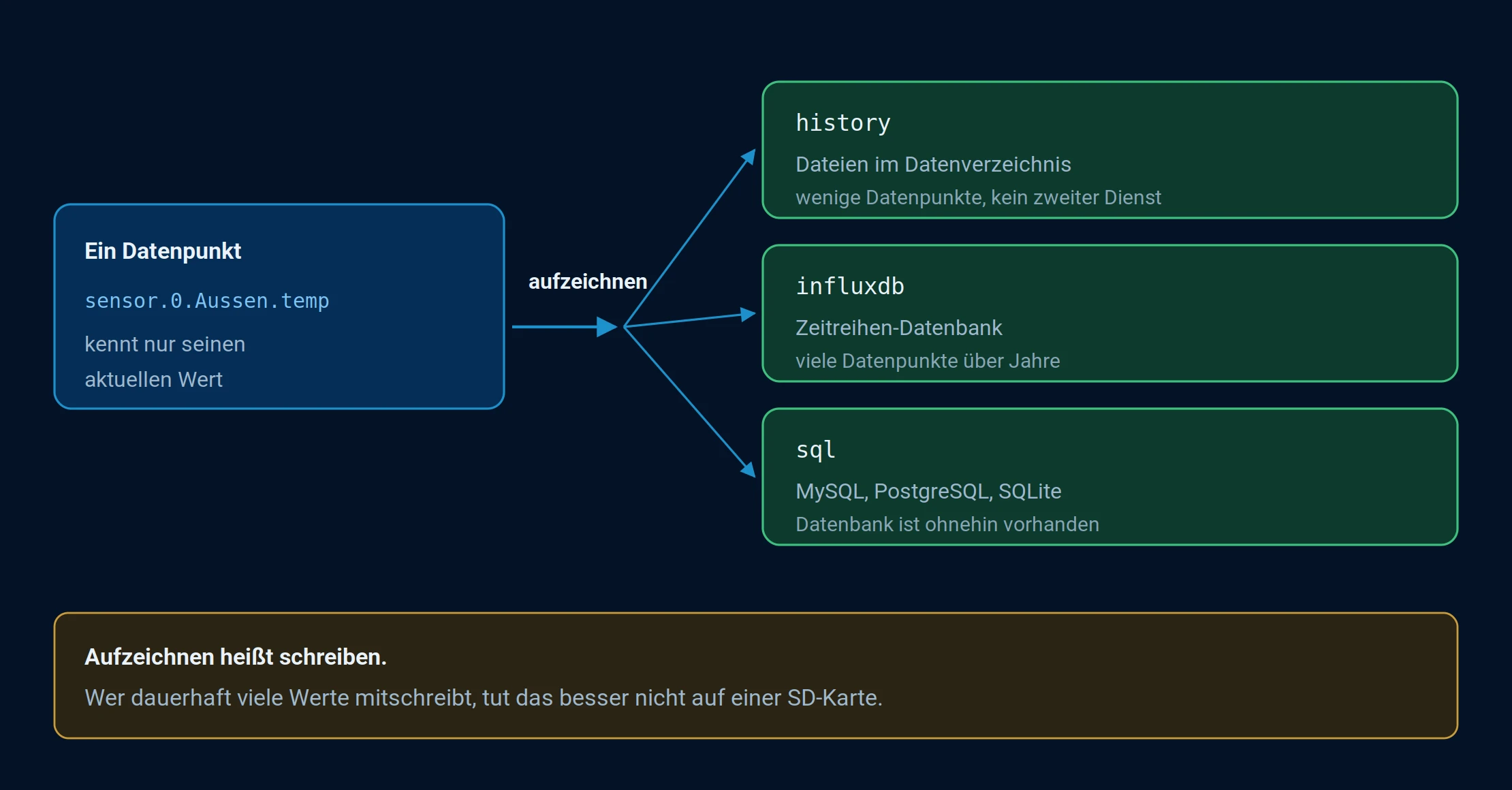

Ein Datenpunkt und die drei Adapter, die seinen Verlauf mitschreiben
A data point only knows its current value. Anyone needing the historical data can activate recording and choose where it should be recorded.

Which adapter
adapterPut it downIt fits if
historyFiles in the ioBroker data directoryFew data points, manageable time periods, no additional service desired
influxdbInfluxDB, a time series databaseMany data points over years. The usual approach for established systems.
sqlMySQL, PostgreSQL, MS-SQL or SQLiteSuch a database already exists, or the data is intended to be read by other programs.
The history function stores data in two stages: the values are first stored in RAM and only written to files when a predefined threshold is reached. This protects the card, but also means that the most recently collected values are lost in the event of a hard power outage.
The files are located in a folder below/opt/iobroker/iobroker-data , without providing their own information inhistory , and within that, one subfolder for each day. An absolute path like/mnt/history This is also possible, for example, on an attached storage device. The location of the data is important for backup purposes; see below.
For starters, history . It doesn't need a second service, and switching to InfluxDB is possible later, see below.
Recording means writing, and writing uses up an SD card. Anyone who regularly records large amounts of data should not do so on an SD card, but rather on an SSD or in a database on another computer.
