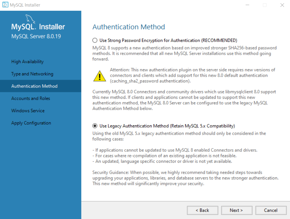

On the "windows" it can be easily installed via installer: https://dev.mysql.com/downloads/installer/.
Pay attention to the authentication method. The new encryption algorithm in MySQL 8.0 is not yet supported by node.js and you must select legacy authentication method.
Windows
