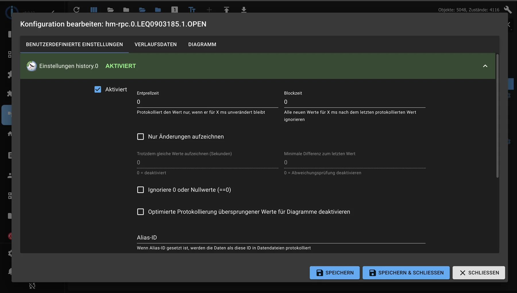

  3. At the end of the line, the gear icon opens the settings for this data point. There, enable the history instance.
Recording begins now. There is no retrospective recording: recording only starts from the moment the device is switched on.
Der Dialog hinter dem Zahnrad eines Datenpunkts mit den Einstellungen für history.0
Behind the gear icon of an object row: here, for each data point, it is switched on what is recorded and how exactly.
The settings that matter
AttitudeWhat it does
In case of change or within the interval"On change" is almost always correct. An interval also generates data even if nothing happens.
Minimum changeOnly when this deviation is reached does the data start being recorded. This eliminates the noise from the sensor.
Debounce timeLocks shortly after a write operation. Helps with values that fluctuate every second.
storageHow long the values will be retained. Without a limit, the storage capacity grows indefinitely.
