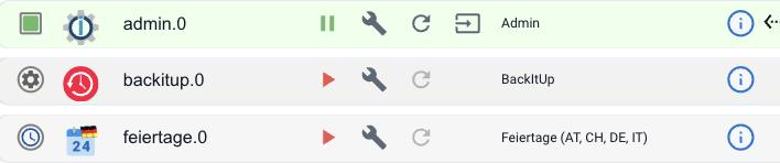

What do the symbols in front of an institution mean?
Drei Instanzzeilen mit unterschiedlichem Zustand
symbolMeaning
Green SquareThe instance is running.
Grey gearThe instance is stopped. The red triangle next to it starts it.
ClockA time-controlled instance. It only runs briefly at the set time and then terminates. This is not a bug.
More details can be found by hovering the mouse cursor over the icon. Whether the instance is actually communicating with your device is not indicated here, but rather in its object.info.connection .

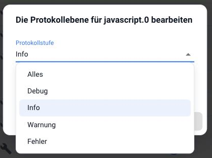

How do I change the log level?
In the Instances tab, expand the details row of the instance and click on the log level:
Der Dialog zum Ändern der Protokollebene
The available options, from most detailed to most concise, are: All , Debug , Info , Warning , Error . Info is the default.
To troubleshoot, enable debug mode , restart the instance, and review the logs again.
Then switch back. Debug mode grows the log quickly and consumes write accesses. This is not a good idea on an SD card.
