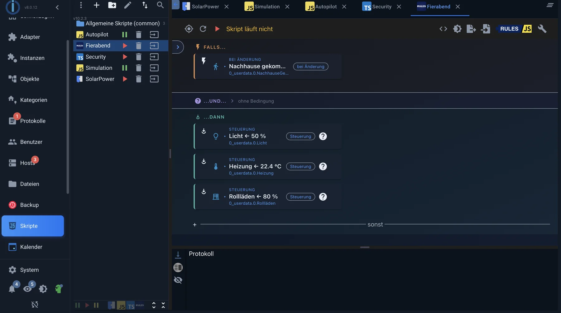

A rule in the editor: at the top the trigger, below that the condition, below that the actions. Nothing is assembled, but rather selected.

Rules offer the quickest entry point when automation truly follows the pattern of " if this condition, then that action ." Nothing is assembled; instead, elements are selected. Since version 10.1.0 of the JavaScript adapter, a wizard guides the user step-by-step through triggers, conditions, and actions, ultimately displaying the completed rule. It opens automatically once for newly created rules; after that, it remains available in the rule block bar.
