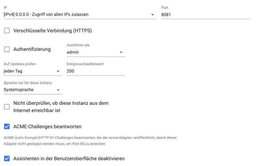

In the Instances tab, the wrench icon opens.admin.0 the configuration:
Die allgemeinen Einstellungen der Admin-Instanz
Two fields are important:
FieldMeaning
authenticationEnable the login screen. Without this option, anyone can log in without a password.
Run asDetermines whose rights are used until the user logs in. The default setting is...admin , i.e., full access.
Proceed:
  1. In the Users tab, the useradmin Enter a password. Do not enable authentication beforehand , otherwise there will be nothing to log in with.
  2. Write down the password before proceeding.
  3. In the settings ofadmin.0 Check the box for authentication and save. The instance will restart.
  4. Reload the page. The login form will now appear.
If you lock yourself out, the command line can help.iobroker set admin.0 --auth false The same command also works.--secure for HTTPS and--ttl The validity period of a login is measured in seconds. All commands are available via the CLI .
The other fields on this page do not relate to the login: IP and port determine what the admin is listening on, encrypted connection (HTTPS) is part of the encryption , and answering ACME challenges is required.acme -Adapter to obtain a Let's Encrypt certificate without having to stop the admin.

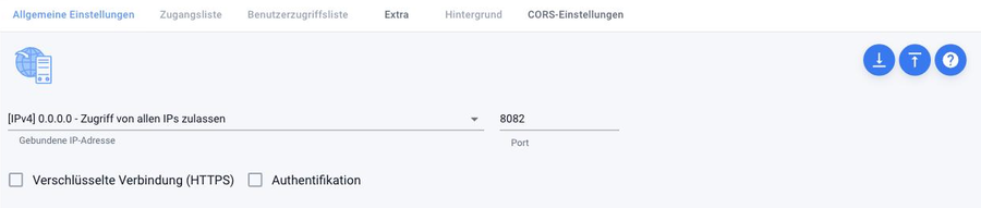

Atweb.0 The switch is called Authentication and is located directly next to the encryption:
Die allgemeinen Einstellungen der web-Instanz
As long as it is disabled, the two tabs "Access List" and "User Access List" are grayed out. With login enabled, they become usable and allow you to further restrict access to individual pages and per user.
Those who only need access for vis should disable login at theweb -Instance under which vis runs. vis itself does not have its own web server.
