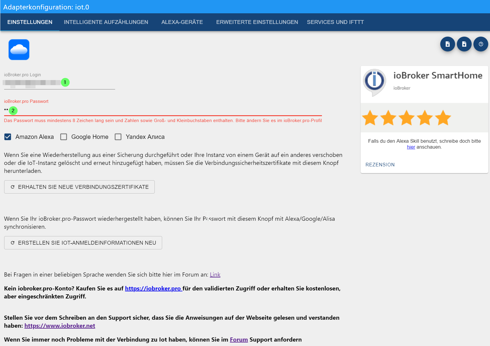

  1. Next, install the ioBroker.IoT adapter from the normal repository - simply filter for "IoT".

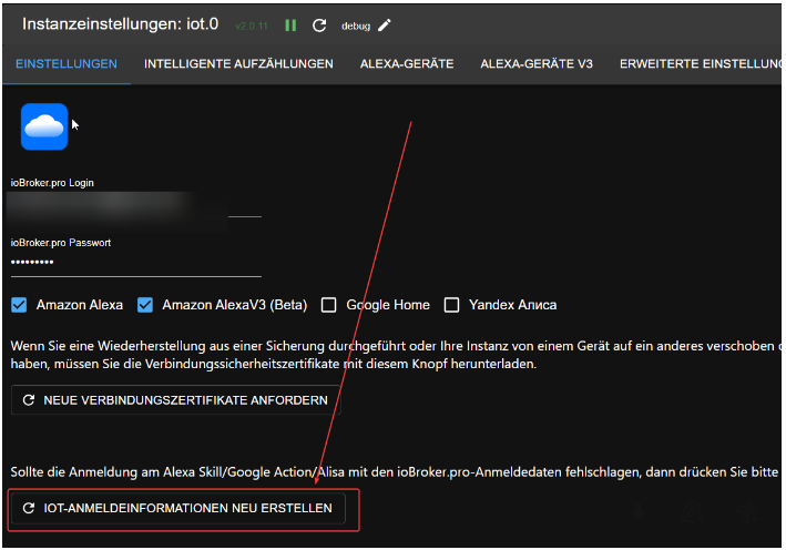

In the adapter configuration, please enter the login credentials from https://iobroker.pro (email address in lowercase and password! Not an app key or anything similar!).
The buttons "Get new connection certificates" or "Recreate IoT credentials" are only needed in case of errors.
If the IoT adapter is already installed, please check if updates are available and update to at least version 0.2.2.

Most of the time, it's something simple like incorrect login credentials (Note: Pay attention to upper and lower case!). The error messages in the log have been improved and should now better indicate the problem.

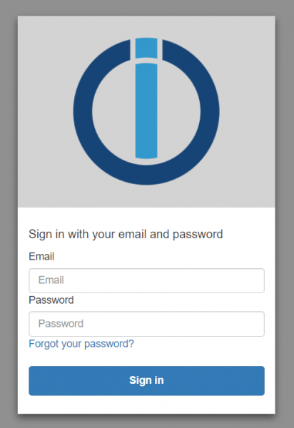

  1. Then install the new "ioBroker.assistant" Skill and click on "Activate".
The login screen for the IoT service should then appear.
Use the email address and password for your ProCloud account here.
Please write the login in lowercase: MyEmail@gmx.de is incorrect; myemail@gmx.de is correct!
Those already using the IoT services (previously or with the custom skill) can simply log in directly with their IoT access data when activating the skill.
Login
After a successful login, a success message will appear and the skill will be activated.
If not, please check your login details and try again.

  • If none of that helps, please press this button:
    Recreate
  • The following ports for communication (output) are not blocked in the firewall: 443, 8443 and 8883.
After that, ioBroker.iot should restart itself, and then try activating the ioBroker.iot skill again.
