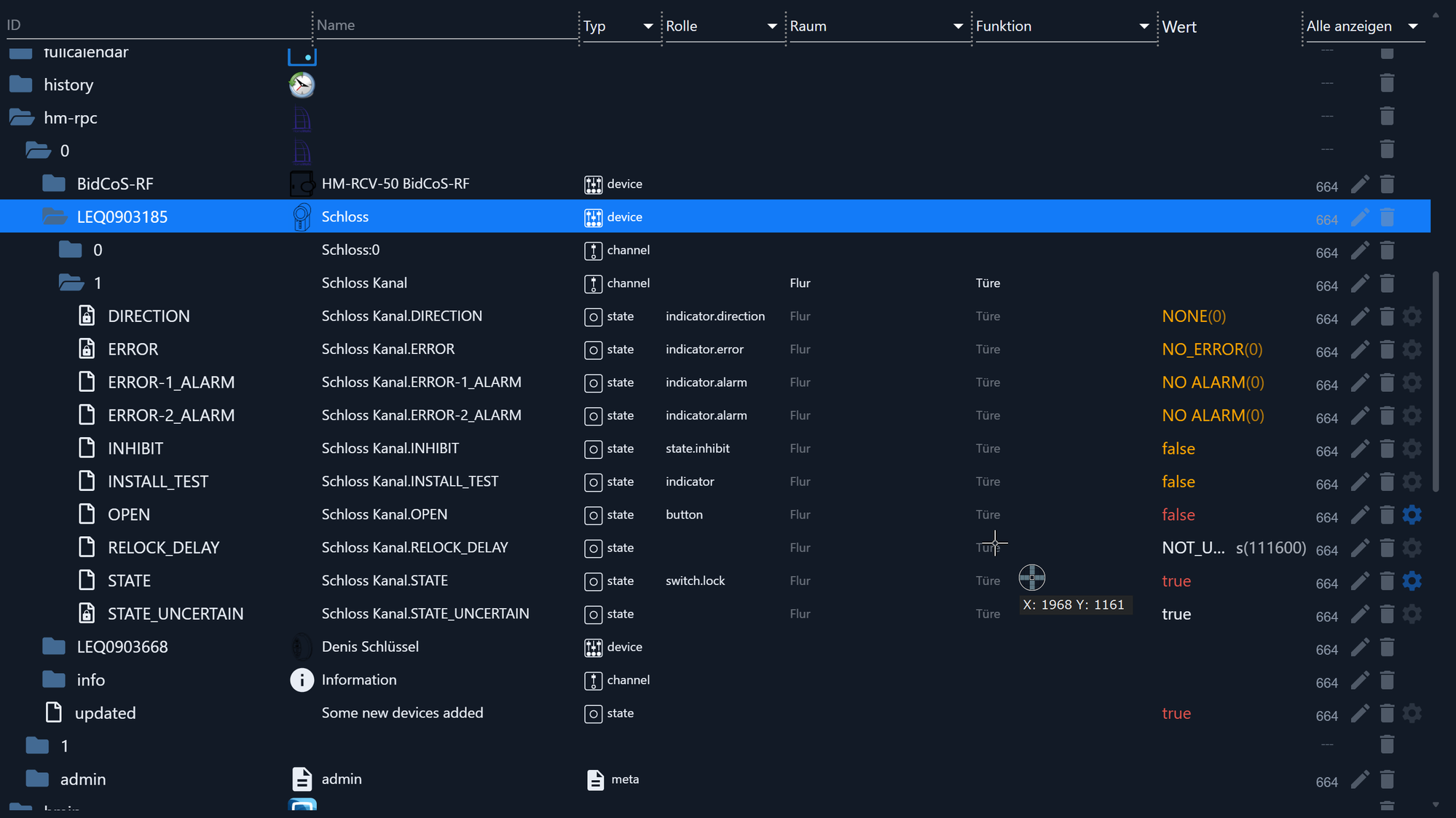

ioBroker manages the data in a database. The data structure is organized accordingly.
Each adapter has a so-called namespace that contains all the data for an instance of the adapter. Accordingly, the namespace might be, for example, AdapterName.0.
Within this area, ioBroker creates the devices, their channels, and in turn their data points with their values (states).
Der Objektbaum: Adapter, Instanz, Geraet, Kanal, Datenpunkte
In the example, the namespace belongshm-rpc.0 to the first instance of the HomeMatic adapter. The device is located below it.LEQ0903185 (a door lock), including its channels and within them the individual data points with their current values. More information can be found under Objects and States .
