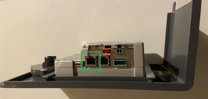

There are two RJ45 ports on the bottom side of the touch panel. They can be accessed by removing the front cover of the heat pump using the provided tool. Looking upwards from below connect the ethernet cable to the right port.
View from belowö
Check your router to find out the IP address of the heat pump and enable static IP address so that the heat pump address will not change.
