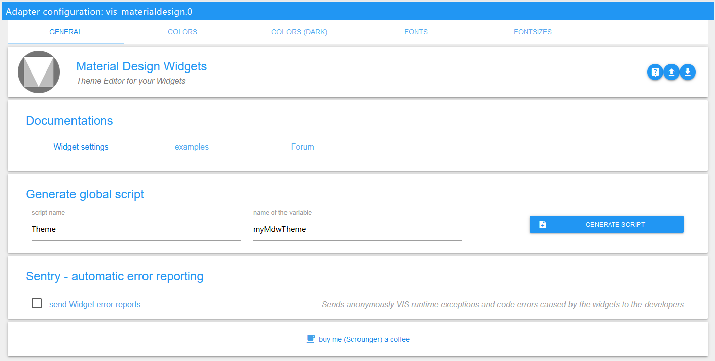

Adapter settings
Starting with version 0.4.0 there is a settings page for the adapter. You can find it under Instances in the user interface of the admin adapter
General
settingdescription
DocumentationLinks to documentation to help you configure the widgets
Generate global scriptCreate a global script for the Javascript Script Engine with all theme data points. This allows to use colors, fonts and font sizes comfortably in scripts.
Sentryuse Sentry libraries to automatically report exceptions and code errors anonymously to the developers. For more details and for information how to disable the error reporting see Sentry-Plugin Documentation!

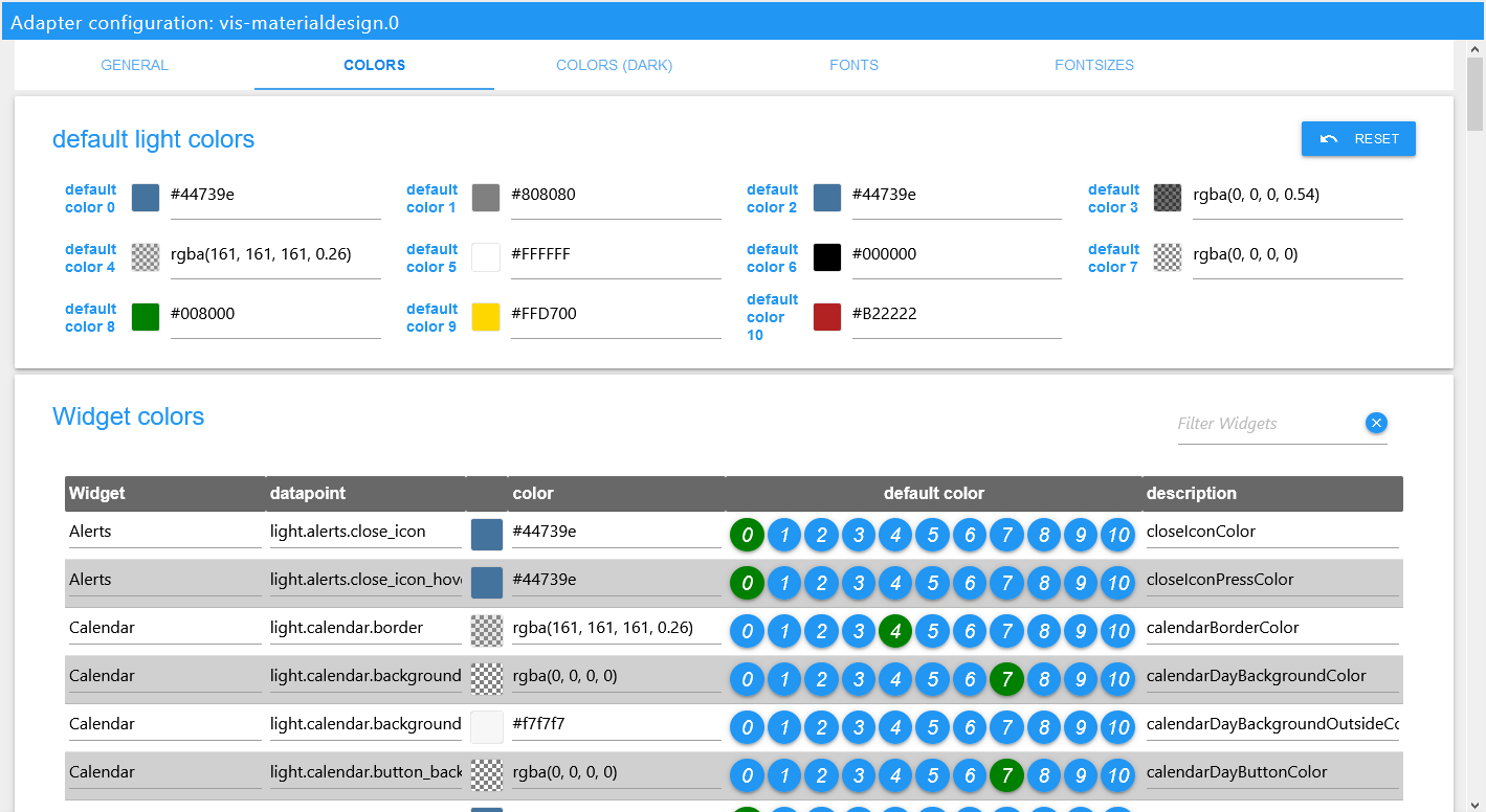

Theme Editor
With the help of the Theme Editor you can centrally set colors, fonts and font sizes for all widgets via the adapter settings. For each widget datapoints (see screenshot below) are created with the set values. This makes it also possible to use these settings in other widgets (not Material Design Widgets) via bindings.
Datapoint structure
Theme Settings
Every settings page for colors, colors dark, font and font sizes look likes show in the screenshot above.
Standard colors / fonts /font sizes can be defined in the upper area. These standard colors / fonts /font sizes can then be assigned to the individual widgets using the buttons in the table. If you change the default colors / fonts /font sizes, it will also change for all widgets that use this colors / fonts /font sizes. Additionally, it is possible to assign your own colors / fonts /font sizes to the widgets, independent of the standard colors.
For colors there are two themes - light theme and dark theme. With the datapoint vis-materialdesign.0.colors.darkTheme you can switch between the two themes. For example this datapoint can be used in a script to switch between lights and dark colors on sunrise and sunset.

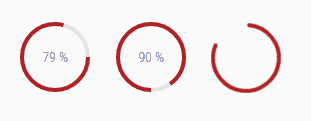

Progress Circular
Editor Settings
Settings that are not listed in the table below are self-explanatory.
Screenshot Setting Description
condition for color 1 progress [>] Condition from when color 1 should be used. The value of the condition must be in percent
condition for color 2 progress [>] Condition from when color 2 should be used. The value of the condition must be in percent
custom label For custom label you can use the property [#value] to show the real value of the datapoint. To show the current percent you can use [#percent]
HTML Properties
The following properties can be used as HTML Widgets.
Property Description Type Values
mdw-type Widget type string linear
Common
mdw-oid Object ID string
mdw-min min string
mdw-max max string
mdw-reverse Revers value boolean false | true
mdw-invertValue invert value boolean false | true
mdw-debug debug boolean false | true
layout
mdw-progressRounded rounded corners boolean false | true
mdw-progressIndeterminate indeterminate - continuously animates boolean false | true
mdw-progressRotate rotate 90 degress string noRotate | yesRotate
group_layoutStriped
mdw-progressStriped striped boolean false | true
mdw-progressStripedColor progressStripedColor string hex(#44739e), rgb(20, 50, 200), rgba(20, 50, 200, 0.5)
mdw-stripAngle stripAngle number
colors
mdw-colorProgressBackground background color string hex(#44739e), rgb(20, 50, 200), rgba(20, 50, 200, 0.5)
mdw-colorProgress color progress string hex(#44739e), rgb(20, 50, 200), rgba(20, 50, 200, 0.5)
mdw-colorOneCondition condition for color 1 progress [>] number
mdw-colorOne color 1 progress string hex(#44739e), rgb(20, 50, 200), rgba(20, 50, 200, 0.5)
mdw-colorTwoCondition condition for color 2 progress [>] number
mdw-colorTwo color 2 progress string hex(#44739e), rgb(20, 50, 200), rgba(20, 50, 200, 0.5)
labeling
mdw-showValueLabel show value boolean false | true
mdw-valueLabelStyle value caption style string progressPercent | progressValue | progressCustom
mdw-valueLabelUnit unit string
mdw-valueMaxDecimals decimal points number
mdw-valueLabelCustom custom label string
mdw-textColor Minutes text color string hex(#44739e), rgb(20, 50, 200), rgba(20, 50, 200, 0.5)
mdw-textFontSize text size number
mdw-textFontFamily font string
mdw-textAlign textAlign string start | center | end
HTML Properties - Example
<div class='vis-widget materialdesign-widget materialdesign-progress materialdesign-progress-html-element'
	style='width: 100%; height: 100%; position: relative; padding: 0px;'
	mdw-type='circular'
	mdw-oid='0_userdata.0.MDW.Progress.val1'
	mdw-colorProgressBackground='#mdwTheme:vis-materialdesign.0.colors.progress.track_background'
	mdw-colorProgress='#mdwTheme:vis-materialdesign.0.colors.progress.track'
	mdw-innerColor='#mdwTheme:vis-materialdesign.0.colors.progress.circular_background'
	mdw-colorOneCondition='50'
	mdw-colorOne='#mdwTheme:vis-materialdesign.0.colors.progress.track_condition1'
	mdw-colorTwoCondition='70'
	mdw-colorTwo='#mdwTheme:vis-materialdesign.0.colors.progress.track_condition2'
	mdw-showValueLabel='true'
	mdw-valueLabelStyle='progressPercent'
	mdw-textColor='#mdwTheme:vis-materialdesign.0.colors.progress.text'
	mdw-textFontSize='#mdwTheme:vis-materialdesign.0.fontSizes.progress.text'
	mdw-textFontFamily='#mdwTheme:vis-materialdesign.0.fonts.progress.text'
></div>

mdw-colorAfterThumb color after regulator string hex(#44739e), rgb(20, 50, 200), rgba(20, 50, 200, 0.5)
mdw-valueLabelColor text color of value string hex(#44739e), rgb(20, 50, 200), rgba(20, 50, 200, 0.5)
labeling
mdw-valueLabelVerticalPosition vertical text position of value number
mdw-valueLabelStyle value caption style string sliderPercent | sliderValue
mdw-valueFontFamily valueFontFamily string
mdw-valueFontSize value font size number
mdw-valueLabelMin text for value less than min string
mdw-valueLabelMax text for value greater than min string
mdw-valueLessThan 'smaller than' condition for the text of the value number
mdw-textForValueLessThan text for 'smaller than' string
mdw-valueGreaterThan 'greater than' condition for the text of the value number
mdw-textForValueGreaterThan text for 'greater than' string
<div class="vis-widget materialdesign-widget materialdesign-slider-round materialdesign-roundslider-html-element"
	style="width: 100px; height: 100px; position: relative;"
	mdw-debug="false"
	mdw-oid='0_userdata.0.MDW.Slider.val0'
	mdw-oid-working='0_userdata.0.MDW.Slider.working'
	mdw-step='1'
	mdw-startAngle='135'
	mdw-arcLength='270'
	mdw-handleZoom='1.5'
	mdw-vibrateOnMobilDevices='50'
	mdw-colorSliderBg='#mdwTheme:vis-materialdesign.0.colors.slider.background'
	mdw-colorBeforeThumb='#mdwTheme:vis-materialdesign.0.colors.slider.control_before'
	mdw-colorThumb='#mdwTheme:vis-materialdesign.0.colors.slider.control'
	mdw-colorAfterThumb='#mdwTheme:vis-materialdesign.0.colors.slider.control_behind'
	mdw-valueLabelColor='#mdwTheme:vis-materialdesign.0.colors.slider.text'
	mdw-valueLabelStyle='sliderValue'
	mdw-valueFontFamily='#mdwTheme:vis-materialdesign.0.fonts.slider.value'
	mdw-valueFontSize='#mdwTheme:vis-materialdesign.0.fontSizes.slider.value'
></div>

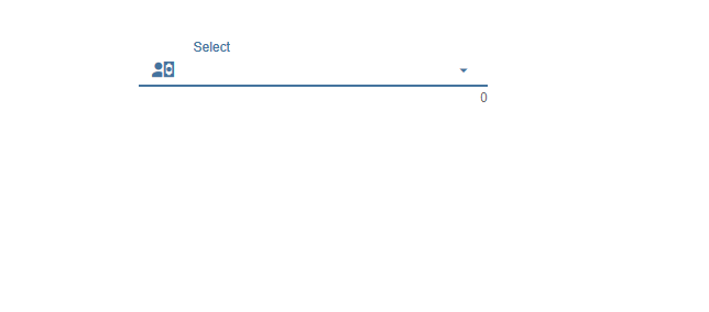

Select

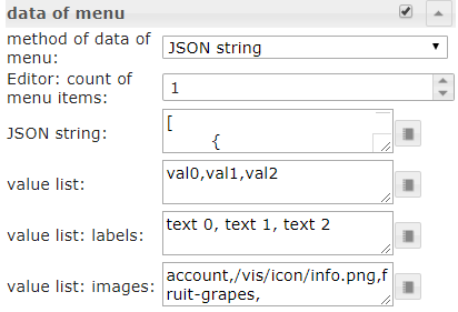

method of data of menu There are three methods to define the data of the menu. First is to define it via editor. Second is to define it via a json string. Third method is to define it by three list for values, labels and icons
Editor: count of menu items Method of data of menu: via editor
Define the number of menu entries. The the individual menu entries can be defined under menu item[x]
JSON string Here you can add a JSON string to define the menu entries or use bindings to a datapoint that contains a JSON string.
JSON string must have the above descibed format
value list Define the number of menu entries by adding values that will be set to the datapoint. Entries must be separeted by semicolon
value list: labels Define the related labels of the values. Entries must be separeted by semicolon
value list: images Define the related icons of the values. Entries must be separeted by semicolon. You can use image path or Material Design Icons name

Autocomplete

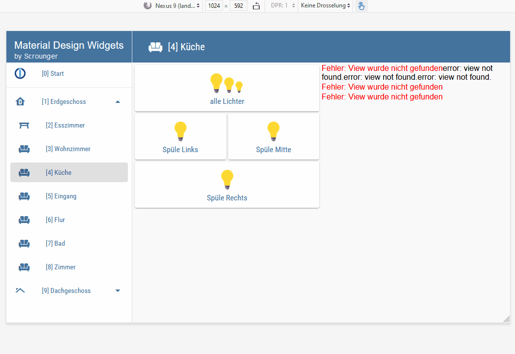

Top App Bar
Top App Bar with Navigation Drawer can be combined with the view in widget 8.
Take a look at the Material Design Widgets example project to understand how it works.
Layout modal:
Layout permanent:
Layout auto:
Layout 'auto' switch automatically between layout 'modal' and 'permanent' depending on screen resolution. Via VIS-Editor you can set the resolution from which the 'permanent' layout should be used (bigger than condition).

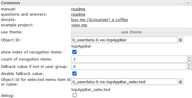

Editor Settings
Object ID must be set to a datapoint from typ number. For example this datapoint can be used by view in widget 8
show index of navigation items shows the index of navigation before the item label. This number can be used in view in widget 8 to define the view that should be shown if the item is selected
count of navigation items Define the count of the navigations items
fallback value if not in user group if you use the group permissions, you can define here the value to switch to if the user is not in the group
disable fallback value disable fallback value
Object Id for selected menu item id or name You can optionally specify a datapoint in which the name or the menu id of the selected navigation element is written.
If no menu id is specified, the text of the navigation element is used. If the selected navigation element is a submenu, the name or menu id of the corresponding navigation element and submenu element is written separated with a '.', e.g. EG.Wohnzimmer
For example, this can be used to dynamically create widgets depending on the selected navigation element.
input method for the navigation items Choose if the navigation elements are created by VIS editor or by json string.
JSON String for navigation items details see Menu JSON Properties and Submenu JSON Properties

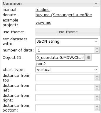

Editor Settings
set datasets with The data for the BarChart can be entered via the editor or a JSON string can be used
number of items number of bars using vis editor for the data of list
Object Id object id of datapoint containing json string. Allowed properties are described below
Object ID[x] object id for the single bars using vis editor

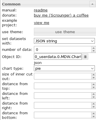

Pie Chart
Editor Settings
set datasets with The data for the PieChart can be entered via the editor or a JSON string can be used
number of items number of pies pieces using vis editor for the data of list
Object ID[x] object id for the single pies pieces using vis editor
Dataset JSON Properties
JSON string must be an array of objects with the following properties:
label axis label of pie string
value pie value number
dataColor pie color hex(#44739e), rgb(20, 50, 200), rgba(20, 50, 200, 0.5)
valueText override text of pie string
valueColor color of value text hex(#44739e), rgb(20, 50, 200), rgba(20, 50, 200, 0.5)
valueAppendix appendix of value text string
tooltipTitle tooltip title string
tooltipText tooltip text string

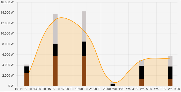

JSON Chart
With the JSON chart you have the maximum freedom to create a mixed chart (line, bars and stacked bars) by script.

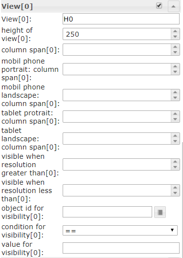

Grid Views
Grid Views has multiple view in widget integrated, that will be ordered automatically depending of the width of the widget. With this widget it is possible to create a responsive layout (one layout for desktop, tablet and mobil). Grid views are especially useful if the views included have the same heights.
The Grid View widget has 12 columns in total. If you want a view to have a width of 4 columns, you have to set column span to 4 in the corresponding view[x]
Editor Settings
Depending on the width of the widget, defined from which width of the widget the rules for column span of the individual views[x] can be applied and the distance between the views. The settings can be set independently for portrait and landscape format. To find out the width of the resolution for the different devices, activate the Resolution Assistant under the common settings.
Define the column span of the view depending of the current width resolution rule.
You can also specify here whether a view should only be displayed at a resolution higher or lower than a defined value or whether it should be visible via a object id.
height of view[x] Here you can specify the height of the view used.
If you want the height to adjust variably to the view, then this input must be empty and for the widget with the highest height in the view the position must be set to relative, see screenshot:

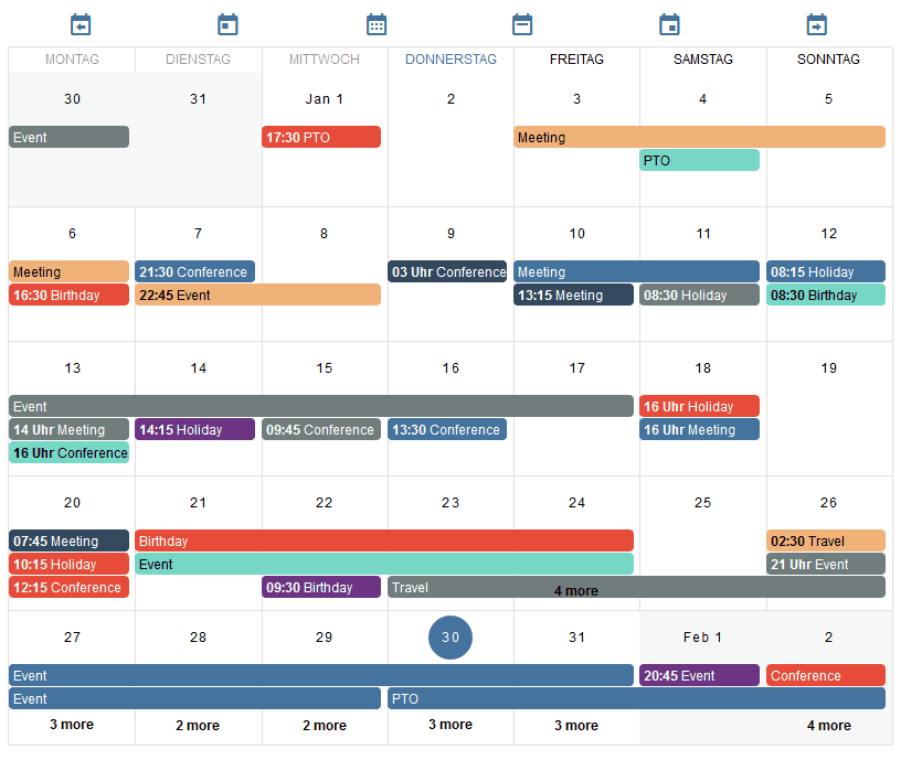

Calendar
Editor Settings
Object Id id of datapoint. Datapoint must contains a json string. Allowed json properties are desribed below
days of the week to be shown Specifies which days of the week to display. To display Monday through Friday only, a value of 1, 2, 3, 4, 5 can be used. To display a week starting on Monday a value of 1, 2, 3, 4, 5, 6, 0 can be used.
Object ID Object must be a json string, which must be structured as described above
start hour The hour from which appointments should be displayed in the week and day view.
end hour The hour until which appointments should be displayed in the week and day view
Override the default date formats. Allowed formats are described in the documentation of momentjs
Datapoint JSON Properties
name name of Event string
color background color of event string hex(#44739e), rgb(20, 50, 200), rgba(20, 50, 200, 0.5)
colorText text color of event string hex(#44739e), rgb(20, 50, 200), rgba(20, 50, 200, 0.5)
start start date and time of event. For all day events use only a date without time. string YYYY-MM-DD | YYYY-MM-DD HH:mm
end end date and time of event. For all day events use only a date without time string YYYY-MM-DD | YYYY-MM-DD HH:mm
Datapoint JSON Properties - Example
		"name": "Event",
		"color": "#e74c3c",
		"colorText": "#FFFFFF",
		"start": "2020-01-24",
		"end": "2020-01-26"
		"name": "Meeting",
		"color": "#717d7e",
		"start": "2020-03-23 16:00",
		"end": "2020-03-24 17:15"
