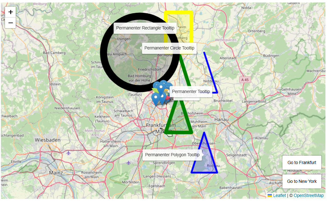

With this adapter, you can display various elements on a map using the Leaflet widget. These elements can be configured using a JSON data structure.
Complete Test picture Example from the complete Test Example

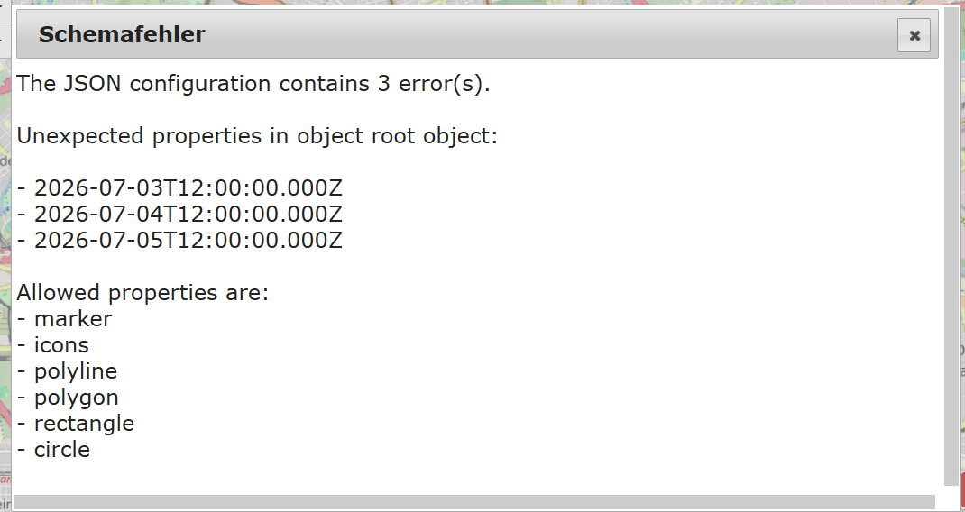

Map data is validated in edit mode. Any errors can be accessed and reviewed via the button with the red exclamation mark. This button is visible only if errors exist.
In vis, the dialog can be opened normally with a click. In vis-2, use 2 x SHIFT+click.
Button
Exclamationmark button
Dialog
ErrorDialog
