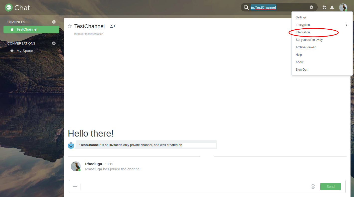

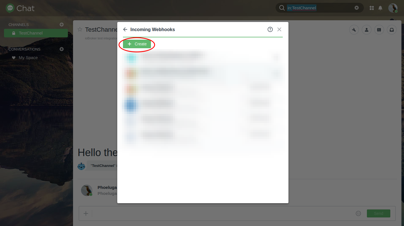

  • To create messages via the Synology Chat interface, an integration must be created in Synology Chat: SynoChatChannel SynoChatIntegrations
    2.1.1. Incoming integration
    For the integration of an incoming message in the Synology chat, a token is needed, which can be taken from the URL generated during the creation. SynoChatIntegrationIncoming SynoChatIntegrationIncomingSettings

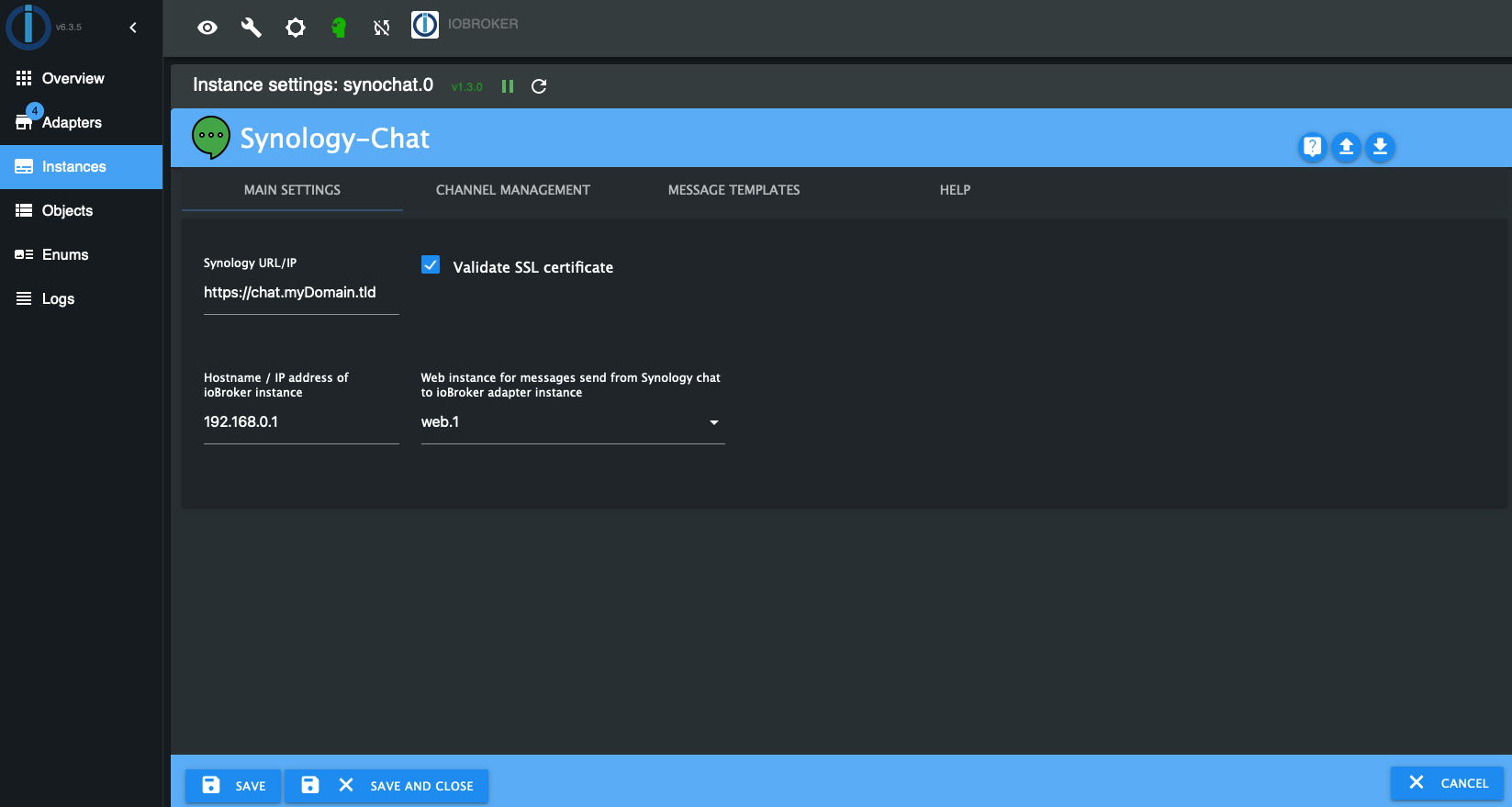

    2.2.1. Main settings:
    IobrokerInstanceSettingsMainSettings
    • Synology URL/IP
      With this property a URL to your Synology-Chat app will be provided. Please note to use an absolute URL including http:// or https:// and do not provide an postfix like /. A specific port can be provided as usual behind the URL using :.
      Sample for valid values:
    • Validate SSL certificate
      It is of course always recommended to encrypt data transfers. Often, self-signed certificates are used for encrypted connections in home environments. In this case, it may be necessary to disable SSL certificate verification of an HTTP connection. Disable this property to turn off certificate validation.
    • Hostname / IP address of ioBroker instance
      This property allows you to specify the hostname or IP address at which your ioBroker instance is accessible via URL. This value is automatically set to the current IP address of the host operating system of your ioBroker installation after the initial adapter instantiation.
      In case of using ioBroker as a Docker instance, it may be necessary to change this value, e.g. if a reverse proxy or similar is used to reach your ioBroker instance.
      This value is used to generate the web hook URL for channels that receive messages from the Synology chat server.
    • Web instance for messages send from Synology chat to ioBroker adapter instance
      The synochat adapter is using a web adapter to make web hooks available. You need to select a specific instance of the web adapter to provide a dedicated web hook to the Synology chat integration.

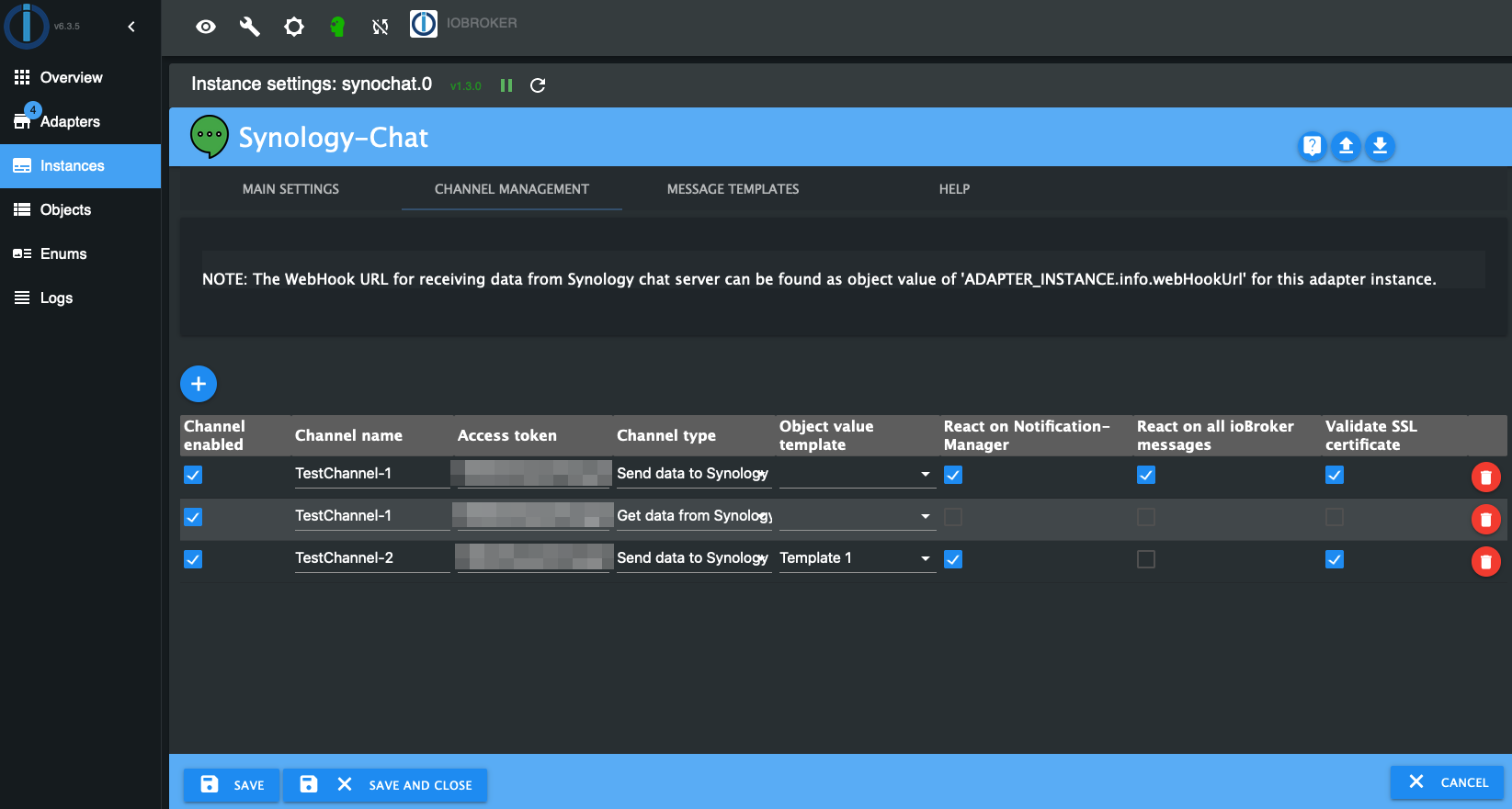

    2.2.2. Channel management / configuration:
    IobrokerInstanceSettingsChannelConfiguration
    • Channel enabled
      This option can be used to disable the handling of incoming or outgoing messages.
      This can be useful if e.g. the user wants to disable the use of a channel only temporarily and wants to keep the settings like the access token or similar to prevent to collect them again.
    • Channel name
      This setting specifies the name of the channel from/to which messages are sent. This name is free to choose in case of channels of type Send data to Synology chat server - Incoming integration and is used for referencing.
      The channel name to be configured here should be identical to the channel name of the Synology chat.
      For channels of type Get data from Synology chat server - Outgoing integration the name must be identical to the channel name of the Synology chat channel in order to receive messages. The mapping of the channel names is case sensitive (upper and lower case must be taken into account).
    • Channel token
      This setting provides the access token to the Synology chat channel. Depending on the channel type, the creation of this varies. More details can be found in chapter Synology chat configuration.
      NOTE:
      Depending on the integration, when create the Synology chat integration, you will get a link similar to the following example:
        https://mychat.mydomain.tld/webapi/entry.cgi?api=SYNO.Chat.External&method=incoming&version=2&token=%22QF5DWyG7M47Ls3cv%22
      In this example, the token is included in the URL. Encoded control characters - %22 - are specified here at the beginning and end of the setting.
      These have to be removed!
      In this example the token to be entered would be QF5DWyG7M47Ls3cv.
    • Channel type
      NOTE:
      The channel type must be specified from the perspective of the Synology chat. For example, selecting 'Incoming' in the configuration means that the messages will be sent to the Synology chat.
      This setting specifies the type of Synology chat channel that will be used depending on the integration selected in Synology chat.
      • Send data to Synology chat server - Incoming integration
        This option enables the channel to send the new value of the ioBroker message object (see usage chapter) as soon as the object value changes.
      • Get data from Synology chat server - Outgoing integration
        This option enables the channel to receive messages from the Synology chat server and update the new value of the ioBroker message object (see usage chapter).
        Please note that when using this channel type, the channel name of the ioBroker adapter instance configuration must be identical to the channel name of the Synology chat channel in order to receive messages. The mapping of the channel names is case sensitive (upper and lower case must be taken into account).
        Note: Please make sure not to select the 'react on' options for outgoing channels
      If a channel should be configured in both, sending and receiving messages, simply add a second channel with the same name and select the other channel type.

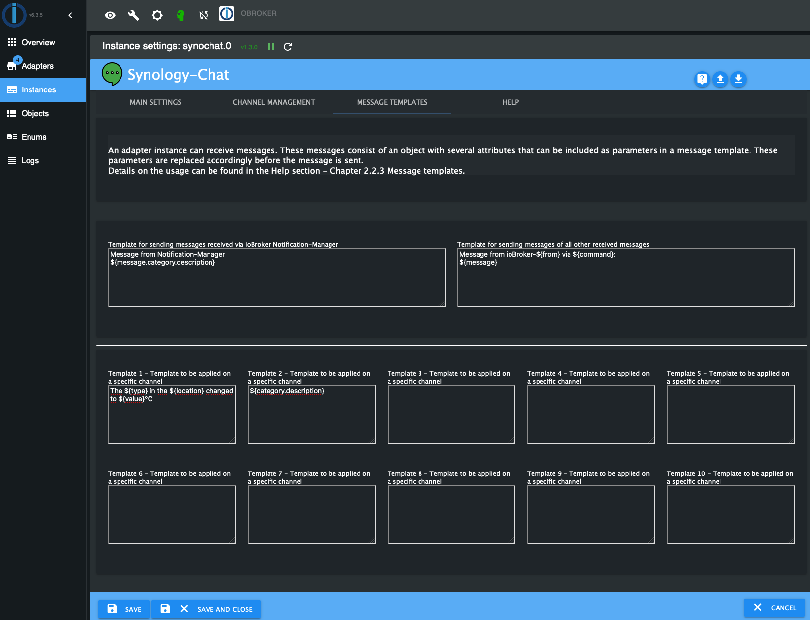

    2.2.3. Message templates:
    It is possible to define message templates that are processed before sending a message to Synology Chat Server. These templates can contain patterns that are replaced during the sending process.
    Patterns must always start with ${ and end with }. e.g. ${foo}. While processing the message the pattern ${foo} will be replaces with the corresponding JSON value of the attribute foo.
    Sample:
    If a channel configured to send data to Synology Chat receives an object change to its message object, it may contain a JSON value like the following:
        "sensor": {
            "id": "temp0815",
            "name": "Temperature - Living room",
            "type": "temperature",
            "location": "living room",
            "value": "23.4"
    You can access the inner attributes of this value by providing them in a path like ${sensor.value}.
    If you would like to send a text like
    The temperature in the living room changed to 23.4°C
    your message template would look like this:
    The ${sensor.type} in the ${sensor.location} changed to ${sensor.value}°C

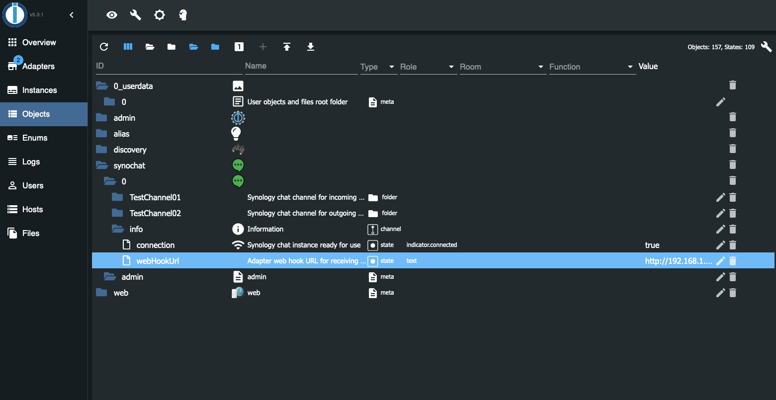

  • After configuring the adapter instance, a folder with the channel name is created for each configured channel in the objects of the respective adapter instance. IobrokerObjectOverview
  • In this folder a message object of the respective channel can be found, which represents the sent or received message.

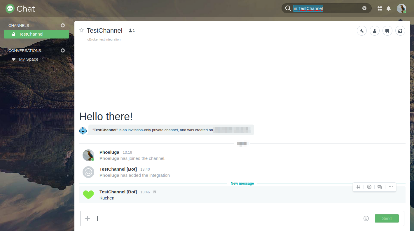

  • When the message object is changed and the channel type is set to Send data to Synology chat server, this message is passed to the Synology chat. SynoChatChannelIncomingMessage
  • To receive messages from Synology Chat Server and for the message object to be updated accordingly, make sure that the configured Trigger word (see Synology chat configuration) is in the message without punctuation. So it must stand alone.

  • The web hook URL / address will be provided as an object value in the info folder of the adapter instance and is valid for all channels withing one adapter instance. IobrokerObjectWebHook
