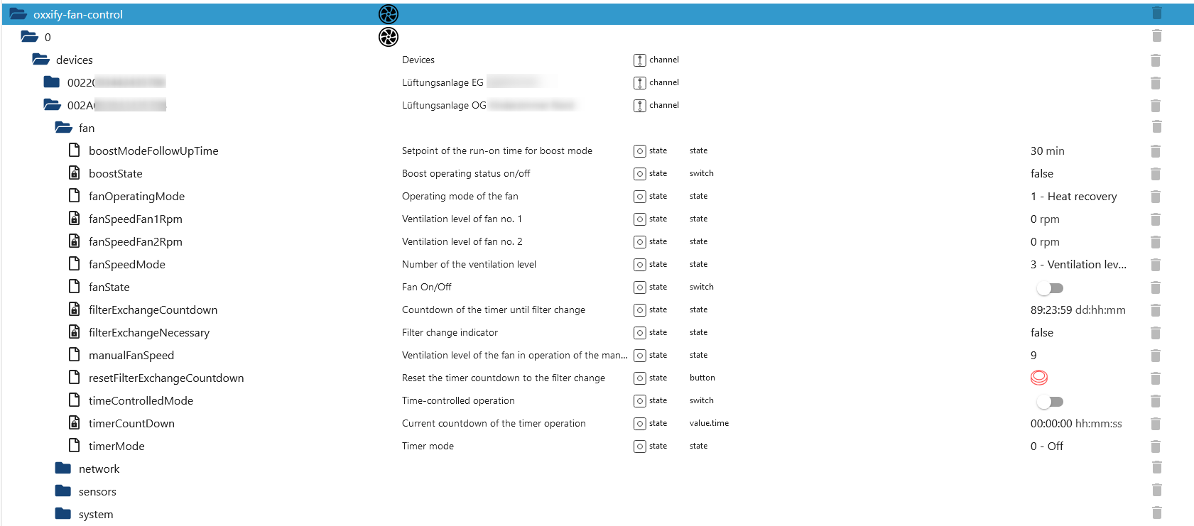

Fan data
This channel contains any fan related data like timers, fan speed, on/off state and information regarding the filter cleaning/exchange interval. The fan operating modes contains the numerical valu[...]

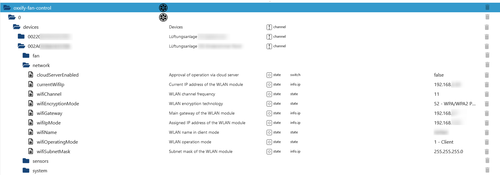

Network data
The network data is currently read-only, writing/changing of values here is not yet implemented and can be done with the app of the manufacturer. Same applys for the cloud server control state.

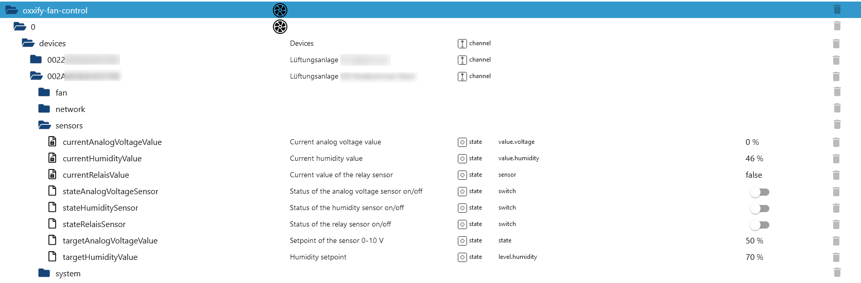

Sensors data
The data entrys for the sensors are implemented as defined in the protocol. The analog voltage vale is in % as defined in the protocol. I have nothing connected to the analog and relais sensor, so[...]

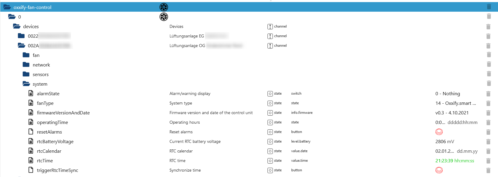

System data
This channel contains system data about the hardware and firmware as well as runtime, RTC battery voltage and date/time. Here alarms can be reset and also the RTC time can be set based on the conf[...]
