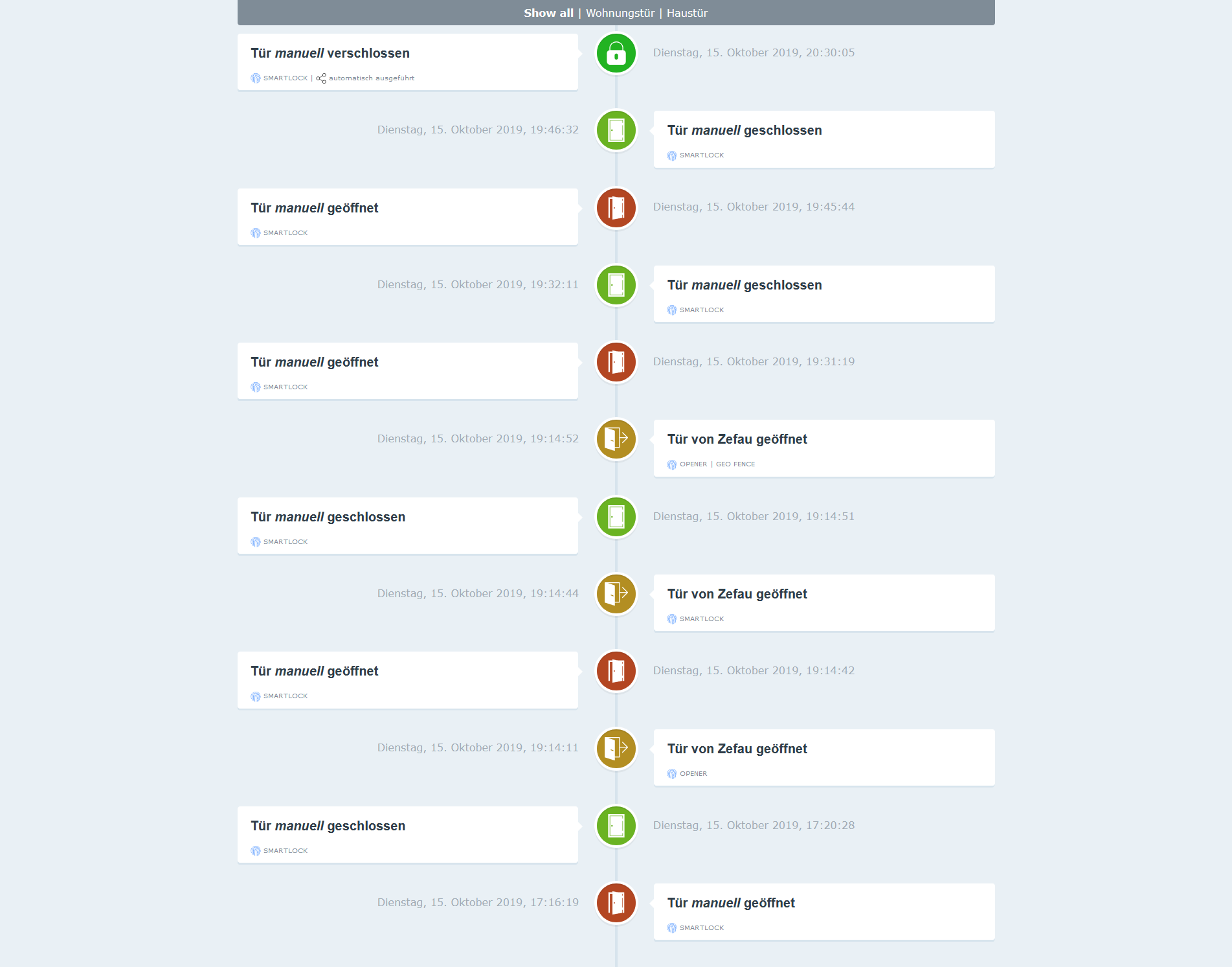

- Web Interface that shows the recent events from your Nuki Smartlock and Nuki Opener:
