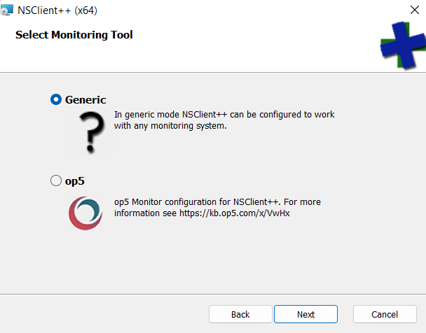

  • When prompted select monitoring tool - generic
install-001

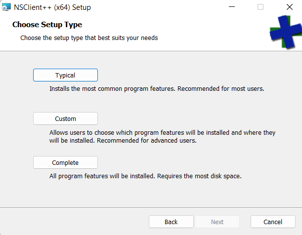

  • Select installation type typical
install-002

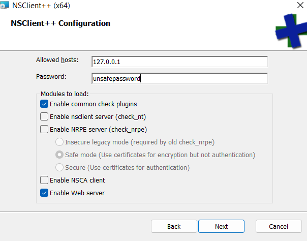

  • enable common check plugins and WEB server (other modules are not required for ioBroker access, but feel free to install them if any other usage is intended.)
install-003

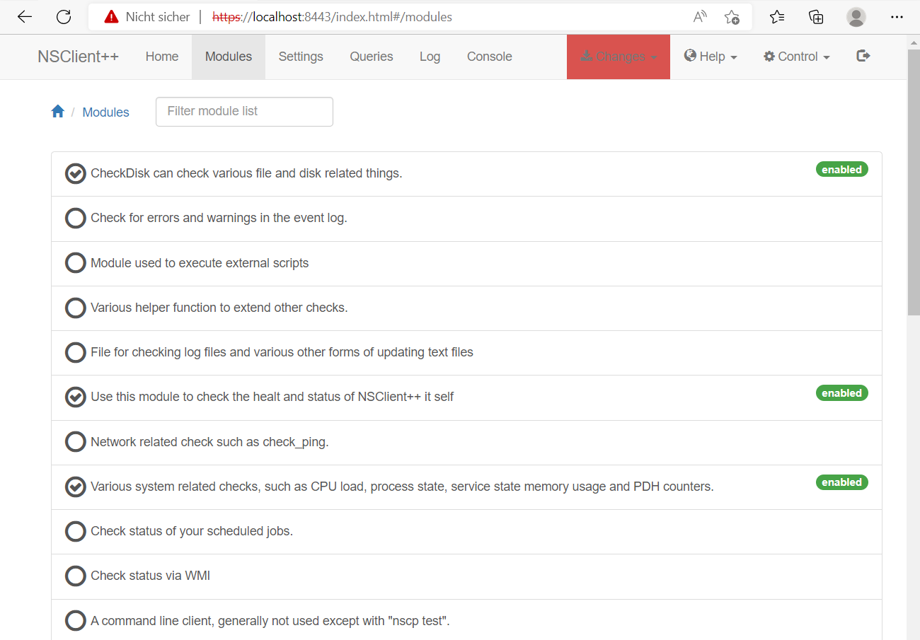

  • ensure that the required modules are loaded an enabled
    see the list of modules in the next picture
install-003

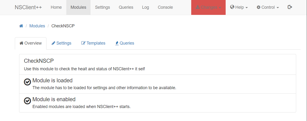

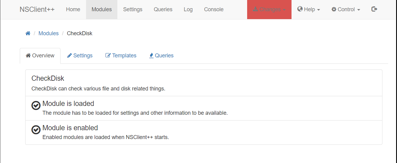

  • most likely you will have to load and enable some modules. To do this, click onto the line listing the module to open the module config. Mark loaded and enabled buttons.
    Do not forget to save the changes
config-001
config-002
config-003
