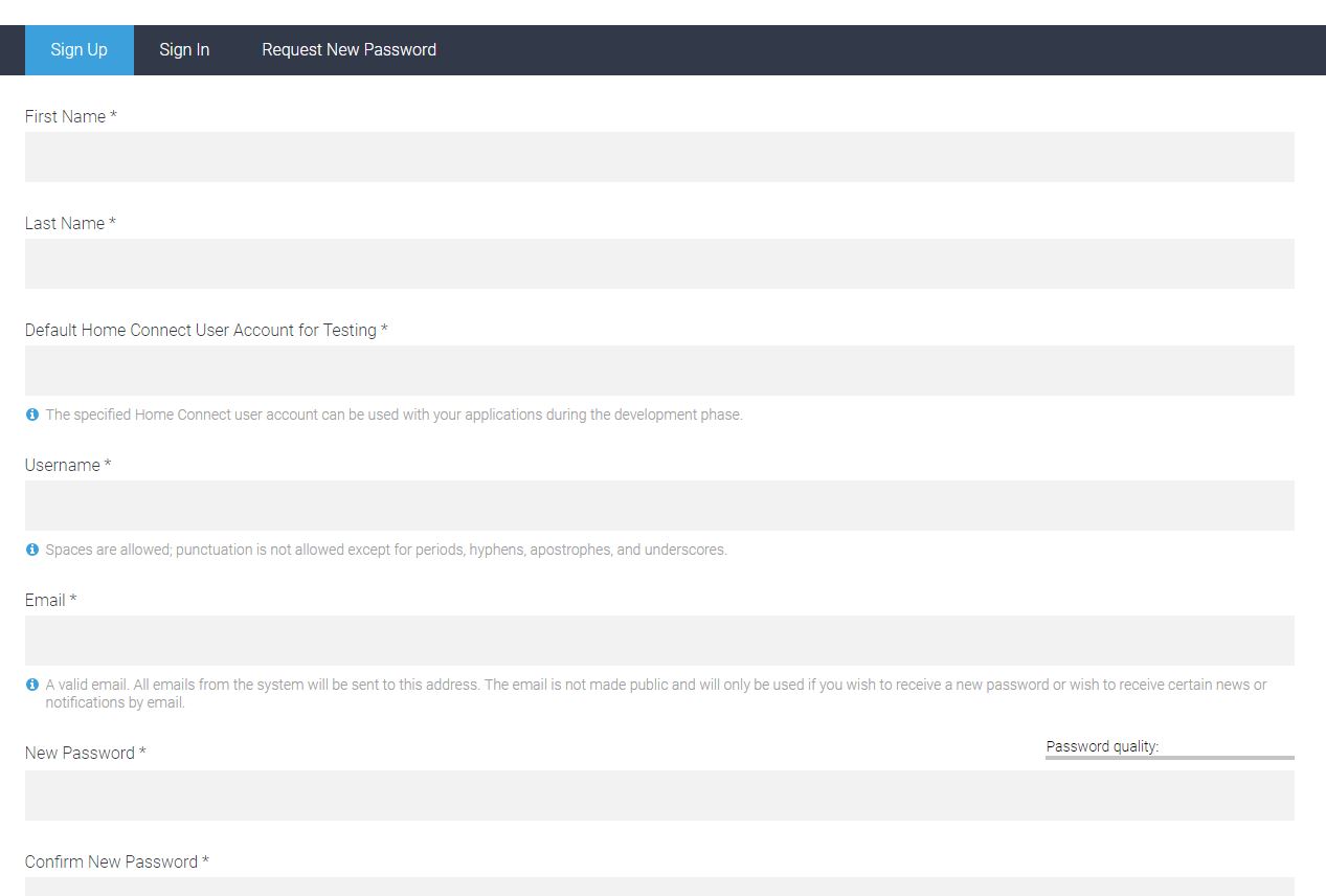

For Default Home Connect User Account for Testing, specify the e-mail address with which the Home Connect app is to be sent. was registered, this is also required later in the authorization process.
Screenshot

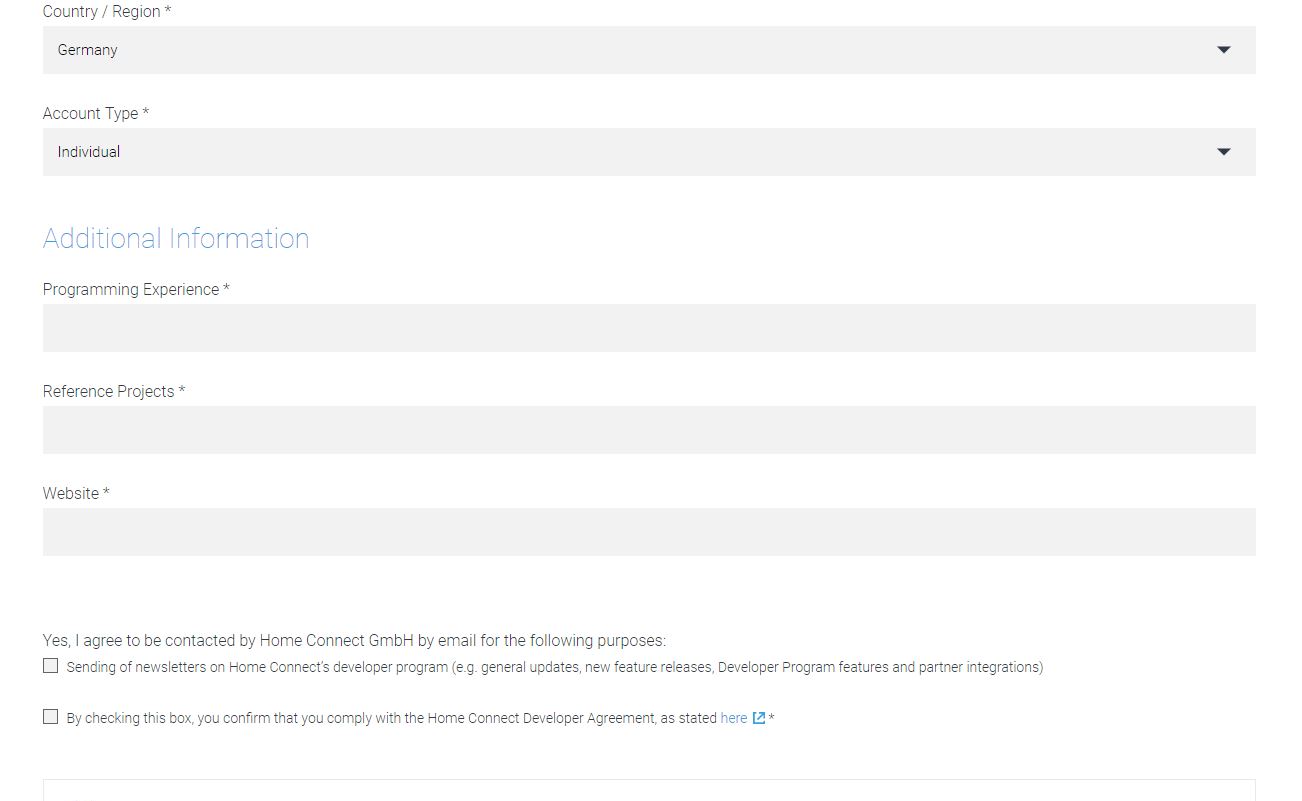

For Account Type select Individual. Add the remaining data if available (no idea if this will be checked).
Screenshot

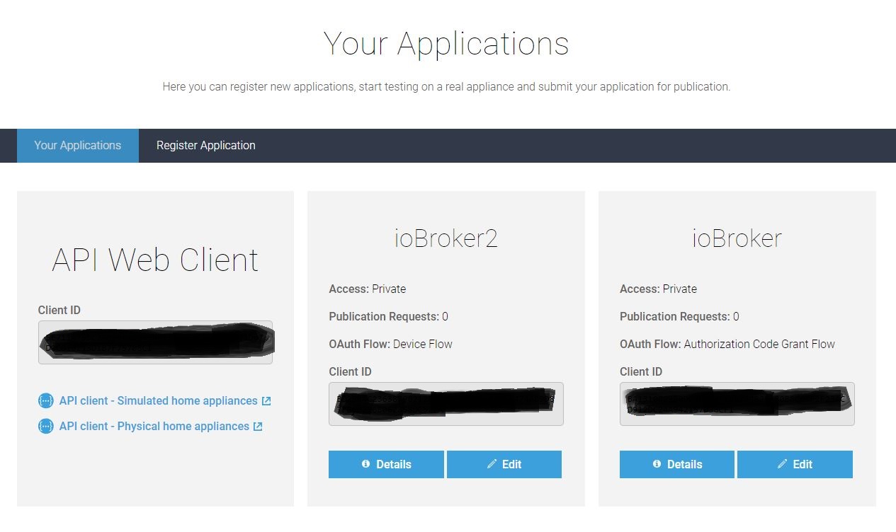

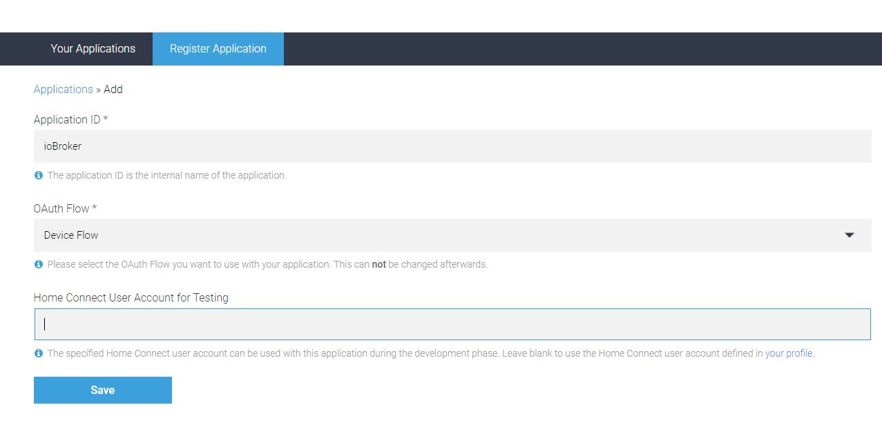

Then go to Applications and then to Register Application.
Screenshot
For Application ID enter a name for the application, e.g. ioBroker. With OAuth Flow Device Flow select. Home Connect User Account for Testing can remain empty. For Success Redirect enter a URI, e.g. https://example.com. Then save and you have the required ClientID.
