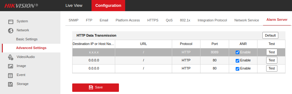

On Camera
Visit the configuration page of your camera(s) and define ioBroker IP/host and port settings:
Alarm Server Options

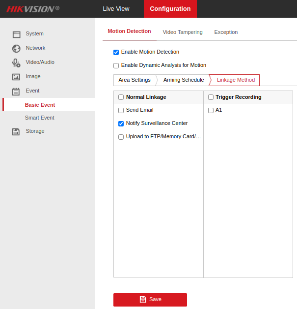

Make sure to linkage in the events you would like to report to ioBroker includes 'Notify Surveillance Center'. Eg:
Motion Detection Options
