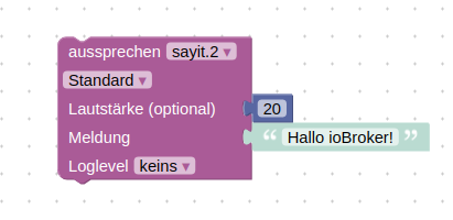

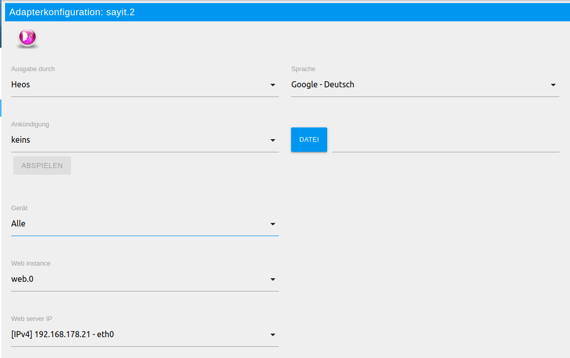

SayIt
SayIt Adapter is supported.
Sayit Sayit Config

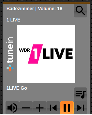

Player View
  • Open the file: player_view.json
  • Replace 123456789 with the player pid
  • Import view into VIS
Player view

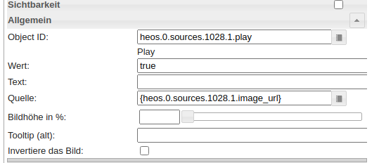

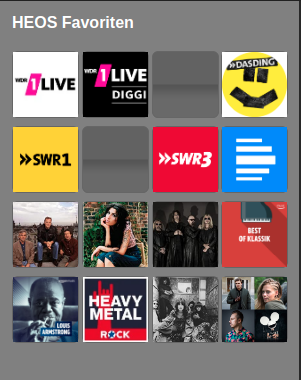

Presets
  • Click button heos.0.sources.1028.browse to load presets
  • Open the file: presets_view.json
Presets config Presets

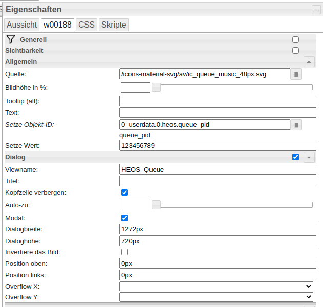

Queue
Queue widget

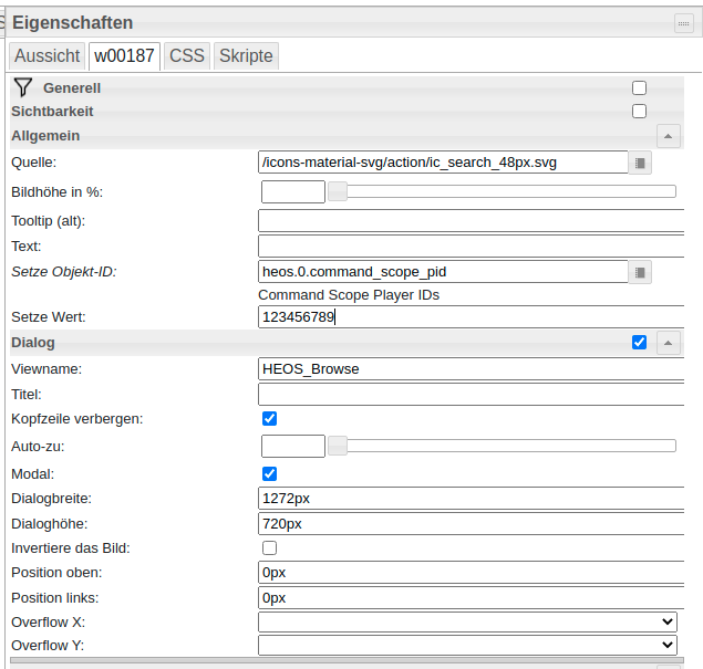

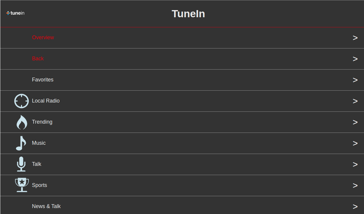

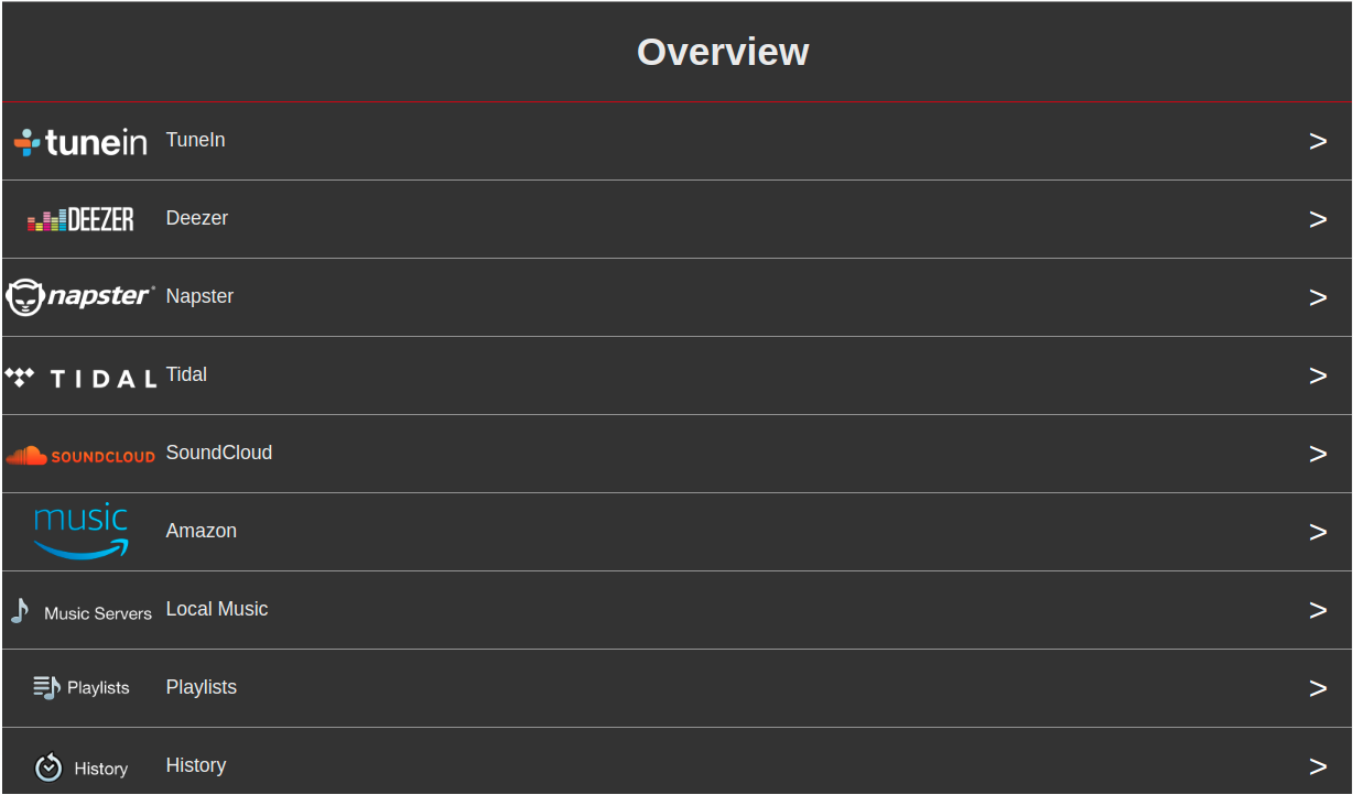

Browse Sources
Browse widget Browse sources Browse tunein
Alternative you can use the script from Uhula: https://forum.iobroker.net/post/498779
