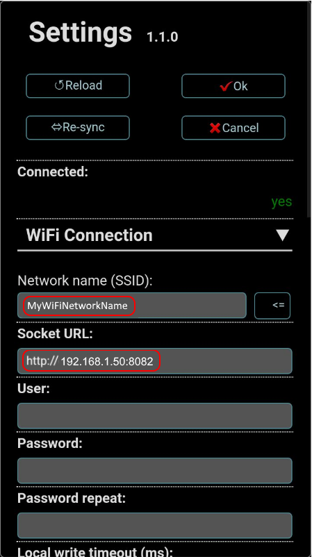

  1. Configure WiFi connection.
WiFi connection
Enter your home SSID name to detect if your at home or not. You can just click on "<=" button and the current SSID will be automatically inserted into the corresponding field.
Depends on the SSID name the app will determine if it must use local address (Socket URL on the last picture) or iobroker.pro as connect way.

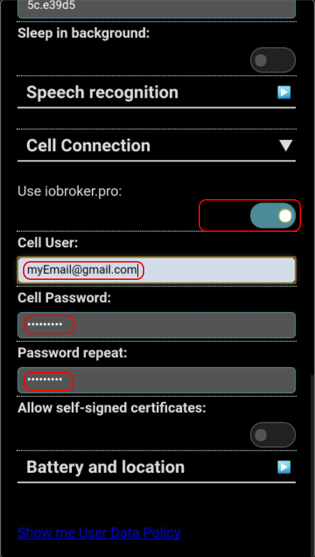

  1. You must enter your ioBroker.pro credentials in "Cell connection" part:
Cell connection
Activate checkbox "Use iobroker.pro" and enter below your login (email) and password for ioBroker.pro cloud.
After that, when you connect via iobroker.pro you will see the small icon in the top right corner for first 10 seconds if connection is via iobroker.pro cloud.
iobroker.pro icon
