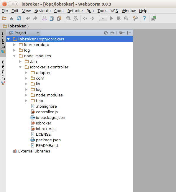

  1. Open WebStorm with ./webstorm.sh

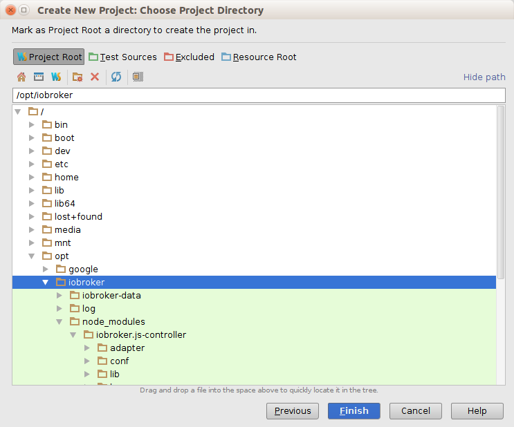

  2. Click File->"New Project from existing files...
  3. Select the following...
  1. Choose your ioBroker directory... (right mouse click on directory to set the project root)
  2. Your new WebStorm- project should look like this...

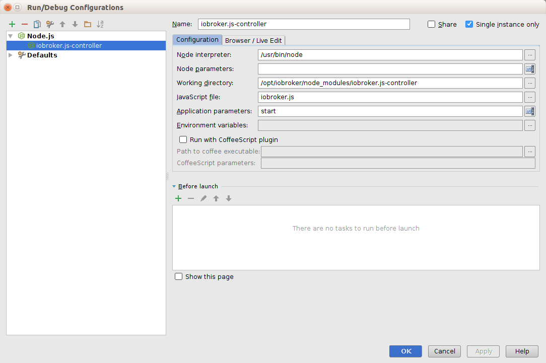

Create the "Run Configuration" ioBroker

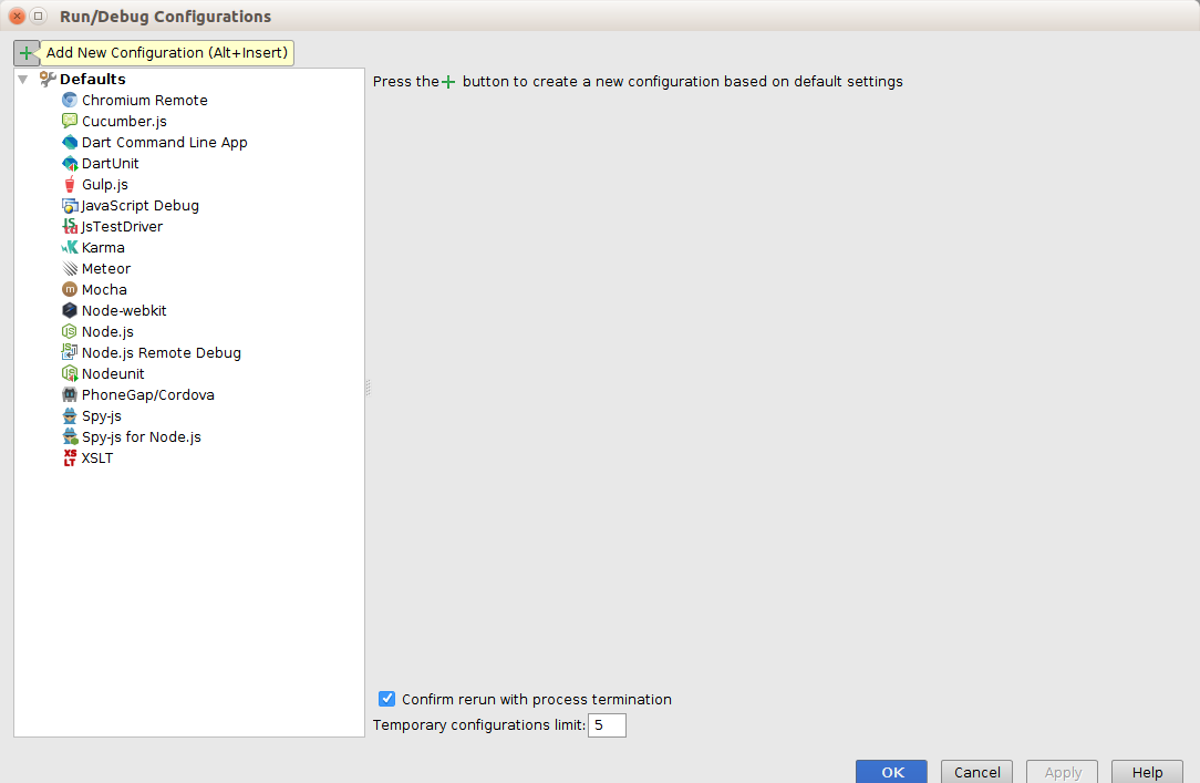

  1. Go to Run->"Edit Configuration..."
  2. Select the "+" and add a NodeJS Config like on the picture below...

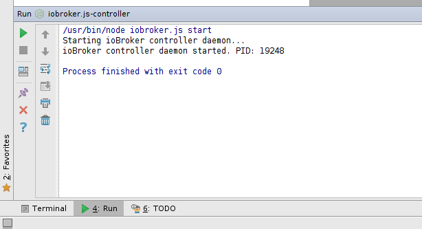

How to start ioBroker from WebStorm
  1. Start ioBroker with selecting...
  2. You may ask yourself how to stop ioBroker? Open a Terminal inside WebStorm and type ...

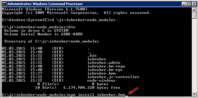

In this chapter we will see how to debug a ioBroker Adapter like "iobroker.hmm". First start ioBroker like mentioned before, please don't use the "debug mode". Use for ioBroker only the "run mode". Install an Adapter like ioBroker.hmm from the commandline like this

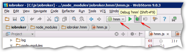

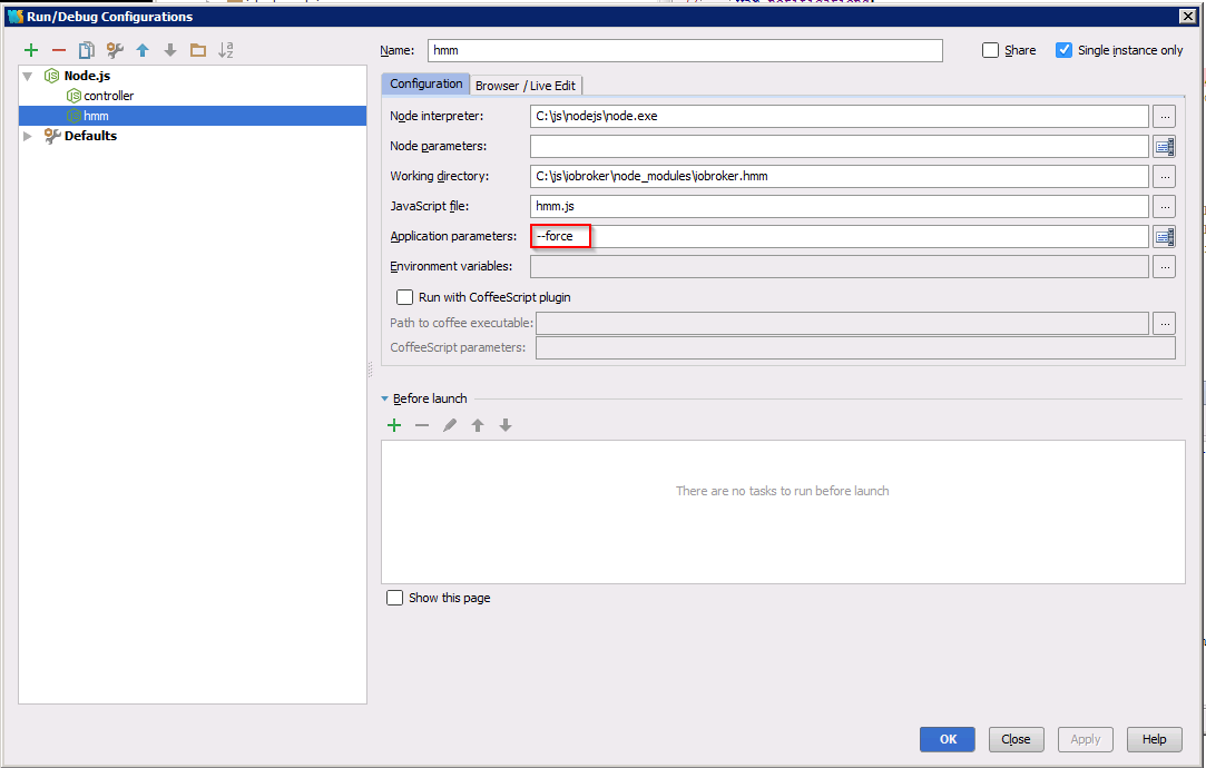

Configure the WebStorm "Debug settings" ...

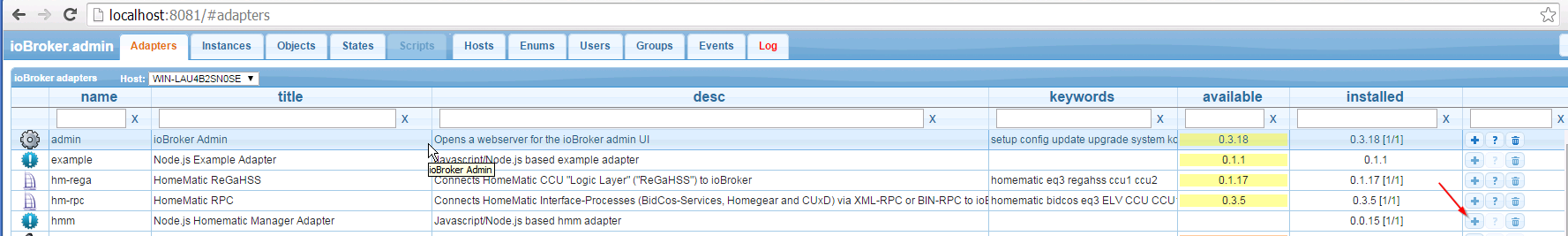

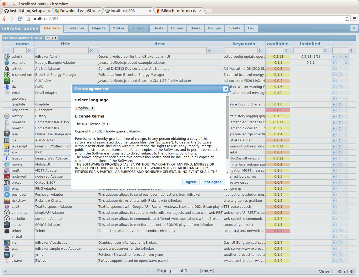

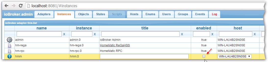

Goto to the ioBroker Webpage http://localhost:8081 and install the iobroker.hmm Adapter:

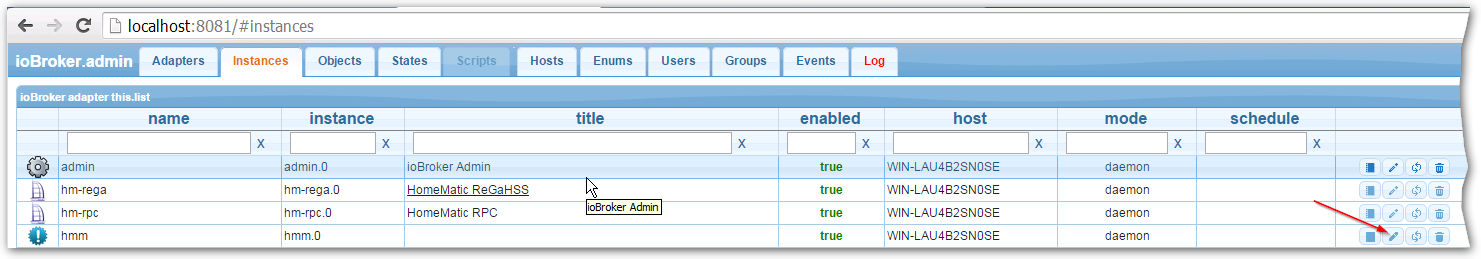

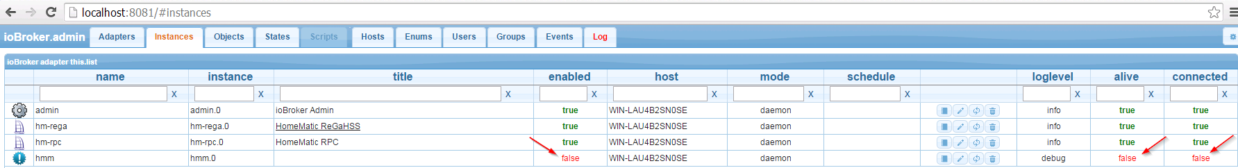

After installing the adapter we have to disable the adapter instance...
...next
...at the end you should see this result:

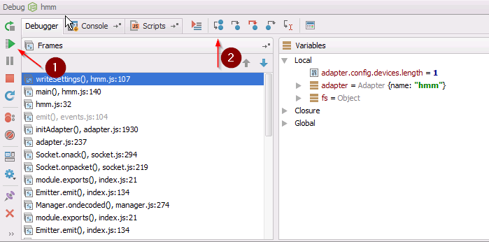

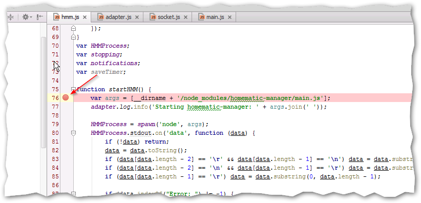

Now back to WebStorm let us open the hmm.js file and set a breakpoint like this one:
Start bebugging the iobroker.hmm adapter:
When you stop at the first breakpoint you can control the next steps with 1) resume the program 2) step over:
