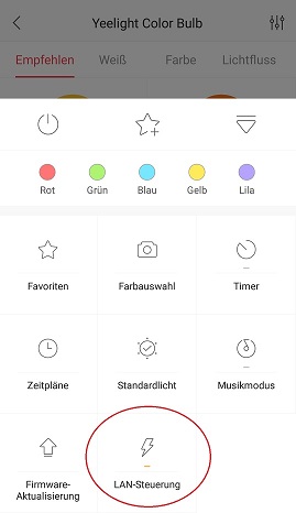

Installation
For all the Yeelights you want to control, you need to enable "LAN Control" in the yeelight app settings.
