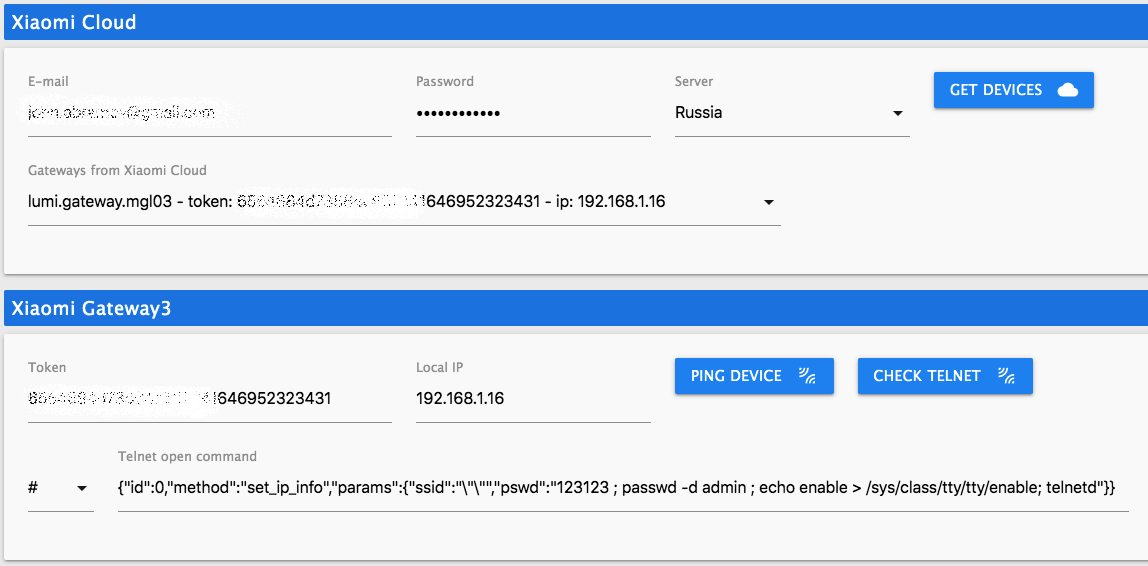

Configuration
To connect a gateway you need get IP and TOKEN of gateway. You can do this manually or from cloud.
Also you have to chose telnet open command (in most cases option #2). You can test connection and telnet by buttons.
Ping here not actually ping. It is more check of device availability.

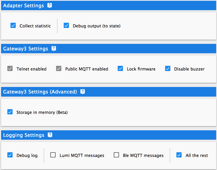

You have several options to configure adapter and gatewey.
Adapter settings
  • Collect statistic
    Adapter collect statistic about zigbee devices messages: how much received, how much missed and etc. Statistic stored to state at each device and can be viewed in 'tab' page (from sidebar menu).
    Note: Adapter do reset statistic on restart.
  • Debug output (to state)
    Adapter will doing output some debug info into state for each device.
Basic Gateway3 settings
  • Telnet enabled
    Enabled by default and have to stay enabled. Here just for info.
  • Public MQTT enabled
  • Lock firmware
    Set true (or false) to disable (or enable) possibility to upgrade gateway firmware.
  • Disable buzzer
    Set true to disable annoying buzzer signals or false to enable all signals.
Advanced Gateway3 settings
  • Storage in memory (Beta)
    Move devices DB files to memory. This can improve work zigbee and bluetooth devices. But can occur losing some data. Use on your own risk.
Logging settings
Note: To see debug messages in ioBroker log you have to set debug log level for adapter under Instances page (toggle expert mode into enabled)
  • Lumi MQTT messages
    Enable MQTT messages debug logging of Lumi (zigbee) devices.
  • Ble MQTT messages
    Enable MQTT messages debug logging of BLE devices.
  • All the rest
    Enable debug logging all other adapter messages.
  • Cut SPAM
    Enable cutting duplicate messages. If identical error messages repeat several times they will be hidden and after 1 hour will shown total count.

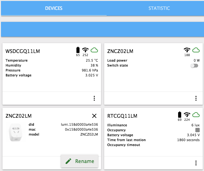

Tab page
Devices
There are devices cards on devices page in which you can see some info about device, current states values and can control some of them.
Also you can change friendly name of device.
Note: For now this page has basic functional. It well be expanded in future.

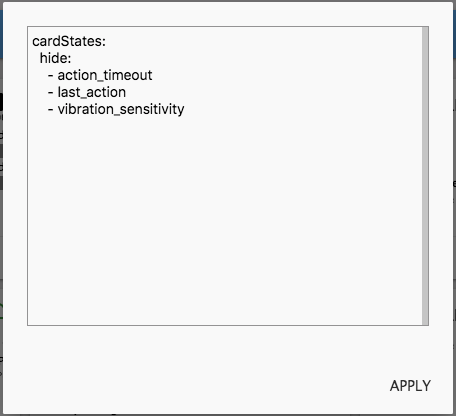

Device config
You can define some options to configure device (and device's card) by writing configuration with yaml. Available options discribed belowe in table. You can invoke device config window (window with text input area) with Config point in menu.
Device configuration options
FieldTypeDescription
cardStatesDictionaryThis dictionary hold options for states in device's card
cardStates.hideListList of states (states ids) which have to be hidden from device's card

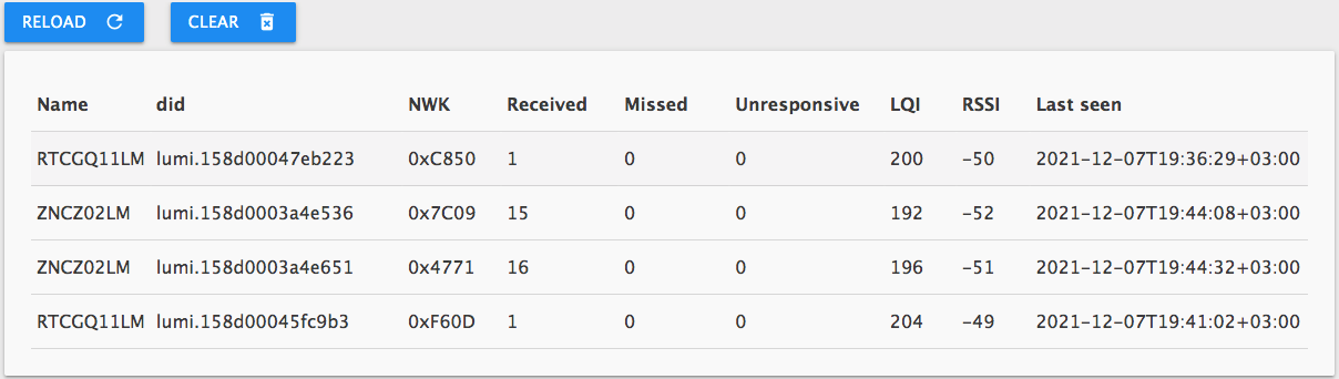

Statistic
  • Statistics are not loaded by default. You have to use button RELOAD to update statistic on page.
  • Also you can clear statistic with button CLEAR. This does not clean statistic actually as it is. You just clear states which hold statistic. This can be useful in case adapter restart because ioBroker states don't clear on restart.
Attantion: You should to keep in mind this is not really statistic of zigbee messages between gateway and device (zigbee protocol statistic). This is statistic of messages which get adapter. What does it means? No differences for adapter is gateway don't get message from device or adapter himself don't get message from gateway (by MQTT). And if by any cases (Wi-Fi connection problem, for example) adapter don't get messages from gateway it interpritate this messages as missed, but actualy zigbee is ok.
