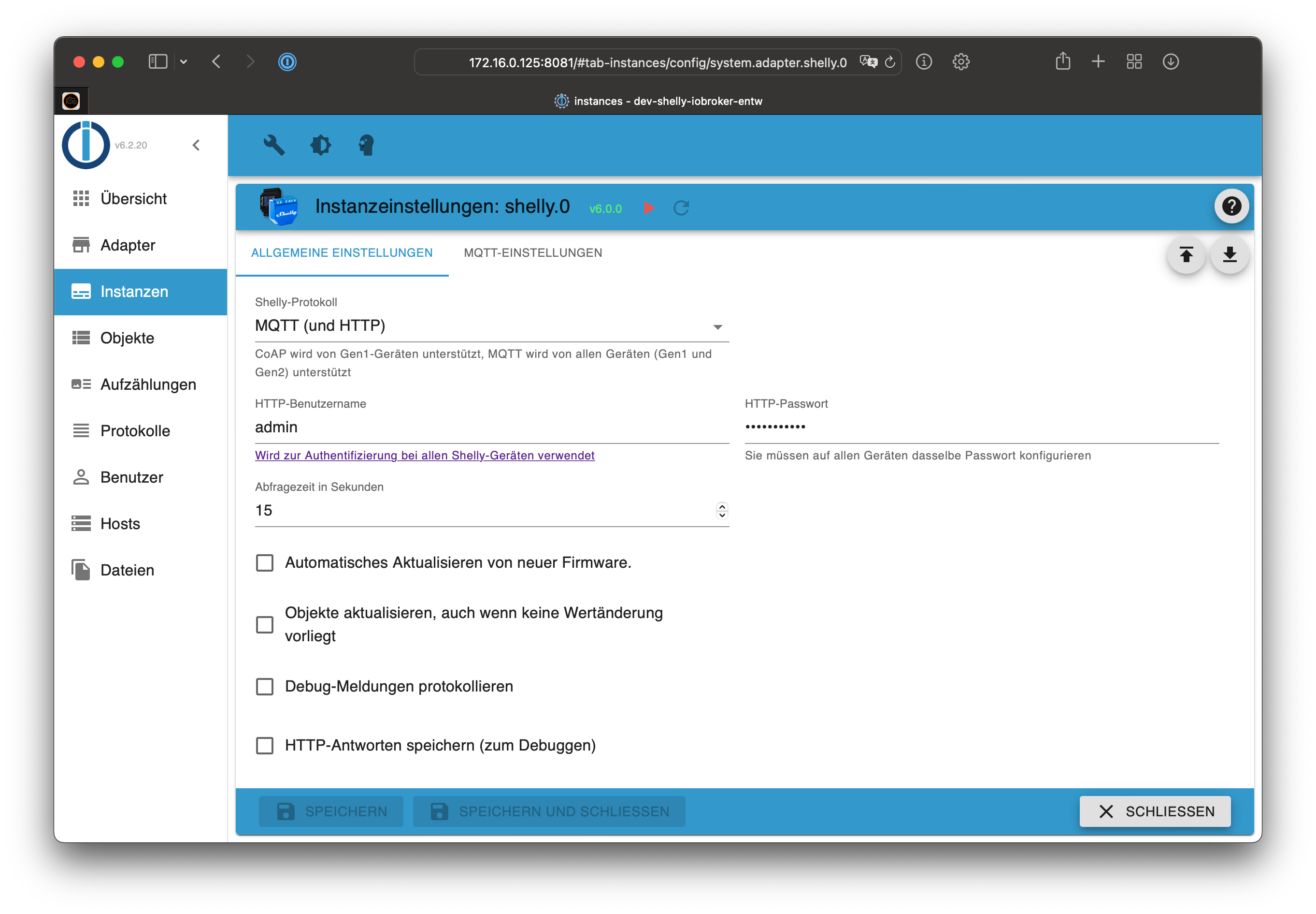

General
The adapter can be used in MQTT (recommended) or CoAP/CoIoT mode.
  • The default mode of the adapter is MQTT (see documentation for details)
  • CoAP/CoIoT is just compatible with Gen1 devices!
  • If you want to use Gen2 devices, you must use MQTT!
Questions? Check the FAQ section first!
iobroker_general
