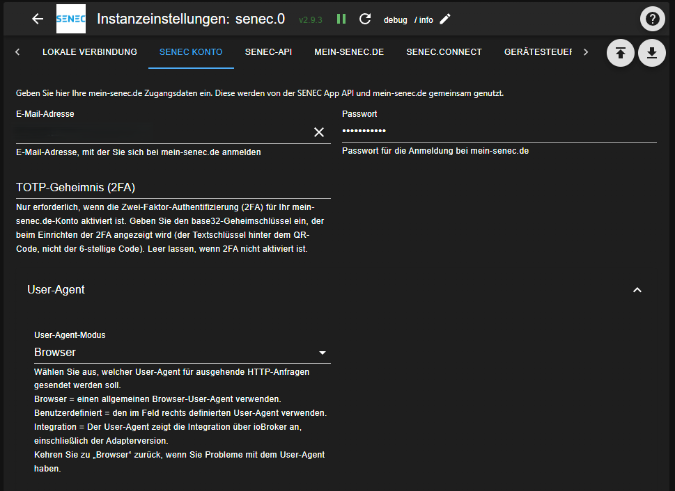

SENEC Account
Enter your mein-senec.de credentials here. These are shared by the SENEC App API and mein-senec.de connectors. You can also configure the User-Agent mode for outbound HTTP requests.
Two-Factor Authentication (2FA)
If two-factor authentication is enabled on your mein-senec.de account, the adapter can log in on its own — it does not need you to be there to type a code.
Enrolment shows a QR code for your authenticator app and, next to it, the same secret as text. That text secret is what goes into the TOTP Secret field. Take it from the setup screen while it is on display; once 2FA is active the secret is not shown again, and you would have to re-enrol to see a new one. Spaces and dashes in it do not matter.
What belongs there is the permanent secret, not the six-digit code your app shows — that changes every thirty seconds and would be stale before the adapter ever used it.
One secret covers both cloud connectors, since they authenticate against the same account. If 2FA is required and the field is empty, the adapter says so plainly in the log rather than reporting a failed login.

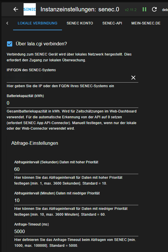

Local Connection (lala.cgi)
| Setting | Description | Default |
| Connect via lala.cgi | Enable local polling | On |
| SENEC System IP | IP address or FQDN of your SENEC device | — |
| Use HTTPS | Enable if your device uses HTTPS | Off |
Expand Polling Settings to adjust timing:
| Polling interval (high priority) | How often to poll real-time data (seconds) | 10 |
| Polling interval (low priority) | How often to poll slow-changing data (minutes) | 60 |
| Request timeout | Timeout for HTTP requests (ms) | 5000 |
The adapter retries automatically with exponential backoff on connection failures — no manual retry configuration needed. If the SENEC device is temporarily unreachable (reboot, firmware update), polling resumes automatically when the device comes back online.

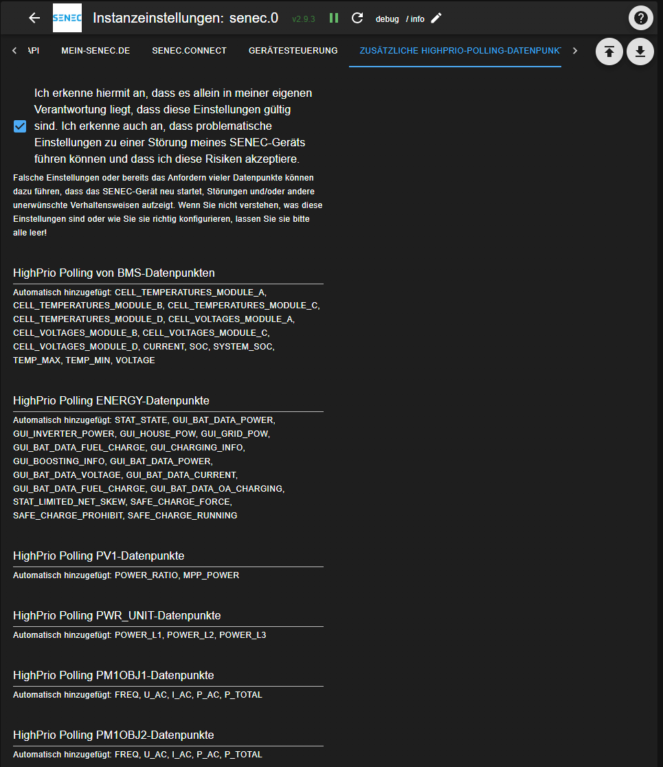

Important: Polling too frequently or requesting too many data points can overload your SENEC device. This may cause the device to restart, become unresponsive, or fail to synchronize with the SENEC cloud. If you experience issues, reduce the polling frequency or stop the adapter.
Additional High-Priority Polling Data Points
You can add additional data sections (e.g. BMS, PV1, WALLBOX) to the high-priority polling cycle. This requires accepting a disclaimer acknowledging the risks. Only characters A-Z, digits 0-9, and commas are allowed.

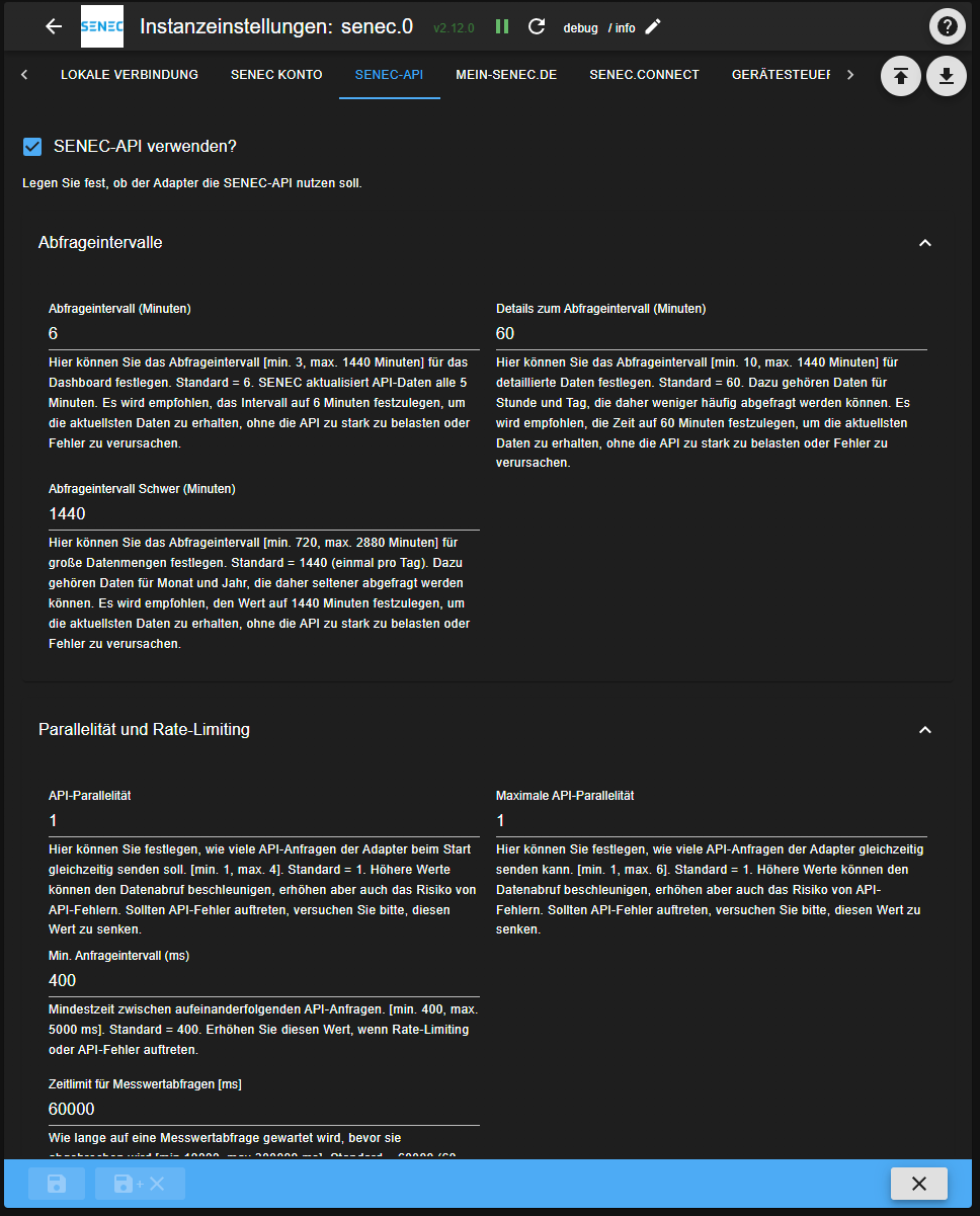

SENEC App API
| Use SENEC App API | Enable cloud API polling | Off |
| Dashboard interval | Polling interval for dashboard/current data (minutes) | 6 |
| Details interval | Polling interval for day-level measurement data (minutes) | 60 |
| Heavy interval | Polling interval for month/year measurements (minutes) | 1440 (24h) |
| Concurrency / Max concurrency | Parallel API request limits | 1 / 1 |
| Min request interval | Minimum time between API requests (ms) | 400 |
| API request timeout | How long to wait for an ordinary API request — dashboard, system status, details (ms). Raise it if the log shows those requests timing out | 30000 |
| Measurement request timeout | How long to wait for a measurement aggregation (ms). Raise it if the log shows heavy polls timing out | 60000 |

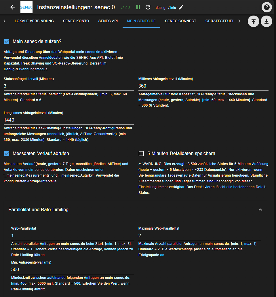

mein-senec.de
| Use mein-senec.de | Enable web portal polling | Off |
| Status interval | Polling interval for status data (minutes) | 6 |
| Medium interval | Polling interval for yesterday/autarky/spare capacity (minutes) | 360 (6h) |
| Slow interval | Polling interval for monthly/yearly/AllTime data (minutes) | 1440 (24h) |
| Poll measurement history | Enable measurement data polling | Off |
| Include 5-min detail data | Poll fine-grained detail data (~3,500 additional states) | Off |
| Concurrency / Max concurrency | Parallel request limits | 1 / 2 |
| Min request interval | Minimum time between requests (ms) | 500 |

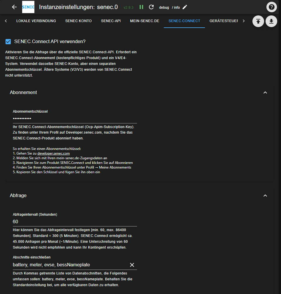

SENEC.Connect
| Use SENEC.Connect | Enable Azure API polling | Off |
| Polling interval | How often to poll (seconds) | 300 |
| Request timeout | How long to wait for a response (ms) | 30000 |
| Subscription key | Azure API subscription key | — |
| Include sections | Which data sections to request | battery,meter,evse,bessNameplate |

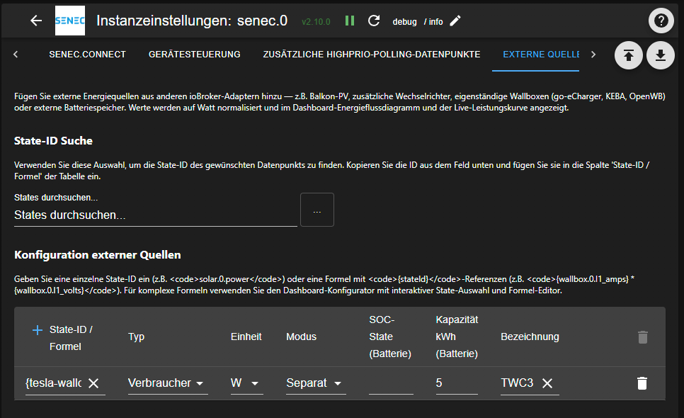

External Sources
Add external energy sources from other ioBroker adapters — e.g. balcony PV, additional inverters, standalone wallboxes, heat pumps, or external battery storage. Values are normalized to Watts and shown in the dashboard energy flow diagram and live power chart.
Use the State ID Lookup picker to find the state ID of the datapoint you want to use, then paste it into the table.
| Column | Description |
| State ID / Formula | Single state ID (e.g. solar.0.power) or formula with {stateId} references (e.g. {wallbox.0.l1_amps} * {wallbox.0.l1_volts}) |
| Type | PV, Consumer (wallbox, heat pump, etc.), or Battery |
| Unit | W or kW — applied to the final value |
| Mode | Integrate = add to SENEC total (single node). Separate = show as individual node in energy flow |
| SOC State | (Battery only) State ID for the charge level (%) |
| Capacity | (Battery only) Battery capacity in kWh — enables time estimates |
| Label | Display name shown on the energy flow diagram |
Formulas support + - * / ( ) operators. State IDs without curly braces are auto-detected if they contain math operators. For complex formulas, a dashboard-based configurator with interactive state pickers is planned.

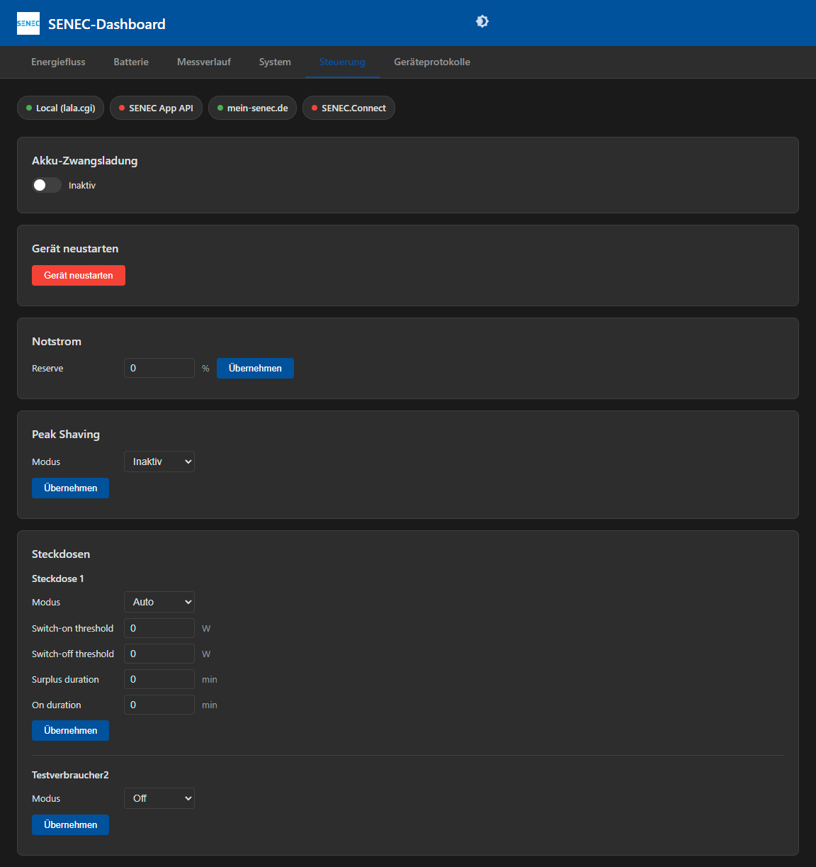

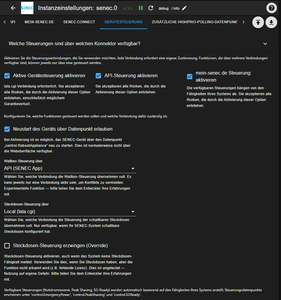

Appliance Control
Control features allow you to change settings on your SENEC device. Each control is available via specific connectors:
| Control | Local | API | Web |
| Force battery charging | x | ||
| Block battery discharge | x | ||
| Appliance reboot | x | ||
| Emergency power reserve | x | ||
| Peak shaving | x | ||
| SG-Ready | x | ||
| Switchable sockets | x | x | |
| Wallbox control | x | x |
Use at your own risk. Control features must be explicitly enabled in the settings with a disclaimer acknowledgment. The adapter does not protect against conflicting commands from multiple connectors.

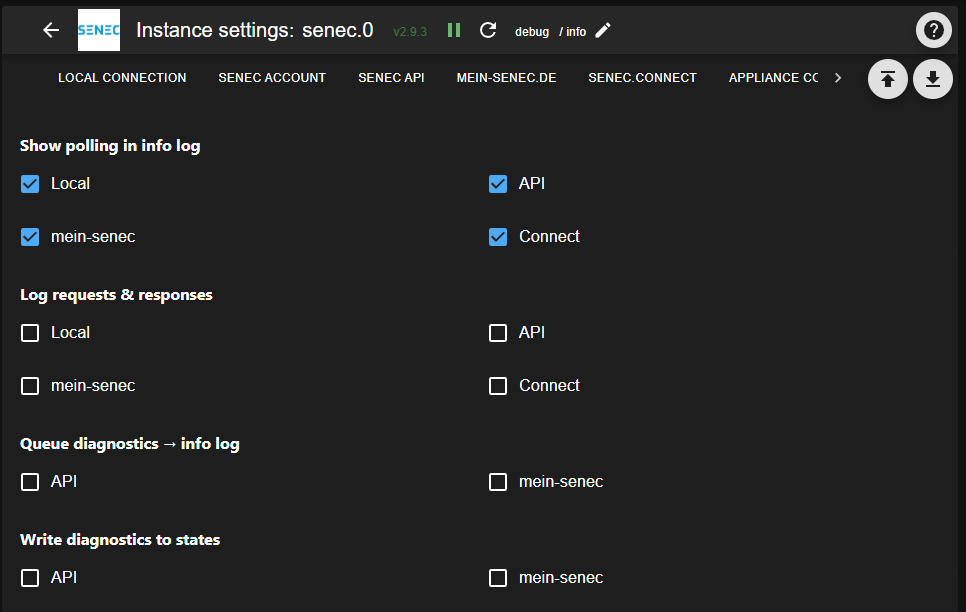

Debug & Logging
Configurable per connector (Local, API, mein-senec.de, Connect):
- Show polling in info log — Promotes polling status messages from debug to info level
- Log requests & responses — Logs HTTP details at debug level (may log sensitive data)
- Queue diagnostics to info log — Promotes queue statistics to info level (API + Web only)
- Write diagnostics to states — Writes queue data to dedicated ioBroker states (API + Web only)

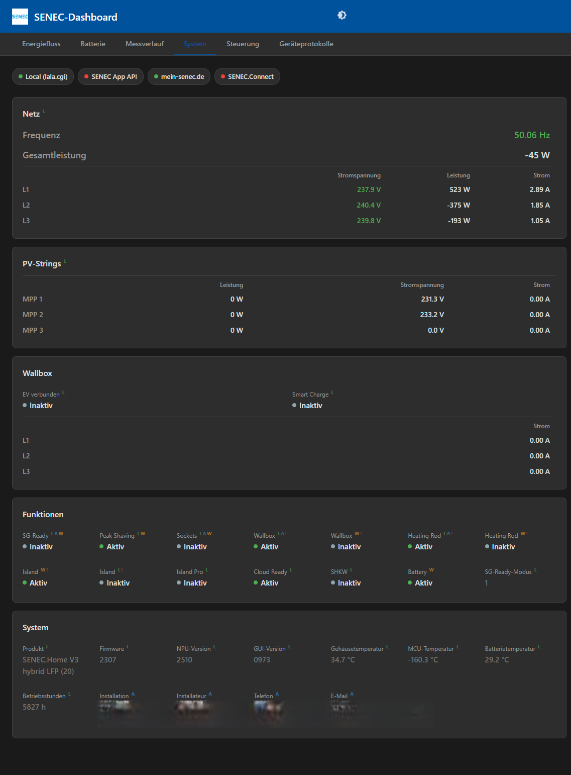

Built-in Dashboard
The adapter includes a full-featured web dashboard accessible at http://<iobroker-ip>:8082/senec/. It requires the ioBroker.web adapter and appears on the ioBroker.web welcome page.
Features:
- Dark and light theme (toggle in the top bar)
- Internationalization — 11 languages, follows browser locale
- Real-time updates via socket.io state subscriptions
- Data from all connectors with source indicator badges
- Keyboard accessible (tab navigation, ARIA labels)

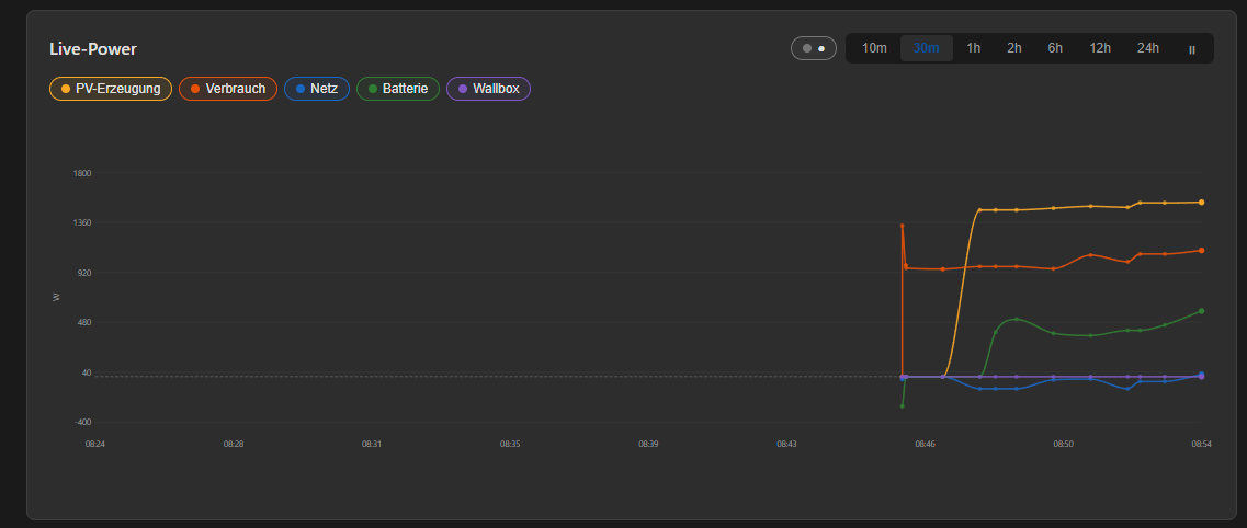

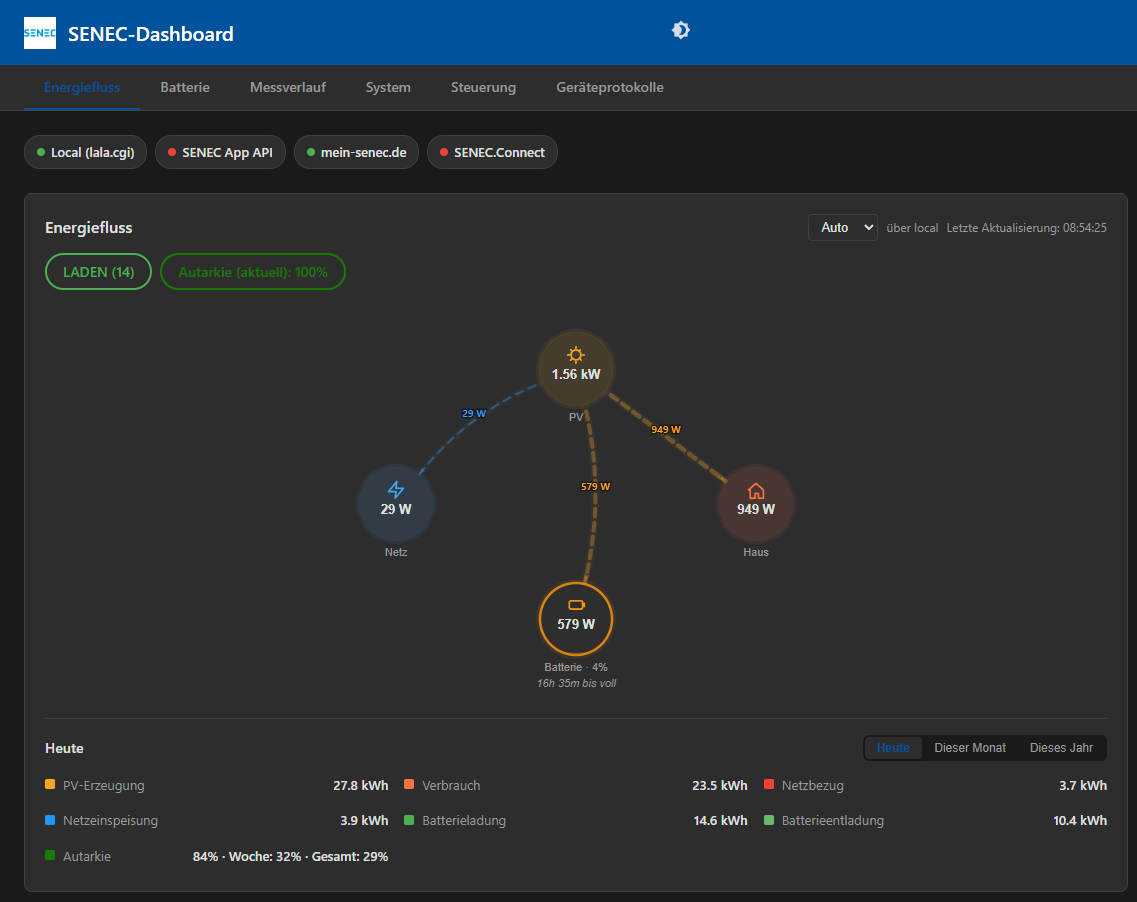

Overview Tab
Energy Flow Diagram — Live SVG visualization showing power flow between PV, battery, grid, house, and wallbox. Animated curved paths with power-proportional thickness. Battery SOC gauge with fill level. Operating mode badge. Time estimates (until empty/full). Period totals (today/month/year) with autarky percentage. Data source selector (Auto/Local/API/Web).
Live Power Curve — Real-time line chart showing power over time for all five metrics (PV, house, grid, battery, wallbox). Smooth monotone cubic interpolation between data points. Time window presets from 10 minutes to 24 hours, plus mouse wheel zoom (5min–30 days, downsampled for performance). Drag to pan through history with lazy loading and midnight date markers. Toggle individual lines, including an optional battery level line (off by default) drawn against its own right-hand 0–100 % axis. Pause/disable controls. Click "Live" to snap back to real-time. If a history adapter (InfluxDB, SQL, or History) is enabled on the power states, the chart backfills with historical data on page load. Each state is resolved on its own, so they may be recorded by different history adapters, and a state without recording only affects its own line. The ⓘ button lists the states behind every line together with the history adapter recording them — use it to find out why a line has no past data.
Event Timeline — Compact 24-hour strip showing today's warnings (orange), errors (red), and panics (purple) from the device log. Hover for full details. Auto-refreshes every 10 minutes. Requires the device IP to be configured.

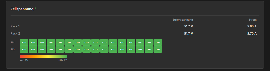

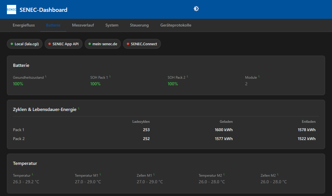

Battery Tab
- State of Health — System and per-pack SOH with color-coded indicators (green > 80%, orange > 60%, red)
- Module Status — Active/charging/discharging module counts
- Charge Cycles — Per-pack cycle count and lifetime charged/discharged energy
- Cell Voltage Heatmap — Color-coded grid showing individual cell voltages across all modules. Red = lowest, green = highest. Per-module delta indicators. Instantly reveals cell imbalance.
- Temperatures — Overall, per-module, and per-cell temperatures
- Pack Electrical — Per-pack voltage and current
Data sourced from Local (BMS) and/or API (SystemDetails) with source badges.

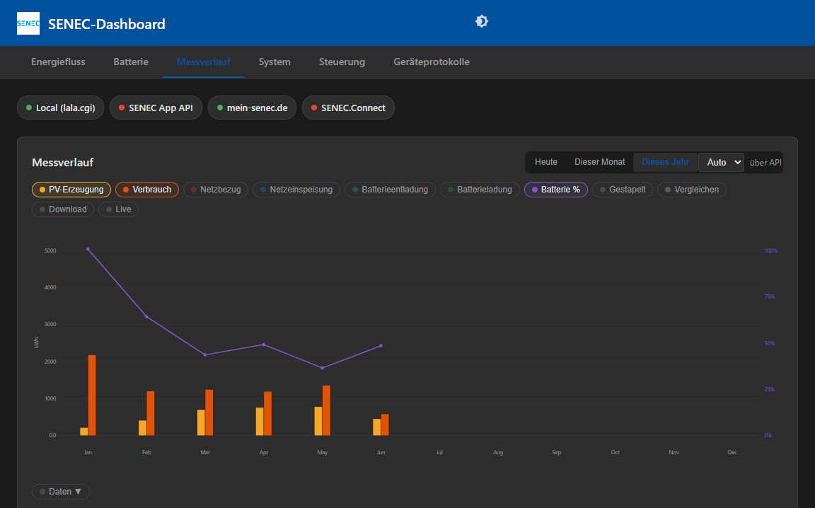

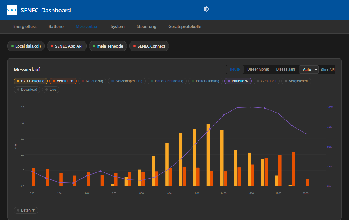

Charts Tab
Measurement bar charts for energy data:
- Today — Hourly bars (auto-trims to hours with data)
- This Month — Daily bars
- This Year — Monthly bars
Features:
- Toggle individual measurement types (PV, consumption, grid import/export, battery charge/discharge)
- Stacked view (production vs. consumption)
- Comparison mode (yesterday, previous month, selectable year)
- Battery level (%) line overlay. The API connector reads it from the measurement history. mein-senec.de offers no such history, so the web connector samples the live charge level instead: hourly averages for the day view, daily averages for the month view. Those values therefore start when the adapter does — a day it was not running over midnight has no daily average, and none can be fetched retroactively. The year view has no battery level on the web connector.
- Data source selector (Auto/API/Web)
- Data table view
- PNG image export
- Auto-update mode

Control Tab
Interactive controls matching the adapter's control capabilities:
- Force battery charging (toggle)
- Appliance reboot (with confirmation dialog)
- Emergency power reserve (percentage slider)
- Peak shaving (mode-dependent fields)
- SG-Ready (enable + thresholds)
- Switchable sockets (per-socket mode, threshold settings, name editing)
- Wallbox (smart charge, current limit)
Controls check connector availability and show warnings if the required connector is not active. Apply button provides "Sent" confirmation feedback.

External States (_external.*)
External source data is stored under _external.{type}.{index}.*:
| State | Description |
_external.pv.{n}.power | External PV power (W) |
_external.consumer.{n}.power | External consumer power (W) |
_external.battery.{n}.power | External battery power (W, signed) |
_external.battery.{n}.soc | External battery state of charge (%) |
_external.battery.{n}.capacity | External battery capacity (kWh) |
_external.{type}.{n}.label | User-defined label |
_external.{type}.{n}.mode | Display mode (integrate/separate) |
_external.{type}.{n}.sourceId | Foreign state ID or formula |
Control States (control.*)
Writable states for appliance control:
| State | Type | Description |
control.ForceCharge | boolean | Force battery charging on/off |
control.BlockDischarge | boolean | Block battery discharge on/off |
control.RebootAppliance | boolean | Trigger appliance reboot |
control.EmergencyPower.ReserveInPercent | number | Emergency power reserve (%) |
control.PeakShaving.* | various | Peak shaving settings |
control.SGReady.* | various | SG-Ready settings |
control.Sockets.{n}.* | various | Per-socket control |
control.Wallbox.{n}.* | various | Wallbox control |
Control states are only created when the corresponding feature is enabled and available via the configured connector.
