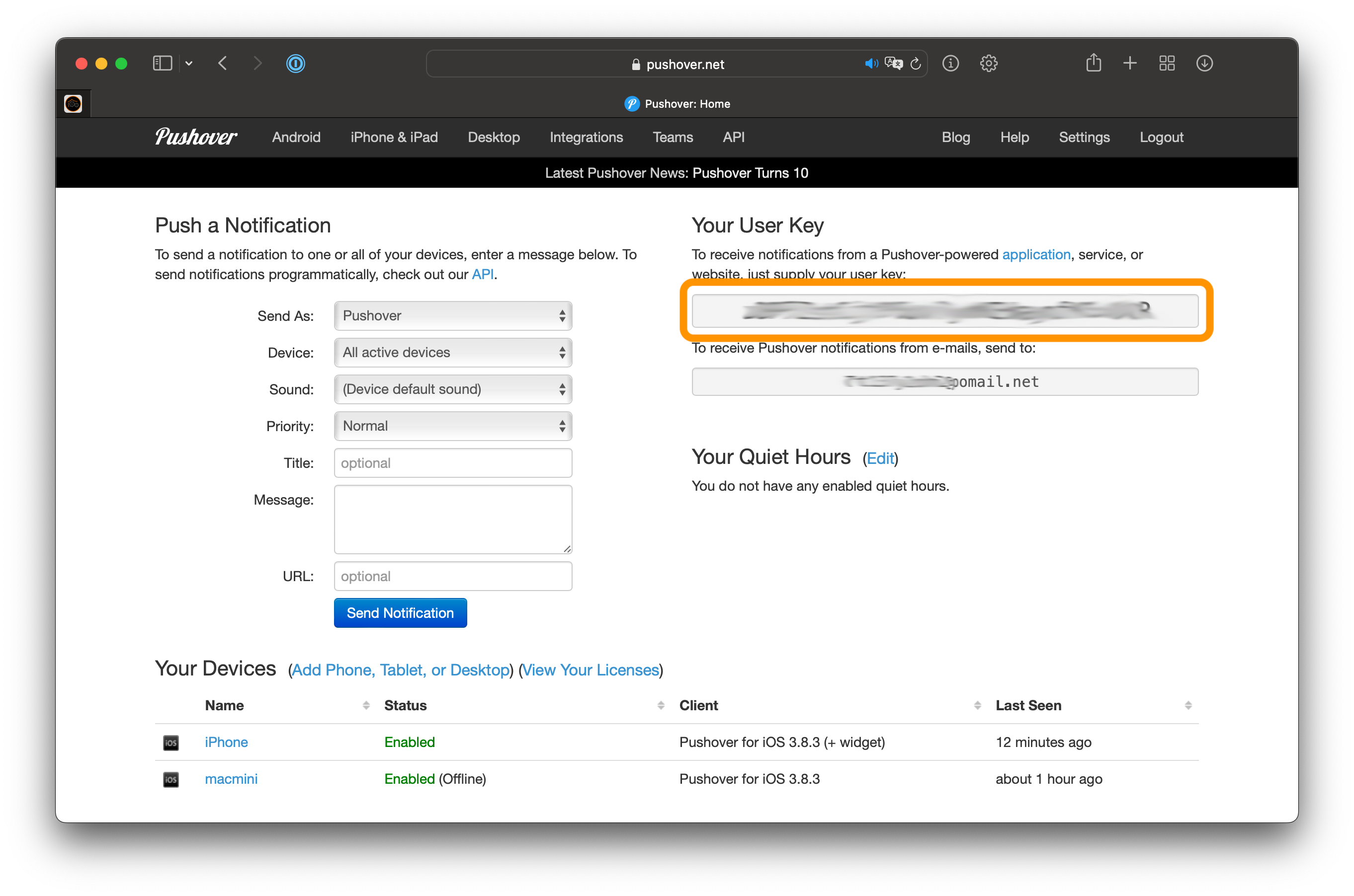

  1. Create a new account on pushover.net

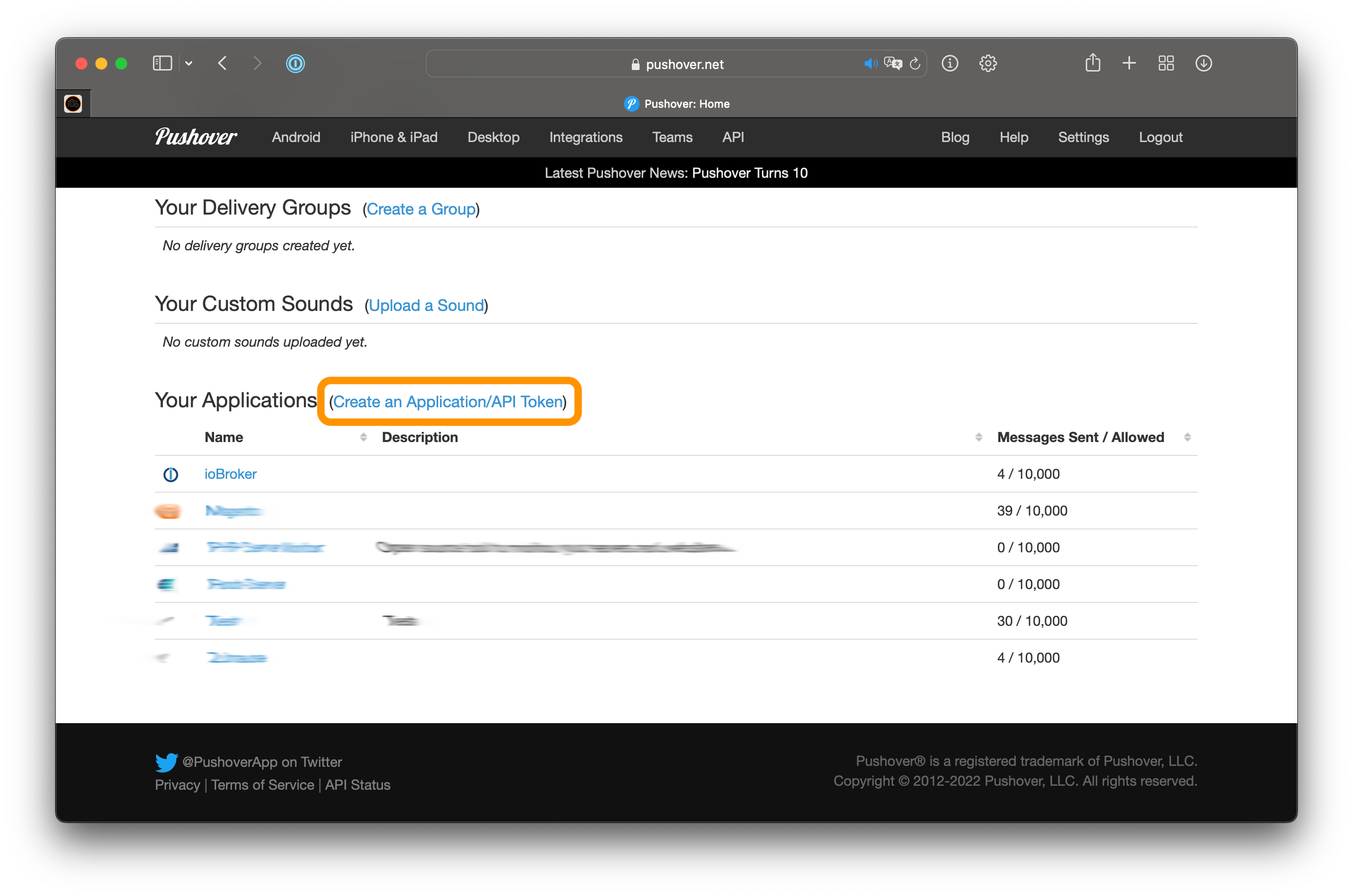

  2. Create a new application

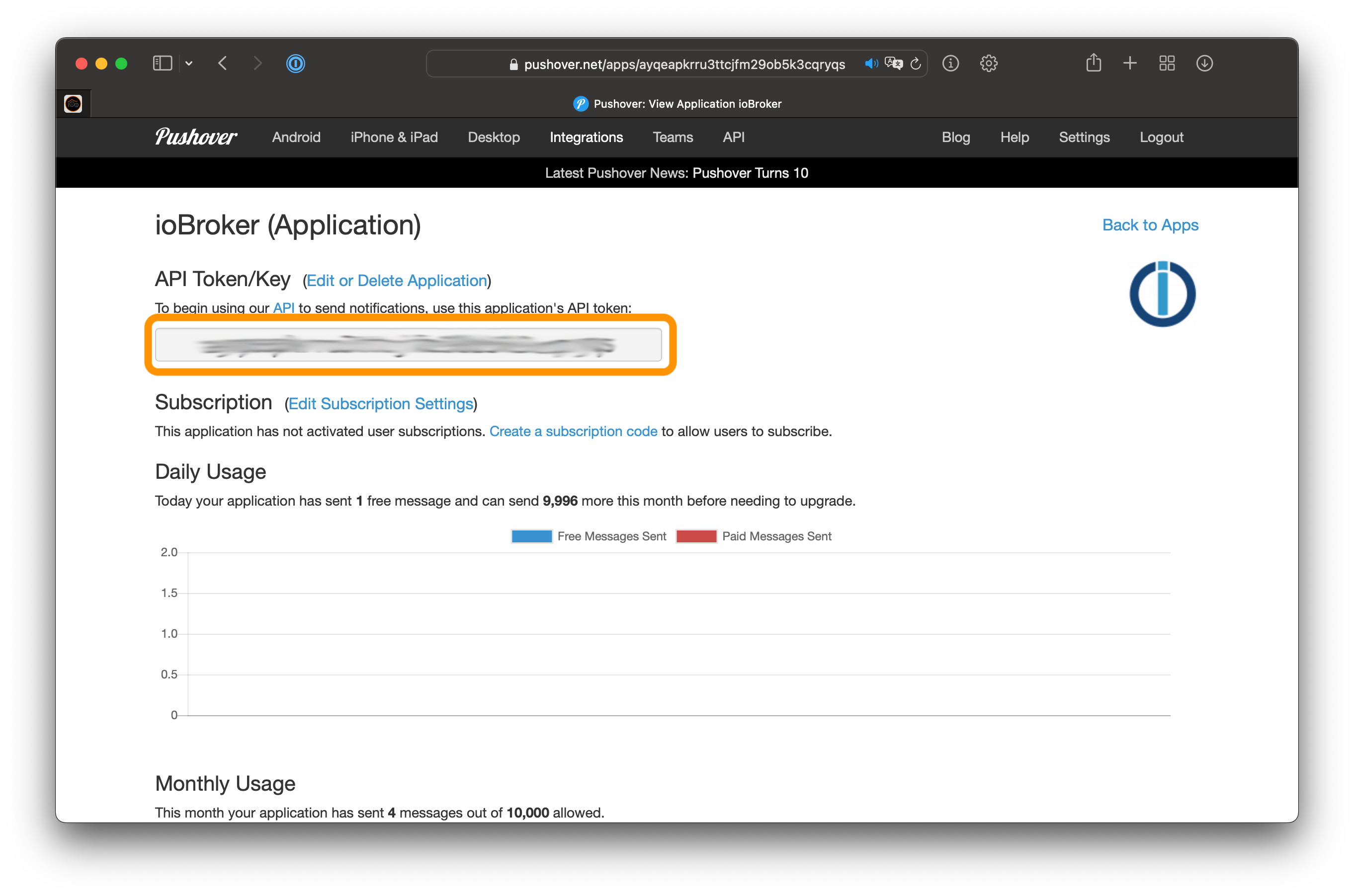

  3. Configure the application token and user token in your pushover instance
Pushover configuration
API Token
Group or User Token
