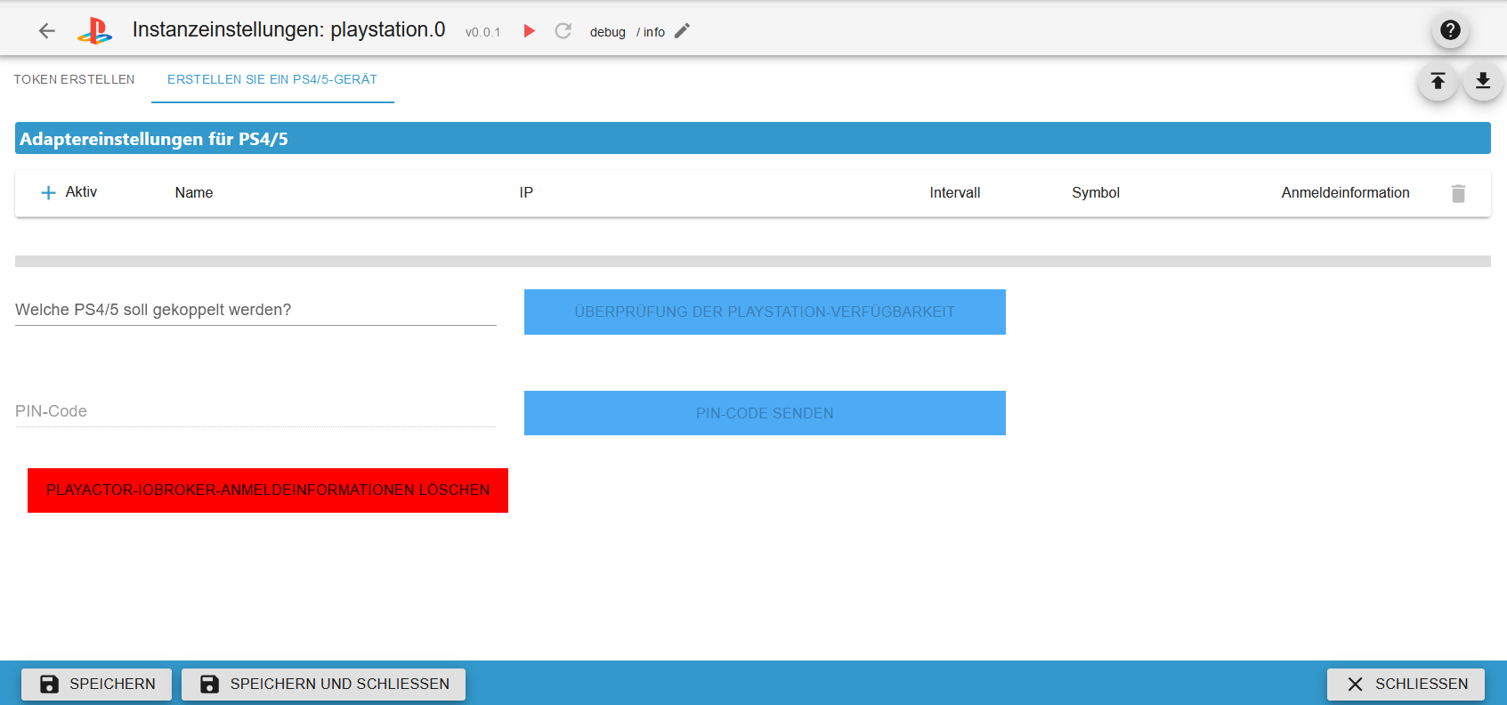

Summary

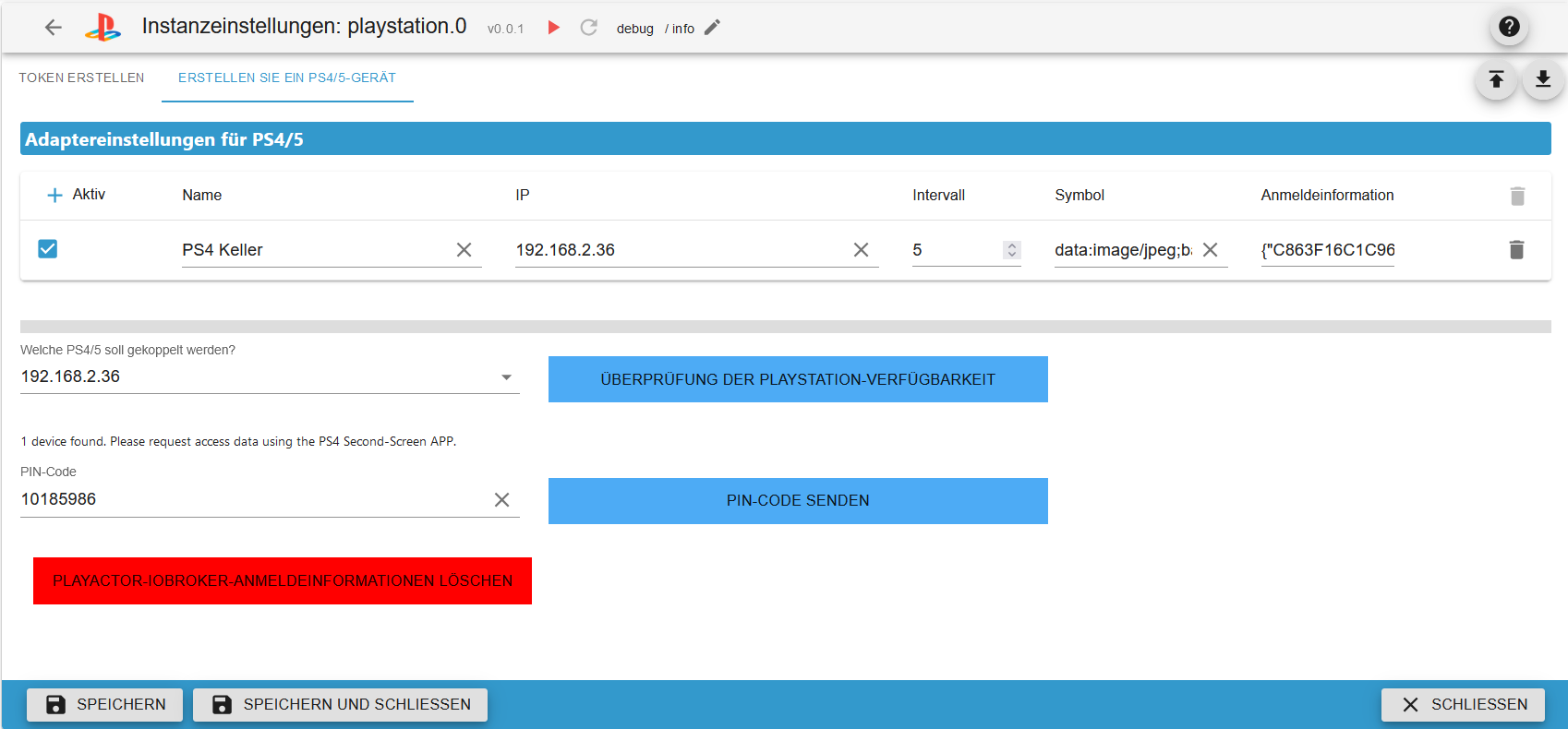

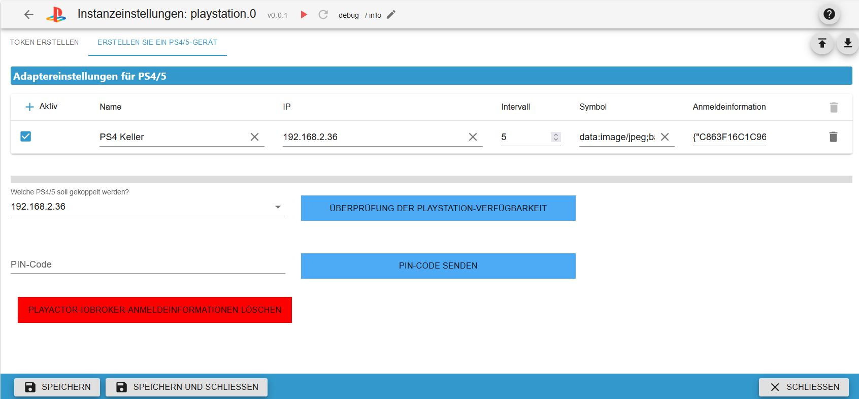

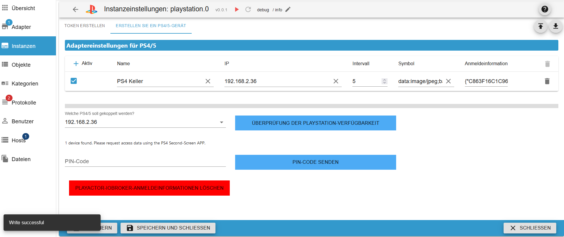

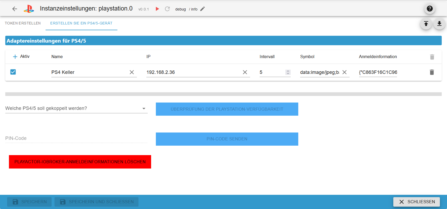

Instance Settings
Instance Settings TAB > Create Device
Summary
  • Active Activate/deactivate local control
  • Name Name of the device
  • IP The fixed IP of the device
  • Interval Interval in seconds (5/3600) to query the status
  • Icon Icon for the object device as a base64 image
  • Credential Will be set automatically with the login data for playactor-iobroker
  • Which PS4/5 to pair? Select the IP of the device to be paired
  • Playstation availability check The Playstation is searched for. A pop-up with OK or an error message follows
  • Starts UDP server Start the UDP server to receive the access data for the PS4 Second Screen APP
  • Pincode Enter the pin code from the device
  • Pincode submit Send the pin code

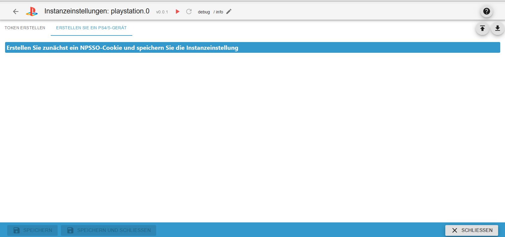

Instance Settings TAB > Create Token
Summary

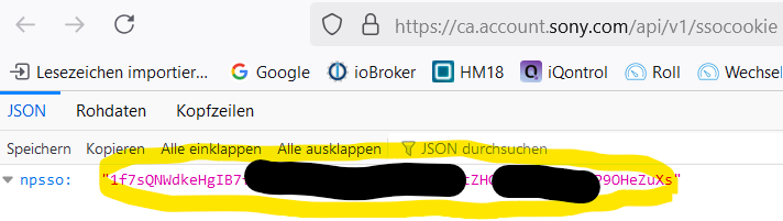

  • 1. Please login to PSN here Click and log in
  • 2. Link to NPSSO (must be renewed every 2 months) After logging in, click this link and copy the NPSSO cookie
  • NPSSO cookie Paste NPSSO cookie here
  • Delete session data If you have problems logging in, delete the current session
  • Language The language from the PSN account
  • Activate Playstation Stars Create remote control objects for Playstation Stars (Must be activated in the PS profile)
Login
Login PSN (Playsatation Network)
Summary
  1. Click on the link and log in to Playstation Network
  2. Now click on this link and copy the NPSSO
  3. Insert this cookie into NPSSO-Cookie and save the instance settings. This cookie should only be valid for 2 months.

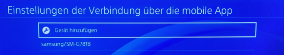

Login Playstation Device
Summary
First perform step 1

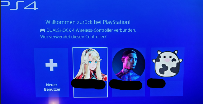

  1. (Router) Assign a fixed IP to the Playstation (please use Google)
  2. (PS) Turn on the Playstation and select the profile

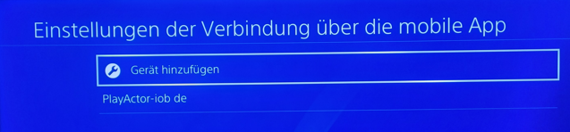

  3. (PS) Open settings
  4. (PS) Mobile App Connection Settings
  5. (ioBroker) Open instance setting of the playstation adapter
  6. (ioBroker) Create a device and enter the IP of the Playstation under "IP"
  7. (ioBroker) Select the IP in Which PS4/5 to pair?
  8. (ioBroker) Press Button Playstation availability check. A message and a popup with ok or an error message will appear

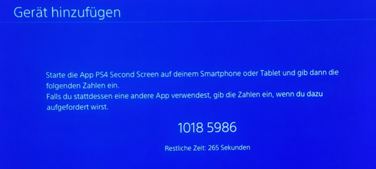

  9. (PS) Press Add Device (a PIN appears)
  10. (ioBroker) Enter the PIN in Pincode
  11. (ioBroker) Press Button Pincode submit. A popup with ok or an error message appears
  12. (PS) PIN should now no longer be visible and the name playactor-iob is visible
  13. (ioBroker) Save instance settings
  14. (ioBroker) If an error message appears, please repeat the process from point 9

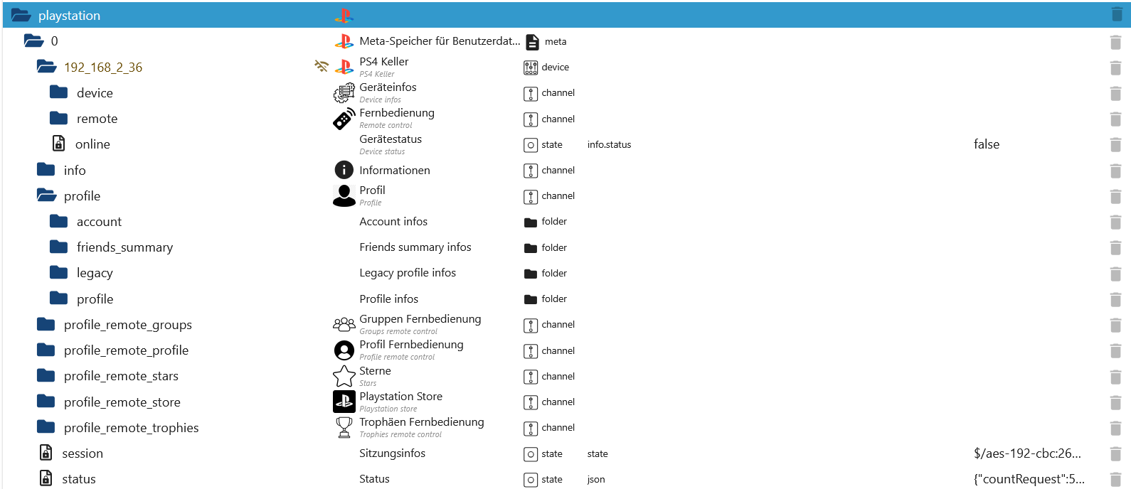

Objects
Objects remote
Summary
To use keys you must first press the ps key. The keys do not work in games!
  • playstation.0.192_168_2_36.remote.back back key
  • playstation.0.192_168_2_36.remote.down down key
  • playstation.0.192_168_2_36.remote.enter enter key
  • playstation.0.192_168_2_36.remote.left left key
  • playstation.0.192_168_2_36.remote.option option key
  • playstation.0.192_168_2_36.remote.osk send on-screen keyboard
  • playstation.0.192_168_2_36.remote.ownCommand own commands (back down etc) or multiple with delay (back:200 down:200)
  • playstation.0.192_168_2_36.remote.ps PS key to activate remote control of the other keys
  • playstation.0.192_168_2_36.remote.right Right key
  • playstation.0.192_168_2_36.remote.standby Put devices into standby
  • playstation.0.192_168_2_36.remote.startGame Start game (e.g. Fortnite) Case sensitive
  • playstation.0.192_168_2_36.remote.up Up key
  • playstation.0.192_168_2_36.remote.wakeup Wake up devices

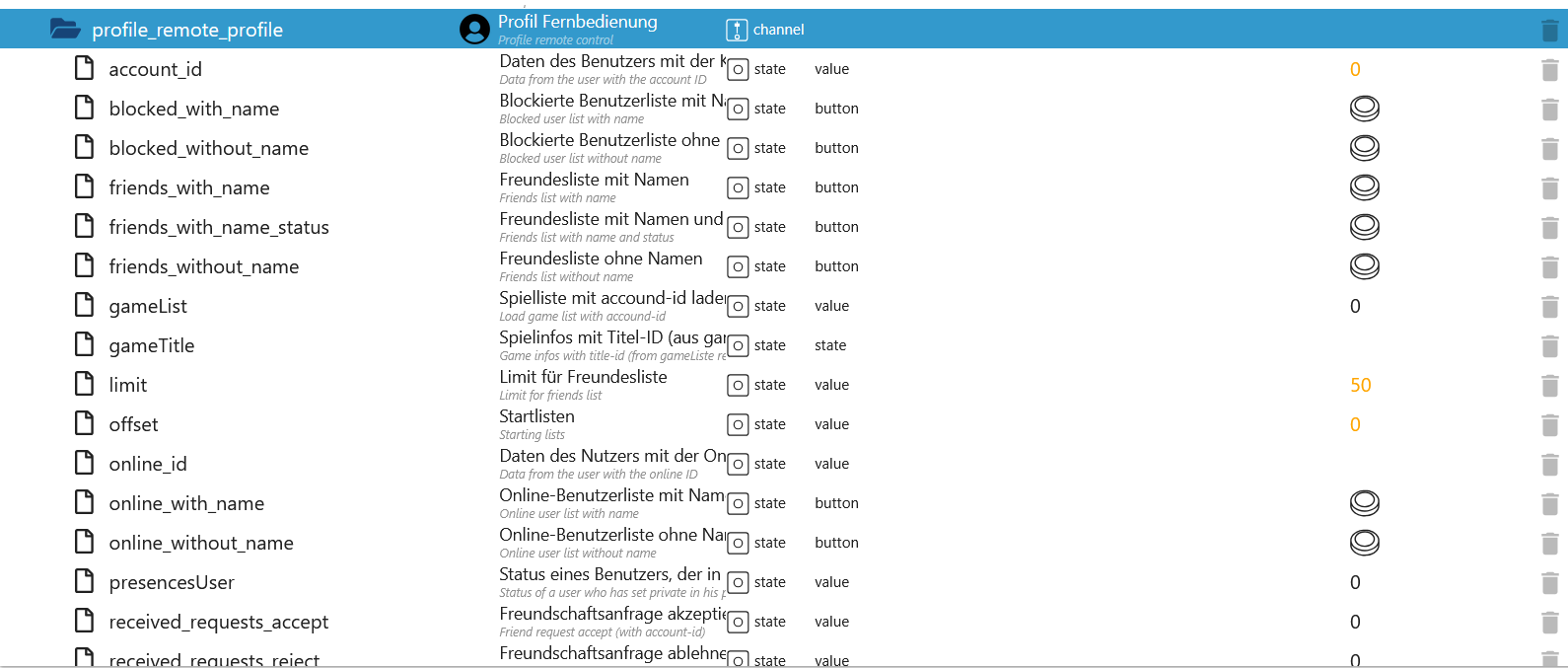

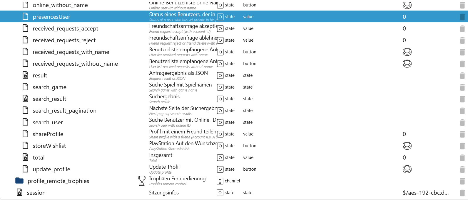

Objects remote_profile
Summary
Account-ID: User number Online-ID: Nickname
ObjectDescriptionExample
playstation.0.profile_remote_profile.account_idDisplay information of a user with the account ID (Result in state result)Example
playstation.0.profile_remote_profile.blocked_with_nameBlocked users with name as array JSON (account-id and online-id)Result unknown
playstation.0.profile_remote_profile.blocked_without_nameBlocked users as array JSON (account-id and online-id)Result unknown
playstation.0.profile_remote_profile.friends_with_nameList of friends as array JSON (account-id and online-id)Example
playstation.0.profile_remote_profile.friends_with_name_statusList of friends with status infos as array JSON (account-id and online-id)Example
playstation.0.profile_remote_profile.friends_without_nameList of friends as array (account-id)Example
playstation.0.profile_remote_profile.gameListGame list of a user with the account-ID as JSONExample
playstation.0.profile_remote_profile.gameTitleGame info with the title ID as JSONExample
playstation.0.profile_remote_profile.limitLimit for inviting friends.
playstation.0.profile_remote_profile.offsetOffset for loading members and info
playstation.0.profile_remote_profile.online_idOutput information about a user with the online ID (result in state result)Example
playstation.0.profile_remote_profile.online_with_nameNotify me when available subscription list as array JSON (account id and online id)Result unknown
playstation.0.profile_remote_profile.online_without_nameNotify me when available subscription list as array (account id)Result unknown
playstation.0.profile_remote_profile.presencesUserQuery the status of a user with the account ID (if the user has set PRIVATE)Example
playstation.0.profile_remote_profile.received_requests_acceptFriend request accept (with account-id)
playstation.0.profile_remote_profile.received_requests_rejectFriend request reject or friend delete (with account-id)
playstation.0.profile_remote_profile.received_requests_with_nameFriend requests with online ID as JSONExample
playstation.0.profile_remote_profile.received_requests_without_nameFriend requests without online ID as JSONExample
playstation.0.profile_remote.resultResult of all requests
playstation.0.profile_remote_profile.search_gameSearch game. Maximum 15 games as JSON. For further displays then use the selection from the state playstation.0.profile_remote_profile.search_result_paginationExample
playstation.0.profile_remote_profile.search_resultResult of all search requests
playstation.0.profile_remote_profile.search_result_paginationShow another 15 games/users
playstation.0.profile_remote_profile.search_userSearch users. Maximum 15 users as JSON. For further displays then use the selection from the state playstation.0.profile_remote_profile.search_result_paginationExample
playstation.0.profile_remote_profile.shareProfileShare profile with a friend (Account ID). A link to a QRcode is created.
playstation.0.profile_remote_profile.storeWishlistWishlistExample
playstation.0.profile_remote_profile.totalTotal of the current query
playstation.0.profile_remote_profile.update_profileUpdate your profile (automatically only updates every hour)

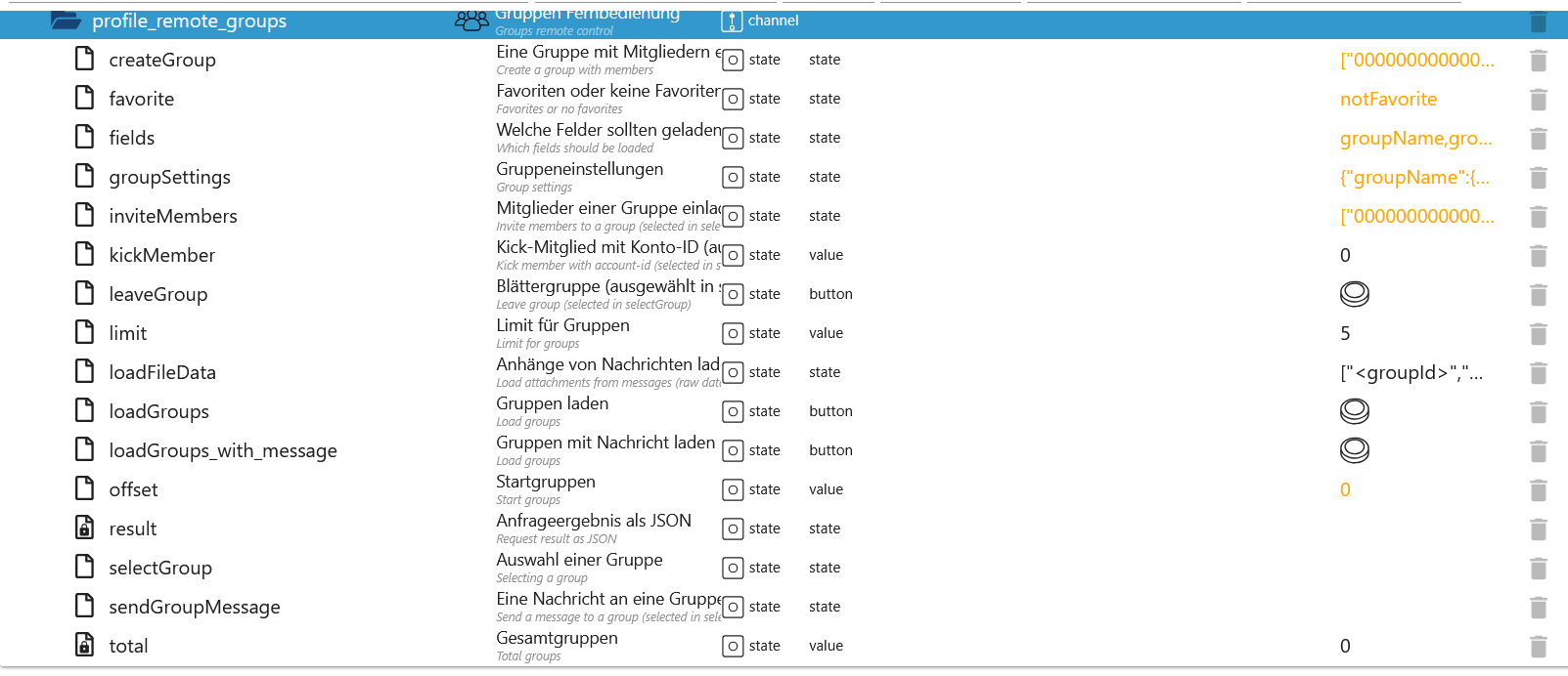

Objects remote_groups
Summary
Account-ID: Nummer des Benutzer Online-ID: Nickname
playstation.0.profile_remote_groups.createGroupCreate a group with members (members' account ID as an array)Example
playstation.0.profile_remote_groups.favoriteLoading the Favorites/No Favorites groups (all)
playstation.0.profile_remote_groups.fieldsWhich fields should be loaded
playstation.0.profile_remote_groups.groupSettingsSetting the group (a group must be selected under selectGroup and 3 members required)Result unknown
playstation.0.profile_remote_groups.inviteMembersAdd members in a group (members' account ID as an array - a group must be selected under selectGroup)Result unknown
playstation.0.profile_remote_groups.kickMemberRemove a member from a group using Account ID (A group must be selected under selectGroup)Result unknown
playstation.0.profile_remote_groups.leaveGroupLeaving a group (A group must be selected under selectGroup)Result unknown
playstation.0.profile_remote_groups.limitLimit for groups or messages that should be loaded (see example under profile)
playstation.0.profile_remote_groups.loadFileDataLoad attachments from messages (raw data)Example
playstation.0.profile_remote_groups.loadGroupsLoad groupsExample
playstation.0.profile_remote_groups.loadGroups_with_messageLoad groups with messages (see example under profile)Example
playstation.0.profile_remote_groups.offsetGroup loading offset
playstation.0.profile_remote_groups.resultLoad result of groups or groups with messages as JSON
playstation.0.profile_remote_groups.selectGroupGroup ID from result groups or load groups with messages. When you select a group, the messages are loadedExample
playstation.0.profile_remote_groups.sendGroupMessageSend message to a selected group (A group must be selected under selectGroup)Example
playstation.0.profile_remote_groups.totalNumber of all possible groups or messages (important for limit and offset)
