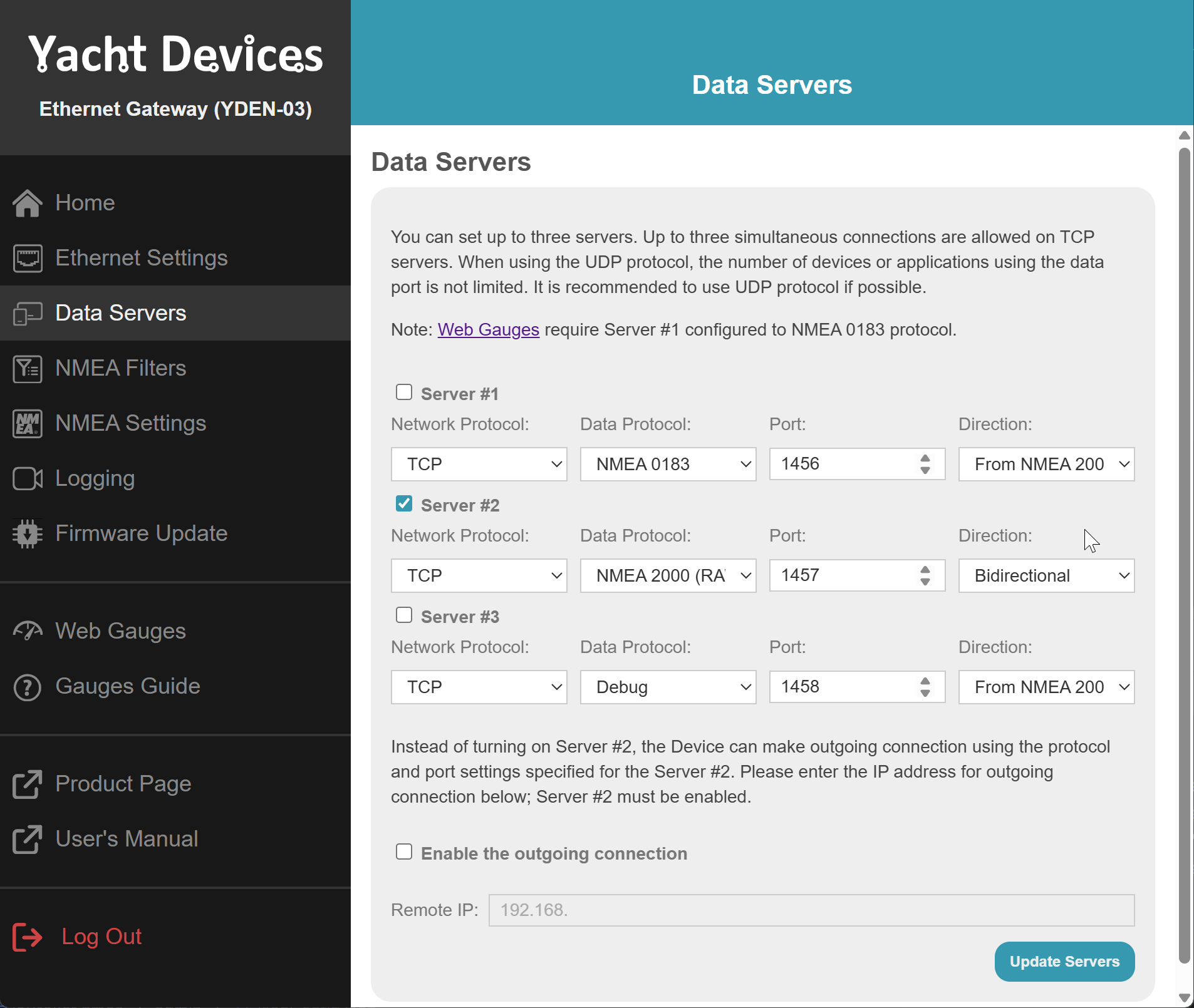

YDEN, YDWG
Enable server N2 with TCP protocol and bidirectional mode.
YDWG
UDP could work too, but the gateway sends the data into the network continuously, so the bus could be overloaded.

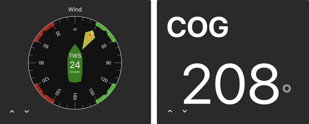

Wind datum display
For Raymarine units that publish the "Pilot Wind Datum" (PGN 65345), the adapter stores the raw angle in radians under seatalkPilotWindDatum.windDatum (this is the canonical value the autopilot reads back when you change the wind angle, so it must stay in radians).
In addition, a read-only convenience state seatalkPilotWindDatum.windDatumDisplay is created. It shows the angle exactly the way the Raymarine pilot head does:
  • 0…180° → starboard, 180…360° → port,
  • each as a ≤180° value plus a language-dependent side letter (e.g. a datum of 230° is shown as 130°P in English and 130°B in German). (dead ahead) and 180° (dead astern) carry no side letter.
Use windDatumDisplay for visualization and windDatum for calculations/automation.
