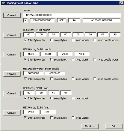

The Importance of Byte Order
Modbus itself does not define a floating point data type, but it is widely accepted that it implements 32-bit floating point data using the IEEE-754 standard. However, the IEEE standard has no clear definition of the byte order of the data payload. Therefore, the most important consideration when dealing with 32-bit data is that data is addressed in the proper order.
For example, the number 123/456.00 as defined in the IEEE 754 standard for single-precision 32-bit floating point numbers appears as follows:
The effects of various byte orderings are significant. For example, ordering the 4 bytes of data that represent 123456.00 in a B A D C sequence in known as a “byte swap”. When interpreted as an IEEE 744 floating point data type, the result is quite different:
Ordering the same bytes in a “C D A B” sequence is known as a “word swap”. Again, the results differ drastically from the original value of 123456.00:
Furthermore, both a byte swap and a word swap would essentially reverse the sequence of the bytes altogether to produce yet another result:
Clearly, when using network protocols such as Modbus, strict attention must be paid to how bytes of memory are ordered when they are transmitted, also known as the ‘byte order’.

Notice that different byte and word orderings require the use of the appropriate FieldServer function move. Once the proper function move is selected, the data can be converted in both directions.
Of the many hex-to-floating point converters and calculators that are available on the Internet, very few actually allow manipulation of the byte and word orders. One such utility is located at www.61131.com/download.htm where both Linux and Windows versions of the utilities can be downloaded. Once installed, the utility is run as an executable with a single dialog interface. The utility presents the decimal float value of 123456.00 as follows:
One can then swap bytes and/or words to analyze what potential endianness issues may exist between Modbus RTU master and slave devices.
