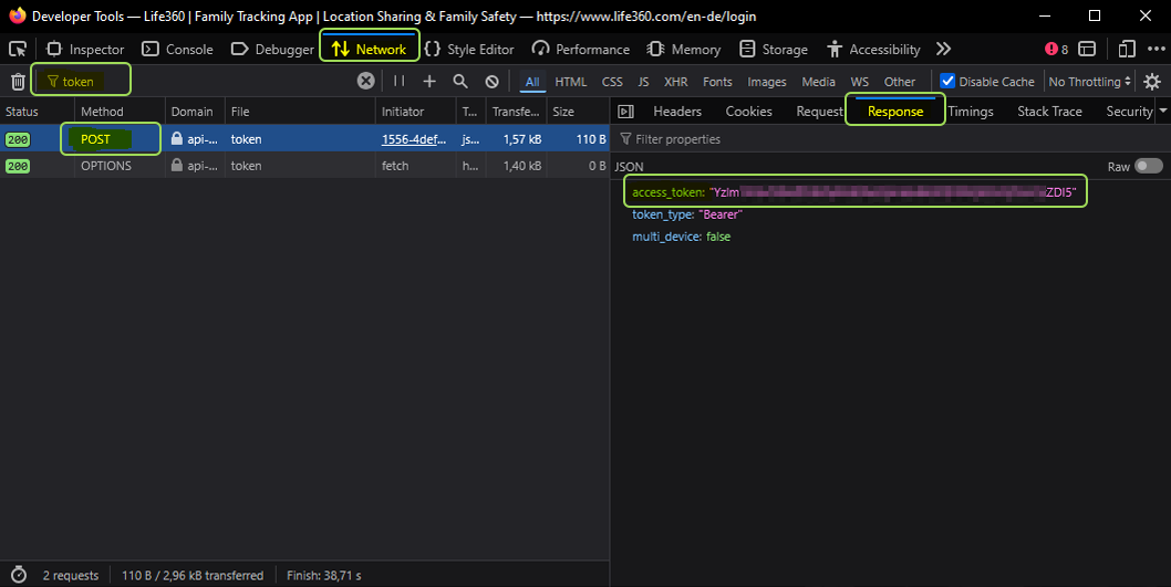

Bearer Token (required for EU users)
Life360 has disabled password-based login for EU users. Obtain a Bearer token manually:
- Open https://life360.com/login in your browser.
- Open browser DevTools (F12) and switch to the Network tab.
- Enter your email address and click Continue.
- Enter the one-time code sent to your email.
- Find the POST request named
token(ignore OPTIONS). - In Preview / Response, copy the value of
access_token. - Paste it into the Bearer token field in the adapter configuration.
Note: Enter the token WITHOUT the word 'Bearer', WITHOUT spaces and WITHOUT quotation marks!!
Note: Tokens are long-lived (typically months). When expired, the adapter log will show a connection error — repeat the steps above to get a new token.
