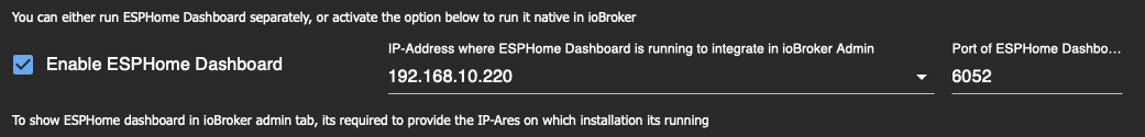

ESPHome Dashboard Integration (Optional)
This adapter can optionally integrate the ESPHome Dashboard into ioBroker's admin interface. You have several options:
Option 1: Built-in Dashboard (Recommended for beginners)
  • Enable "Native Integration of ESPHome Dashboard" in adapter settings
  • Uses integrated Python environment (no external setup required)
  • Dashboard runs on port 6052 by default
  • Set Dashboard IP to 127.0.0.1:6052 for admin integration

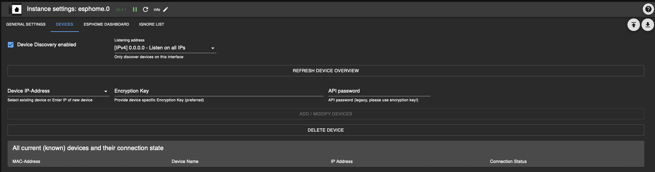

The device Tab will show all current known devices; you can either wait for Devices to be autodetect (currently disabled, see #175) or add them manually by providing their IP-Address and credentials
DevicesTab
[!NOTE] Buttons to add/modify/remove devices and load device table are only available if adapter is running! You must refresh the device table manually by pressing "Refresh device Overview", all devices and their connection state will be shown
Please enter IP-Address (if a device is already known, you can select it from the dropdown) and choose the proper actions:
  • ADD / Modify Devices
    • Will send IP address and credentials to the backend and try to establish a connection
    • When an encryption Key is provided, API-Password is ignored, please ensure proper YAML configuration!

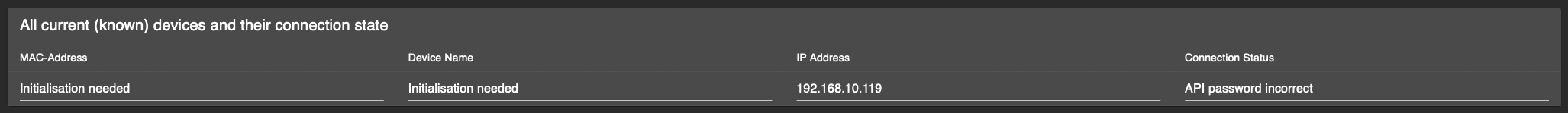

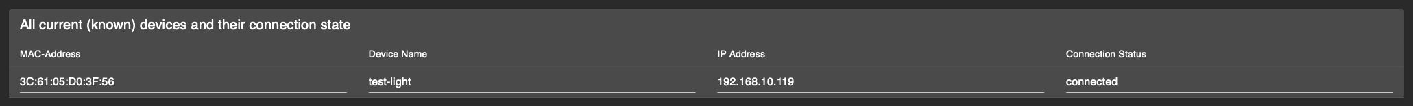

[!NOTE] After a device has been added, a message will be indicated if successfully or error, you can refresh the table to show current devices and their connection status
DevicesError DevicesOK

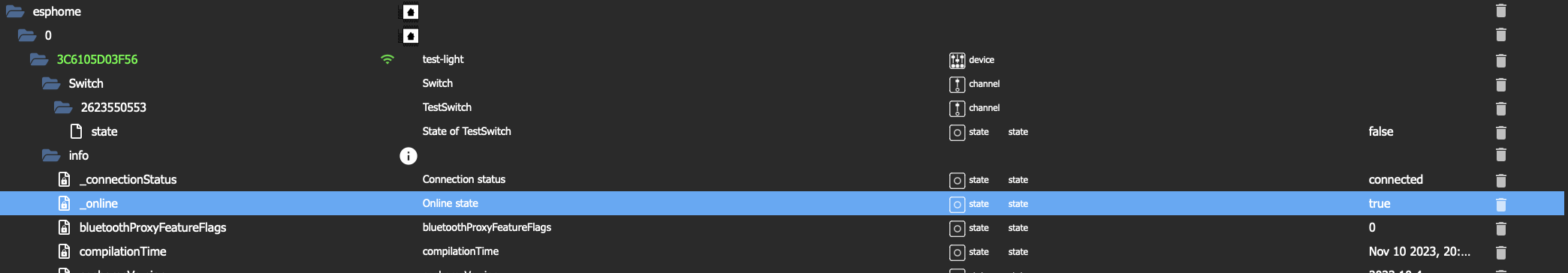

If connection was successfully, the Device will be initiated and all related states created to control their attributes.
When making any changes to your YAML configuration, reboot of the ESP will disconnect and initiate a new connection.
During this process, states not part anymore of YAML configuration will be automatically removed.
