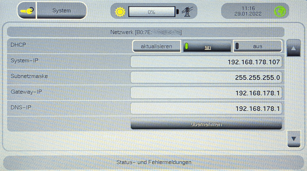

E3/DC IP address Address in your local network, like 192.168.178.107
ioBroker.discovery (from 2.8.0) is able to detect E3/DC devices using uPnP.
You can also check the IP on your E3/DC screen, it's called "System-IP":

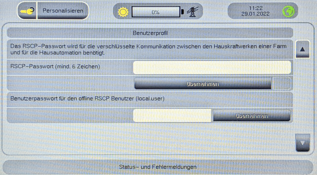

RSCP Password RSCP-Password, as entered locally at your E3/DC station:
