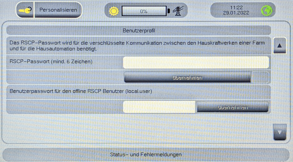

RSCP Password RSCP-Password, as entered locally at your E3/DC station:
