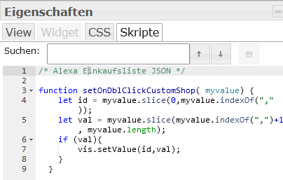

The JSON contains now 2 Buttons to move Items or to delete. For this you have to insert Code in the VIS Editor under Skript, put this in:
 /* Alexa Einkaufsliste JSON */
function setOnDblClickCustomShop( myvalue) {
    let id = myvalue.slice(0,myvalue.indexOf(","));
    let val = myvalue.slice(myvalue.indexOf(",")+1, myvalue.length);
    if (val=== "true"){
      vis.setValue(id,true);
      return
    vis.setValue(id,false);
