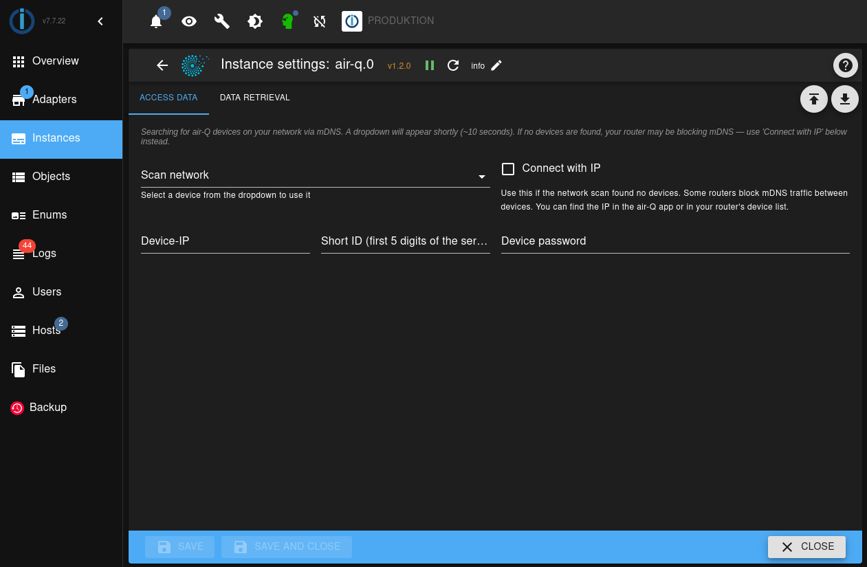

Configuration
Configuration
Finding your air-Q device
The adapter can automatically discover air-Q devices on your local network using mDNS (Bonjour). When you open the instance settings, the Scan network dropdown will search for devices (~10 seconds) and list all found air-Q devices by name. Select your device and the Short ID and IP address will be filled in automatically.
If no devices are found, your router may be blocking mDNS traffic between devices (common with mesh networks, guest networks, or enterprise setups). In that case, check the Connect with IP checkbox and enter the device's IP address manually. You can find the IP in the air-Q smartphone app or in your router's device list.
You can also configure the adapter via ioBroker.discovery: run a network scan from the discovery adapter and air-Q devices will be detected automatically via DNS or HTTP.
Connection options
  • Scan network: Automatically discovers air-Q devices via mDNS. Select a device to auto-fill the Short ID and IP address.
  • Connect with IP: Connect directly using the device's IP address. Use this when mDNS discovery doesn't work on your network.
  • Short ID: The first 5 characters of your device's serial number. Used for mDNS lookup when "Connect with IP" is unchecked.
  • Device password: The password of your air-Q device.
Optional
  • Respect device night mode. Default: on. When your air-Q device has night mode enabled with WiFi disabled during the night hours, the adapter can automatically skip polling attempts during those hours. This eliminates unnecessary connection errors in your logs. ⚠️ If you change your device's night mode settings (start/end times, enable/disable), you have two options:
    1. (Recommended): Restart the adapter to immediately load the new configuration
    2. (Automatic): Wait up to 1 hour for the adapter to automatically refresh the configuration (only works outside of night mode hours)
  • Clip negative values. Default: off. For baseline calibration purposes, certain sensor values may briefly become negative. You can safely clip such values to 0.
  • Poll data every x seconds. Default: 10. You can configure how often the data should be polled by entering the number in seconds.
  • Retrieve data type. Default: Average data. In its default configuration, air-Q averages the stream of sensor values. This adapter allows to switch between polling the averaged and the raw data from the device. To poll noisy sensor readings from the device, select Realtime data from the drop-down menu.
Now you should be all set up and good to go!
