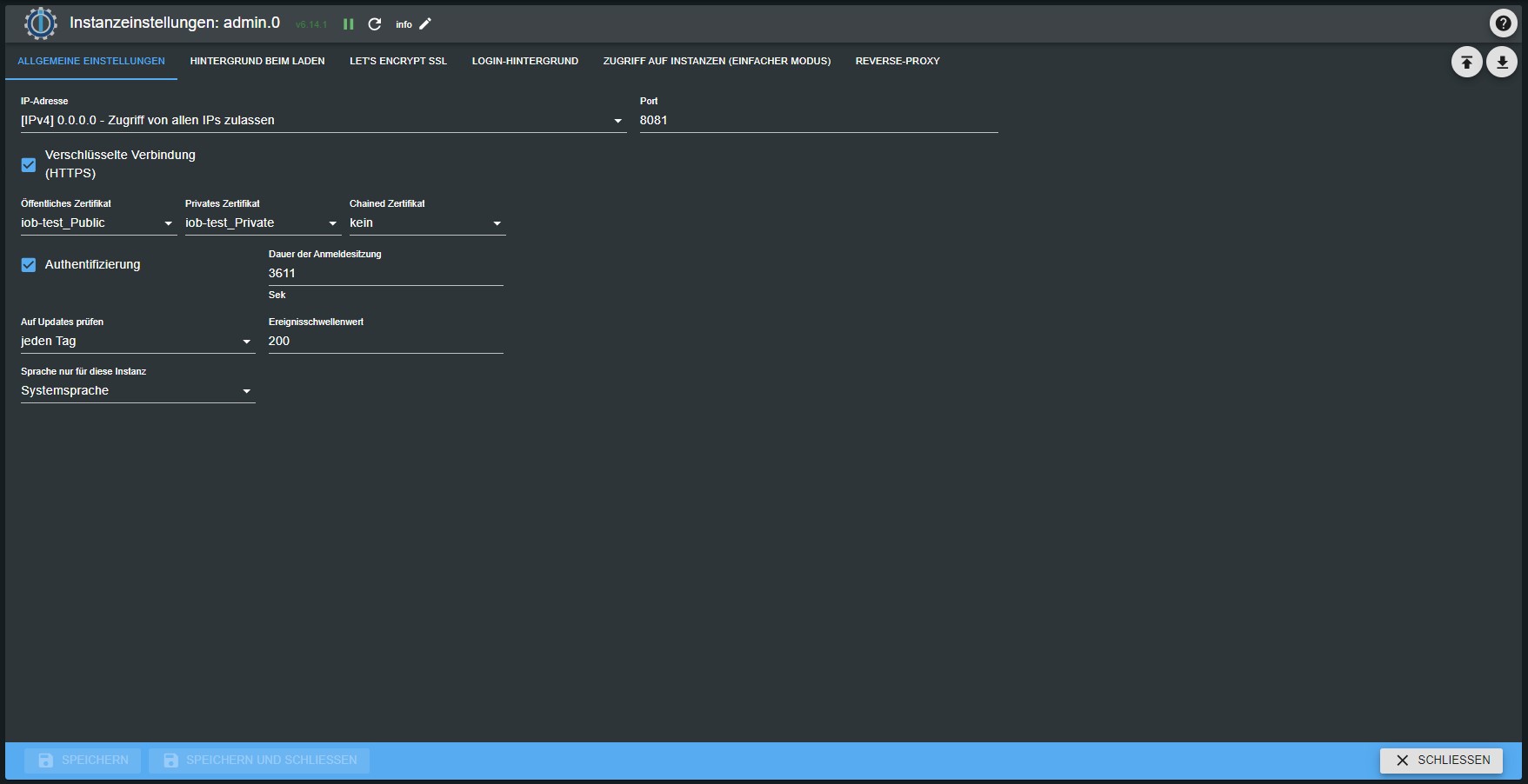

The configuration dialog of the adapter "admin" provides the following settings:
img_002
IP: the IP-address of the "admin" web-server can be chosen here. Different IPv4 and IPv6 addresses can be selected. The default value is 0.0.0.0. If you think, that 0.0.0.0 is invalid setting, please let it stay there, because it is absolutely valid. If you change the address, you will be able to reach the web-server only through this address. Port: You can specify the port of the "admin" web-server. If there are more web servers on the PC or device the port must be customized to avoid problems of a double port allocation. Coding: enable this option if secure https protocol should be used.
Authentication: If you want the authentication with login/password you should enable this check-box. Default password for user "admin" is "iobroker" Buffer: to speed up the load of the pages enable this option. Normally only the developer wants to have this option unchecked.

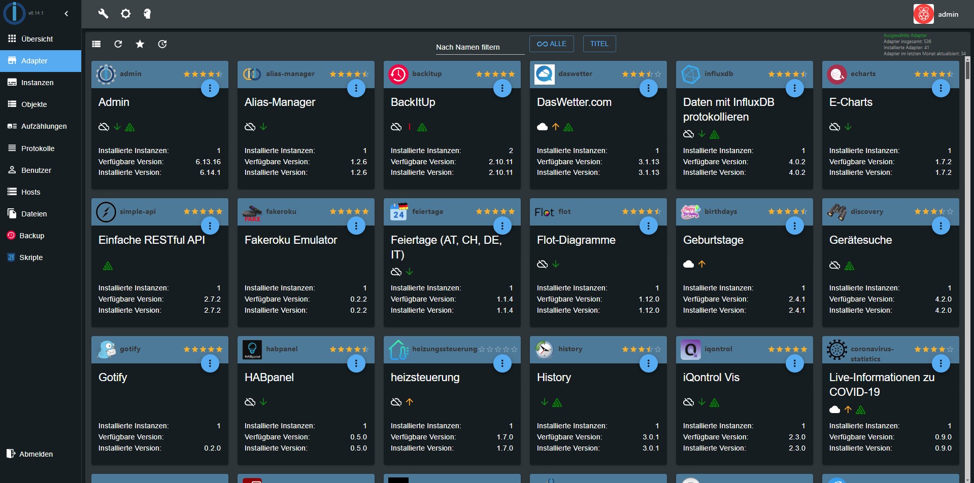

The main page of the admin consist of several tabs. Adapter: Here the instances of a adapters can be installed or deleted. With the update button
img_005
on the top left we can get if the new versions of adapters are available.
img_001
The available and installed versions of the adapter is shown. For overall view the state of the adapter is coloured (red=in planning; orange=alpha; yellow=beta). The updates to a newer version of the adapter are made here also. If there is a newer version the lettering of the tab will be green. If the question mark icon in the last column is active you can get from there to web site with information of the adapter. The available adapter are sorted in alphabetical order. Already installed instance are in the upper part of the list.

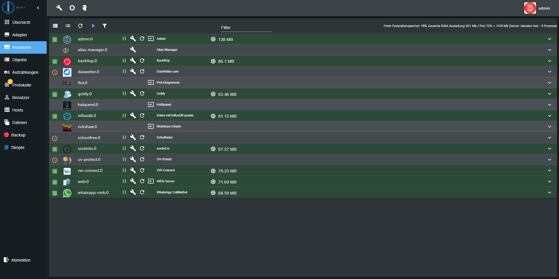

Instance: The already installed instance are listed here and can be accordingly configured. If the title of the instance are underlined you can click on it and the corresponding web site will be opened.
img_003

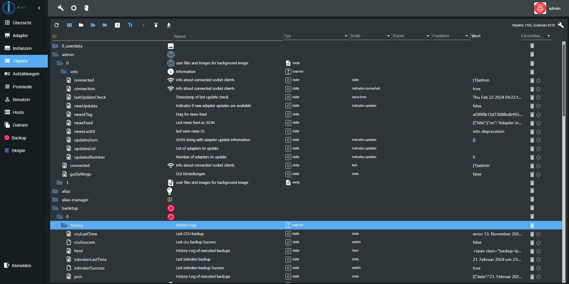

Objects: the managed objects (for example setup / variables / programs of the connected hardware)
img_004
States: the current states (values of the objects)   If the adapter history is installed, you can log chosen data points. The logged data points are selected on the right and appear with a green logo.

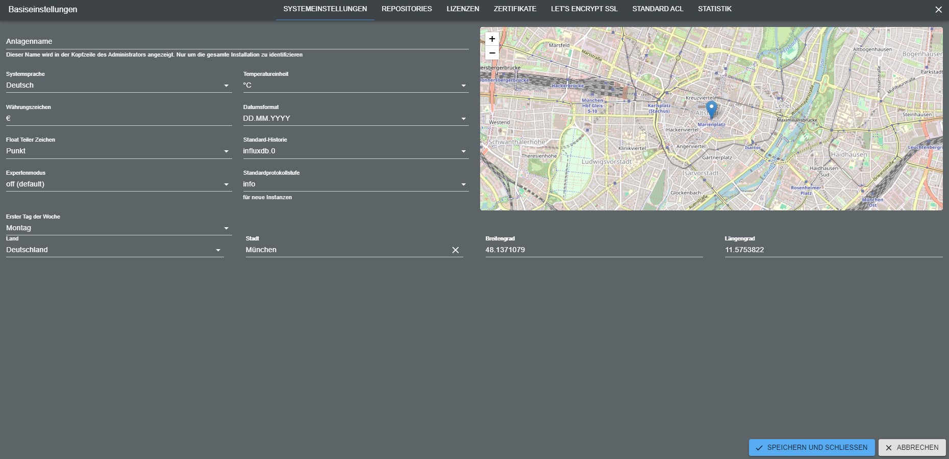

System settings: Settings such as language, time and date format and other system-wide settings are made in the menu that opens here.
img_006
The repositories and security settings can also be set here.
