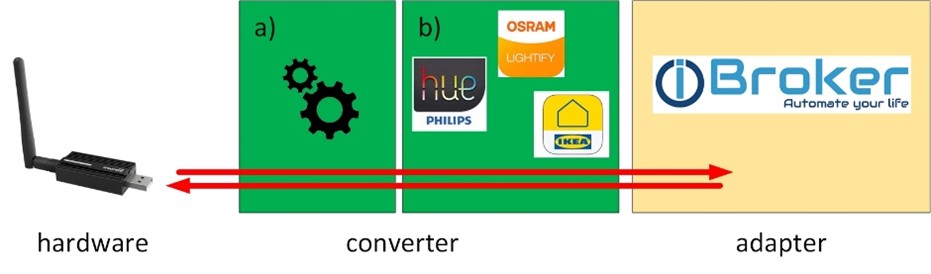

The software is divided into "converter" and "adapter".
  • Converter The converter is divided into two parts:
    a) General provision of the data from the ZigBee radio signals. This software part is used for all ZigBee devices.
    b) Device-specific processing of the data to a defined interface to the adapter.
  • Adapter
    This software part is the connection of the converter to ioBroker. The adapter includes the graphical user interface for managing the ZigBee devices and the creation of ioBroker objects for controlling the ZigBee devices.

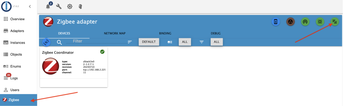

  1. Connect the coordinator hardware to computer running ioBroker (or the network, in case of LAN/WLan coordinators).
  2. Open a console on the server. In case of Unix/Linux based systems, this can be done remotely via ssh. Depending on the OS used, additional programs (e.g. puTTY on Windows) may be needed.
  3. Determine the coordinator path. On Unix/Linux systems, this is often located in the /dev/serial/by-id directory. Alternatively, /dev/ttyUSB*, /dev/ttyAM* (Unix/Linux), /dev/tty.usbserial-* (macOS), or com* (Windows) are expected.
    The following example shows a Linux installation on a Raspberry Pi. The command ls -la /dev/serial/by-id/ produces the output shown in the image.
  4. ioBroker -> Install the ZigBee adapter, here version 1.8.10 as an example.
    This installs all required software components (converter and adapter).

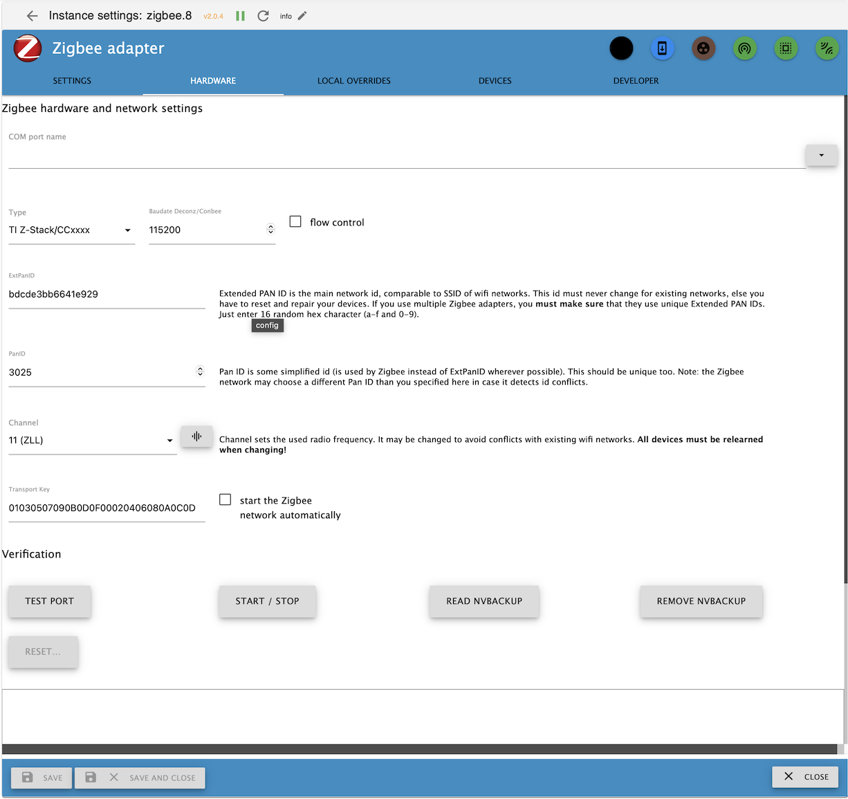

  5. Open the adapter configuration. The above image shows the interface version 3.0.0 or newer. In this situation, the admin indicates whether the ZigBee subsystem is started (A).
  6. Enter the port for the coordinator (B). In the case of USB coordinators, this is the previously determined device path. For coordinators controlled via the network, the network address and port must be specified in the form tcp://ip:port instead of the device path. If the adapter itself (not the Zigbee subsystem) is active, a list of available serial interfaces is available for selection. The following applies when selecting:
  • If multiple adapters with different USB devices are used for communication on the system, a port from the /dev/serial/by-id directory (if available) should absolutely be selected. This ensures that the adapter's association with the coordinator is retained when the system is restarted.
  • If only one USB device is used, the /dev/TTY* port is preferable. This allows the coordinator to be replaced with an identical device in the event of a defect without having to adjust the configuration.
  1. Assign a Network ID and Pan ID to distinguish it from other ZigBee networks within wireless range. e.g., starting with adapter version 2.1.0, ExtPanID (C) and PanID (D) are automatically pre-assigned with random values ​​until the configuration is saved.
  2. Select a suitable ZigBee channel (E). Please note that ZigBee and 2.4GHz Wi-Fi share the same frequency band. The optimal channel therefore depends, among other things, on the Wi-Fi channels used in the area. The channel names for ZigBee and Wi-Fi are not identical, e.g. WIFI channel 11 and Zigbee channel 11 do not interfere with each other. It is also advisable to limit your selection to the ZigBee Light Link channels (11, 15, 20, 25). If a channel is selected that does not belong to the ZLL, the interface displays a yellow triangle with an exclamation mark above the entered channel.
    After the adapter has been successfully started, a scan of the network channels can also be performed via the configuration.
    Note: Starting with adapter version 3.1.0, it is possible to change the channel without deleting the configuration and re-pairing all devices. Individual devices may not respond to the channel change request; these devices will then need to be re-paired. This is most often true for end-devices.
  3. Check whether the Zigbee subsystem is starting. To do this, try starting the Zigbee subsystem using Start/Stop (F). The progress of the start attempt can be observed in the log. The icon (A) changes from black/red to black/orange while the Herdsman starts. If the attempt was successful, the icon disappears completely; otherwise, it turns red again, and the messages in the log provide clues as to the cause.
    The Herdsman can also be stopped using the same button. The icon is also displayed in black/orange. Important: Stopping can take up to 2 minutes in some cases – especially when using network coordinators. Patience is required here. After Herdsman has been terminated, the icon appears in black/red and the message 'Herdsman stopped!' appears. Depending on the error, there are various possible reasons why Herdsman may not start. If it is 'just' a timeout, it is certainly advisable to repeat the attempt immediately. If the configuration is inconsistent, the relevant data is displayed in the log. The adapter offers two options for resolving the conflict:
  • Reading the data from the NV backup. In this case, the adapter's configuration is adjusted.
  • Deleting the NV backup. In this case, the adapter's configuration remains as it is. This forces a rebuild of the network, which subsequently requires all previously trained devices to be reset and retrained.
    The log output can also be used to search for a solution in the ioBroker Forum. Please highlight the messages and post them as text in the forum.

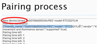

The ZigBee device is then in pairing mode for typically 60 seconds. Similar to the procedure for resetting to factory settings, activating the pairing mode also depends on the respective device type (if necessary, read the operating instructions of the ZigBee device).
  • Coordinator: Press the green button to put the coordinator into pairing mode for 60 seconds.
  • Wait until "New device joined" appears in the dialog:
  • Check Pairing: The device to be paired must be supported by the ioBroker ZigBee adapter. In the best case, a new device is displayed in the ZigBee adapter (e.g. Philips Light Stripe) and corresponding ioBroker objects are created:
  • In the worst case, the ZigBee device is not currently supported. The next section describes what needs to be done to use this ZigBee device anyhow.

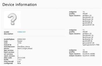

Pairing of unknown ZigBee devices so far
For previously unknown ZigBee devices, the ZigBee name of the ZigBee device (e.g., HOMA1001) appears during pairing with the suffix "supported": false.
Rotating this tile provides detailed information about the ZigBee device:
After registering at github.com, the missing ZigBee device can be reported via an "issue":
Include the detailed information about the tile (see above) in the issue, create a brief documentation (preferably in English), and submit it. A developer will then respond to the issue.
One of two options is possible as a result:
  • Adapting to the Zigbee Herdsman converter. This requires an updated version of the Zigbee adapter, which is first tested and then made available in the Latest Repository.
  • Creating an "external converter" – a file with JS code that can be copied to the Zigbee adapter's data directory and specified in the adapter's configuration. In both cases, restarting the adapter is sufficient – ​​the adapter's correspondingly adapted data points will be created. If data points are no longer supported, they will be highlighted in orange, and the adapter will display a button for deleting the orphaned data points.

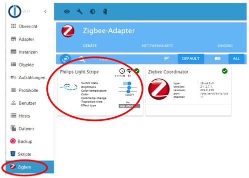

Device tiles
IconDescription
Time since a data exchange last took place with this ZigBee device.
Battery level, if the device reports a battery level.
Strength of the ZigBee radio signal on this ZigBee device (<10 poor, <50 medium, >50 good). ZigBee is a wireless mesh network. Most mains-powered ZigBee devices (e.g., Philips Hue lamps) can act as ZigBee routers, i.e., as wireless nodes. ZigBee devices therefore do not necessarily have to establish a direct wireless connection to the coordinator, but can instead use any router in the network for a wireless connection. With each ZigBee router, the wireless range of the network is extended. All ZigBee devices regularly check whether there is a better wireless route and automatically switch over. However, this process can take several minutes.
Manually assigning devices to routers is not possible.
The red, crossed-out symbol is displayed when a device is considered 'not connected'.
Status of a group
A green circle indicates that a group has members and is functional; the red X appears when a group is empty or unusable for other reasons.
