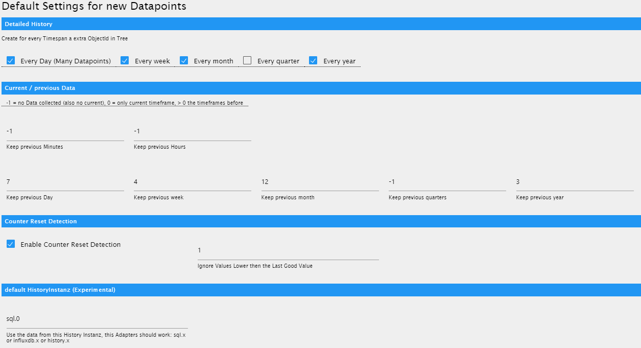

Default settings
plot These are the default settings which will be prompted whenever you activate ValueTrackerOverTime on a datapoint. For each datapoint those can be customed, but the initial values most commoly used) are set here as default values so later you don't have to make to many modifications.
Detailed history
In the secion "Detailed History", the datapoints to be created will be selected. Will you want to collect the data for every
  • day
  • week
  • month
  • quarter (of a year)
  • Year
  • Infinite (never reset)
Current / previous data
In the section "Current / previous data" you are able to select how long you want to keep the collected data for every ValueTrackerOverTime-datapoint which is generated for each timeframe. It makes sense to stop collecting the data once it ends up within another datapoint (for example: After 7 days, the data can be found cummulated in a week. After 4 weeks the data will find itself in a month...)
Counter Reset Detection
This value should always beenabled and set to one. It helps the ValueTrackerOverTime to make correct readings after a value in the original datapoint is being resettet.

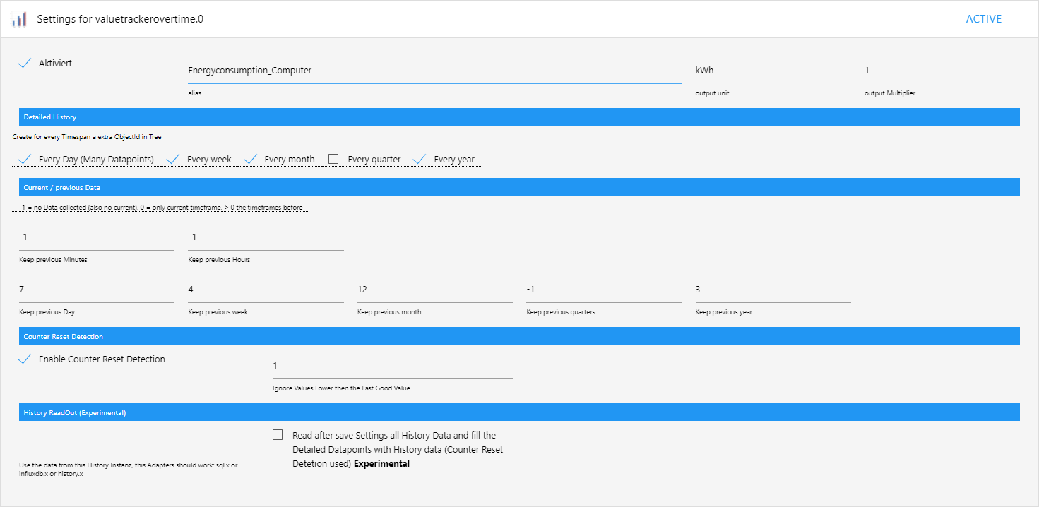

Datapoint settings
plot In this setting you have to give a nema which will be used as the datapoint name for this selecion node. Additionally you have to give the unit you want the data to be collected in. So if you want to measure the amount of rain, you can add the unit l/m² or you want to measure the amount of consumed enery as Watt hours (kWh). In case the datapoint itself uses a different unit (i.E. Wh) you can add a multiplier here (i.e. 60 or 1/60) to converse the data into the required unit.
The rest of the settings will overwrite the default settings which have been set in the adapter instance.
