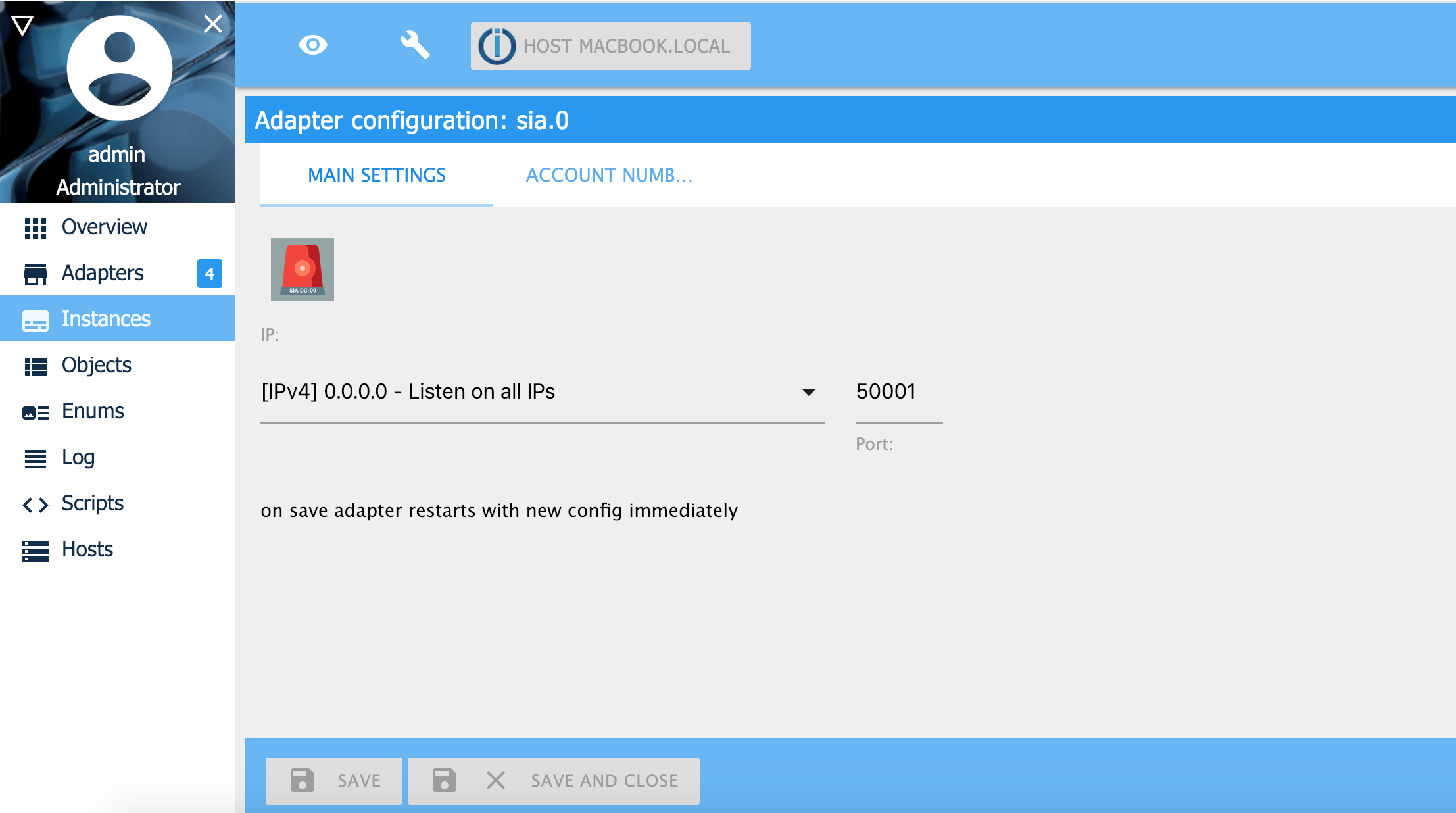

    Choose the IP-address and port for listening for SIA requests. sia_adapter1

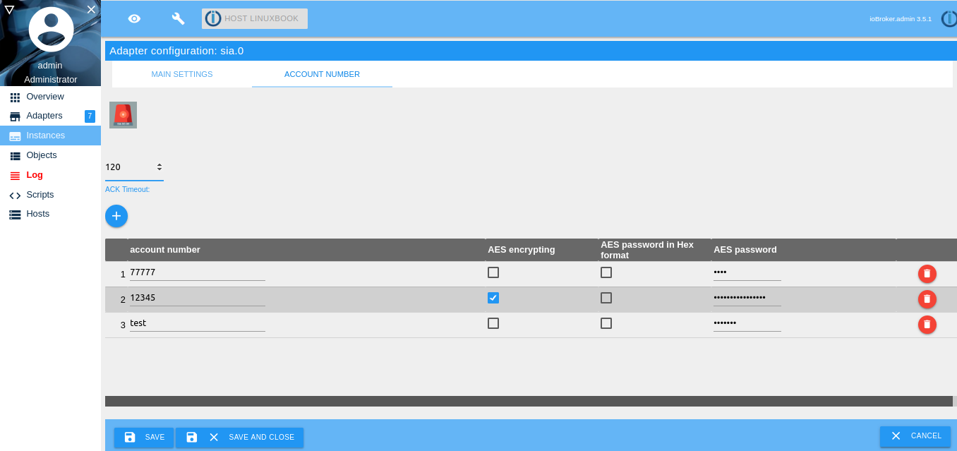

    Register account number. If you are using AES you have to enter a password (key). The key should be 16, 24 or 32 characters (byte) long. If the checkbox "AES password in Hex format" is active, the password length must be 32, 48 or 64 character (byte) long. In the field ACK timeout, you define how old the message can be in sec. If you define 0 sec., no timeout validation will be done. With the checkobx "Connection close by SIA Server", you can decide if the alarmsystem has to close the connection after it received the ACK message. If the checkbox "Connection close by SIA Server" ist disabled, the SIA server (ioBroker) waits 30 seconds for closing the connection by the alarmsystem. After this 30 seconds the SIA server (ioBroker) will close the connection.

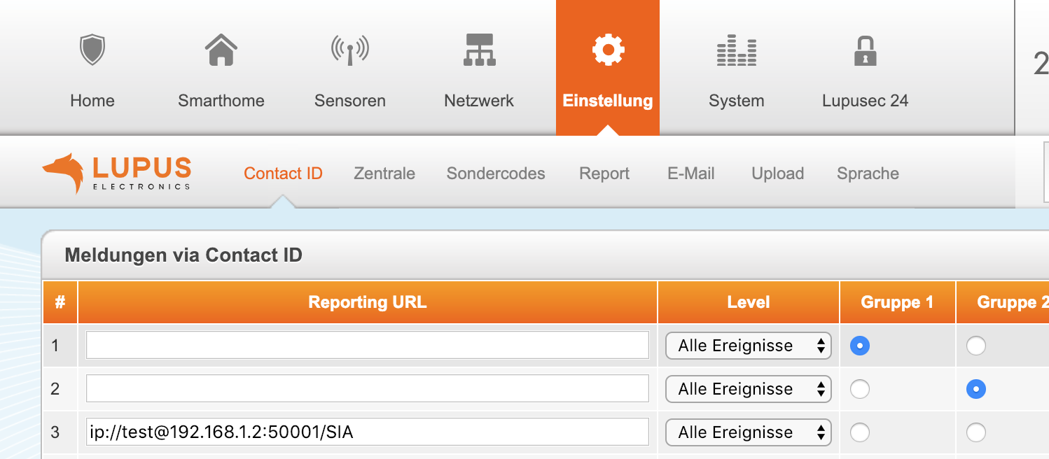

  3. Configure your burglar system to send SIA messages
    sia_lupusec1
    • Lupusec XT1+/XT2/XT2+/XT3/XT4 (SIA-DCS):
      Einstellungen -> Contact ID : ip:/subcriber@ip-address-iobroker:port/SIA Example: ip://A111F@192.168.20.55:55001/SIA
    • Lupusec XT1+/XT2/XT2+/XT3/XT4 (*SIA-DCS) encrypted:
      Einstellungen -> Contact ID : ip://subcriber@ip-address-iobroker:port/SIA/KEY/(128,196 or 256 bits key in HEX) Example: ip://A222F@192.168.20.55:55001/SIA/KEY/3A1F6B8C9D4E7F20123456789ABCDEF0
    • Lupusec XT1+/XT2/XT2+/XT3/XT4 (ADM-CID):
      Einstellungen -> Contact ID : ip://subcriber@ip-address-iobroker:port/SIA Example: ip://A333F@192.168.20.55:55001/CID_SIA
    • Lupusec XT1+/XT2/XT2+/XT3/XT4 (*ADM-CID) encrypted:
      Einstellungen -> Contact ID : ip://subcriber@ip-address-iobroker:port/CID_SIA/KEY/(128,196 or 256 bits key in HEX) Example: ip://A444F@192.168.20.55:55001/SIA/KEY/3A1F6B8C9D4E7F20123456789ABCDEF0
    • Other alarm systems:
      the Adapter will work with all alarm systems, which supports the SIA-DCS, *SIA-DCS, ADM-CID or *ADM-CID

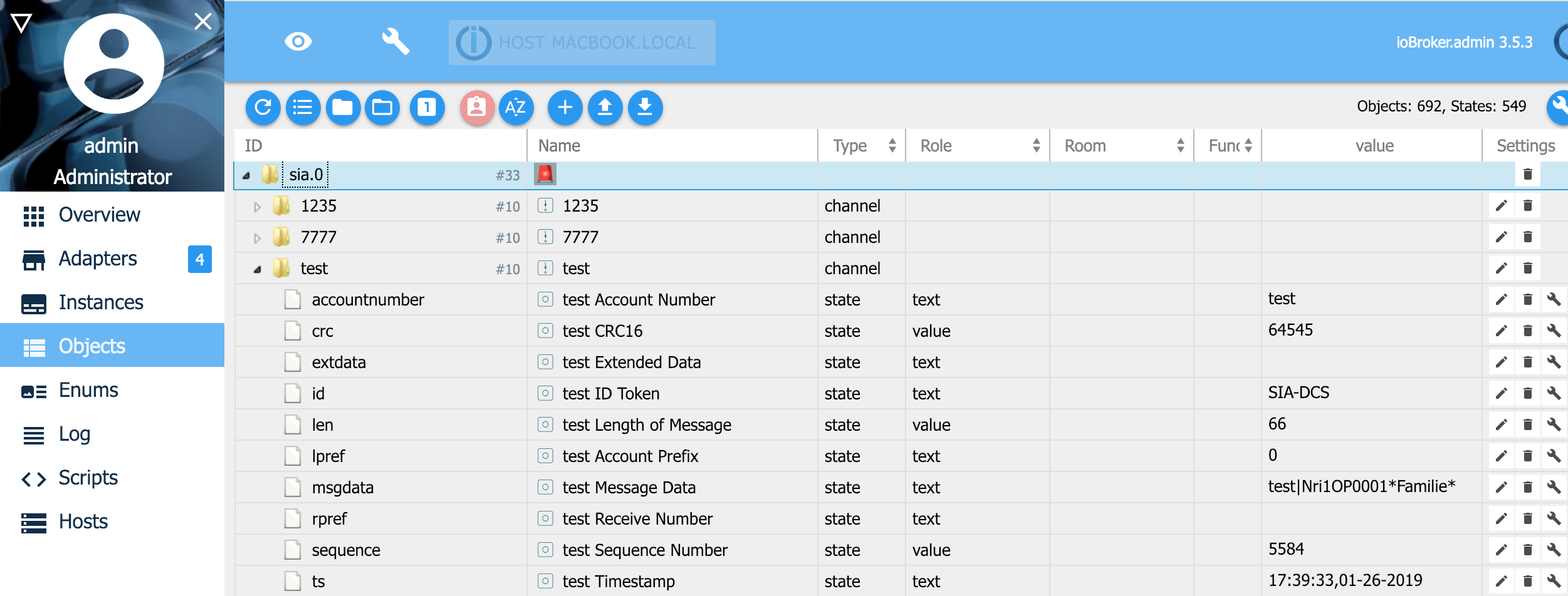

  4. SIA Objects / States
    If you receive SIA messages, you see them in the states tree under the chanel accounts
    sia_adapter3
    You see following object for every account:
    ObjectDescription
    accountnumberAccountnumber (3-16 ASCII characters, "0"-"9", "A"-"F")
    crcCRC Checksum
    extdataExtended data(ACII Data)
    idID Token (example SIA-DCS)
    lprefAccount prefix
    msgdataMessage data and it is always represented in ASCII
    rprefReceiver number
    sequenceSequence number
    tsTimestamp (only included in encrypted messages)
    Interessting is the object: msgdata (message data). Here you can see the thrown event of the alarm system. How to interpret the event, you have to ask your alarm system manufactor.
