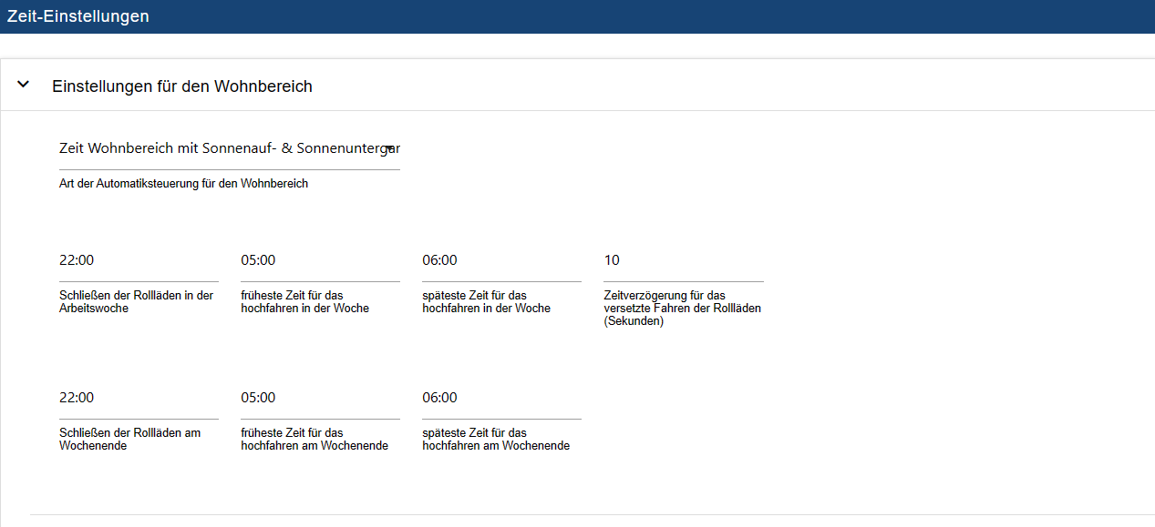

Settings for the living area, sleeping area and children's area
The individual settings are opened via dropdown. The description is given as an example for the living area and applies analogously to all areas. for all areas.
:point_right: Of course, this categorisation does not necessarily have to be used for a living, sleeping or children's area. children's area, but makes it possible to define three areas in the building with different movement times of the roller shutters.
Type of automatic control for the living area
Pulldown is used to select between:
  • Living area time only:
    *The roller shutters are only operated time-controlled.
  • Time living area with sunrise & sunset.
    *The roller shutters are controlled according to sunrise and sunset, but do not go up
    up before the earliest time and not down after the latest time.
  • Time living area with Golden Hour:
    *Analogous to the sunrise and sunset, but with the beginning and end of the "Golden Hour" as a reference.
Closing the shutters during the working week: Customary time for darkening during the week.
Earliest time for raising during the week: *This is the earliest time for raising the shutters during the week.
Latest time for raising during the week: This is the latest time at which the roller shutters will be raised during the week.
Time delay for the staggered raising of the roller shutters (seconds): *Distance between the individual raising of the roller shutters
of this range, e.g. to avoid radio interference or to give the impression that they are being moved manually.
Closing of roller shutters at weekends: *Customary time for darkening at weekends and on public holidays.
Earliest time for raising at weekends: *This is the earliest time at which the shutters are raised at weekends and on public holidays.
Latest time for raising at the weekend: At this time the roller shutters are raised at the weekend and at the latest on public holidays.
:point_right: If roller shutters are never to be raised if the sun has not yet exceeded a certain has not yet passed a certain position, this time must be set to the latest time of this sun position (on 21.12.).

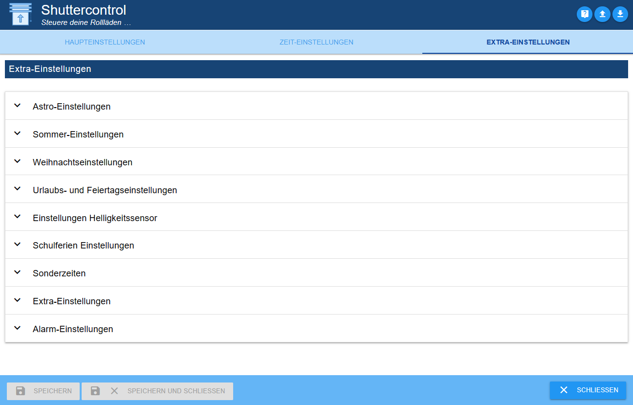

EXTRA SETTINGS
ConfigExtra

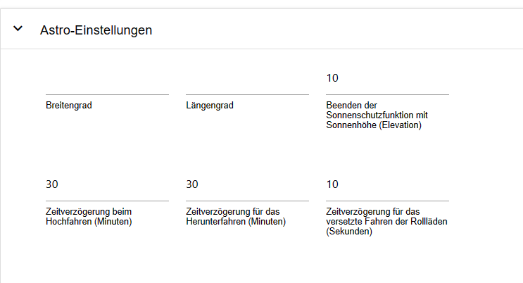

Astro settings
extraSettingsAstro
Latitude and longitude: *Shuttercontrol takes the latitude and longitude from the ioBroker system settings.
Shuttercontrol uses these values to calculate the position of the sun.
Exiting the sun protection function with sun height (elevation): *As soon as the sun falls below the height set here, the shading ends.
the shading by Shuttercontrol ends.
:point_right: Possibly existing premature shading due to buildings or high trees, can be taken into account here and end the automatic shading earlier.
Time delay for raising or lowering (minutes): *A +/- offset can be entered here,
by which the shutter movements should be delayed from the type of automatic control selected in Time settings.
Time delay for staggered shutter movement (seconds): *To prevent all shutters from moving at the same time,
a global time delay in seconds can be set here.

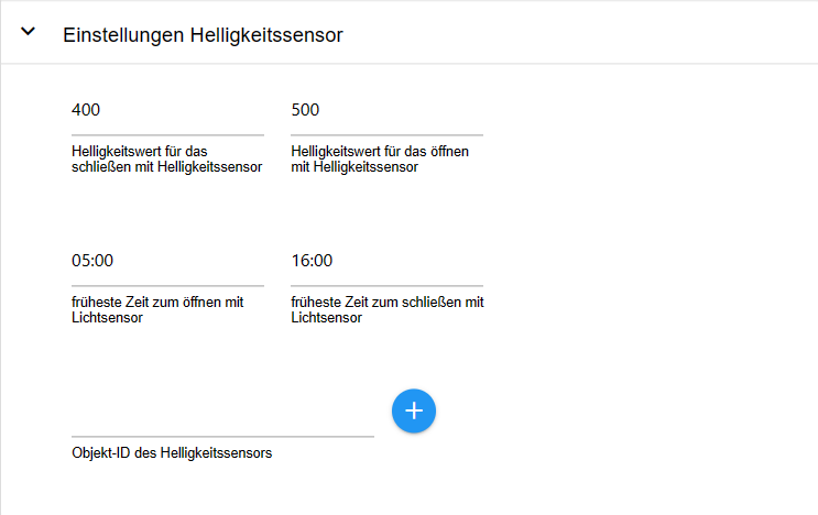

Brightness Sensor Settings
extraSettingsBrightnesssensor
If the shutters are to be moved automatically using a brightness sensor, this is configured here.
Activation is then carried out individually for each shutter under Main shutter settings. under Type of control for closing (or opening) the roller shutter by selecting the entry "Brightness sensor".
Brightness value for closing with brightness sensor *Brightness value from which the shutters are to be closed.
Brightness value for opening with brightness sensor Brightness value from which the shutters are to be opened.
Object ID of brightness sensor *The reference to the brightness sensor, e.g. from a weather station or from an outdoor motion sensor or separate brightness sensor.

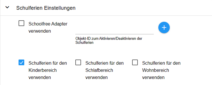

School Holidays Settings
extraSettingsSchoolholidays
Here, the holiday period can be activated either via a separate data point with Object ID for activating/deactivating school holidays or by setting the tick the instance of the installed Schoolfree Adapter.
The shutters then open during the holiday period at the set times for weekend driving.
Holiday mode can be activated individually for each area.

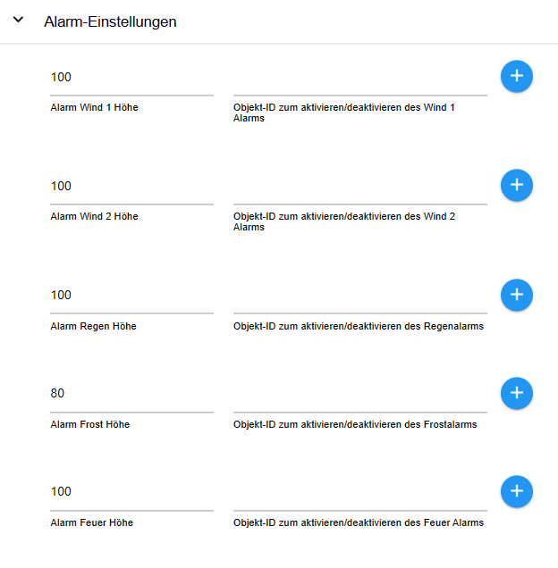

Alarm settings
extraSettingsAlarm
:point_right: For each alarm, a logical data point (true/false) is required for activation, which activates the alarm = status true or deactivates the alarm = status false.
:point_right: Furthermore, the height (0-100%) to which the roller shutter moves in the event of an alarm must be defined for each alarm.
point_right: In the Alarm setting of the respective shutter, it is then defined to which alarms the shutter should react. shutter should react.
Priorities of the individual alarms:
Prio 1 (highest priority) --> Fire:
If this alarm is triggered, the roller shutters configured for it will move to the set height in any case.
:exclamation: The shutters are then blocked and will NOT close automatically, even if the fire alarm is reset (false).
:point_right:After the fire alarm has been reset, the blinds must be reinitialised using the "openAll" / "closeAll" buttons.
This prevents the roller shutters from being closed again automatically for any reason in the event of a fire.
It also ensures that escape routes remain open and access for the fire brigade is guaranteed.
Prio 2 - 5 (same priority) --> Rain, Wind2, Wind1, Frost:
When these alarms are activated, Shuttercontrol moves the configured roller shutter to the last active alarm level.
When deactivating the individual alarms, however, the following priority is observed:
Prio 1 = Fire
Prio 2 = Rain
Prio 3 = Wind 2
Prio 4 = Wind 1
Prio 5 = Frost
The frost alarm only has a direct effect if the activated roller blinds are already closed (danger of the roller blind freezing). If the frost alarm is triggered when the roller shutter is still open, the roller shutter automatically only moves to the height set for frost alarm when it is closed.

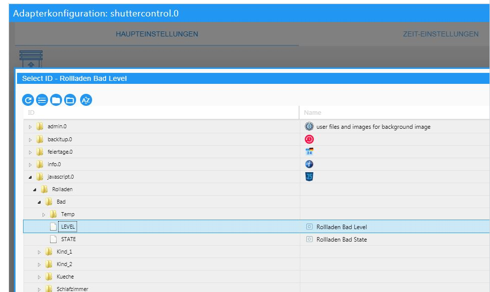

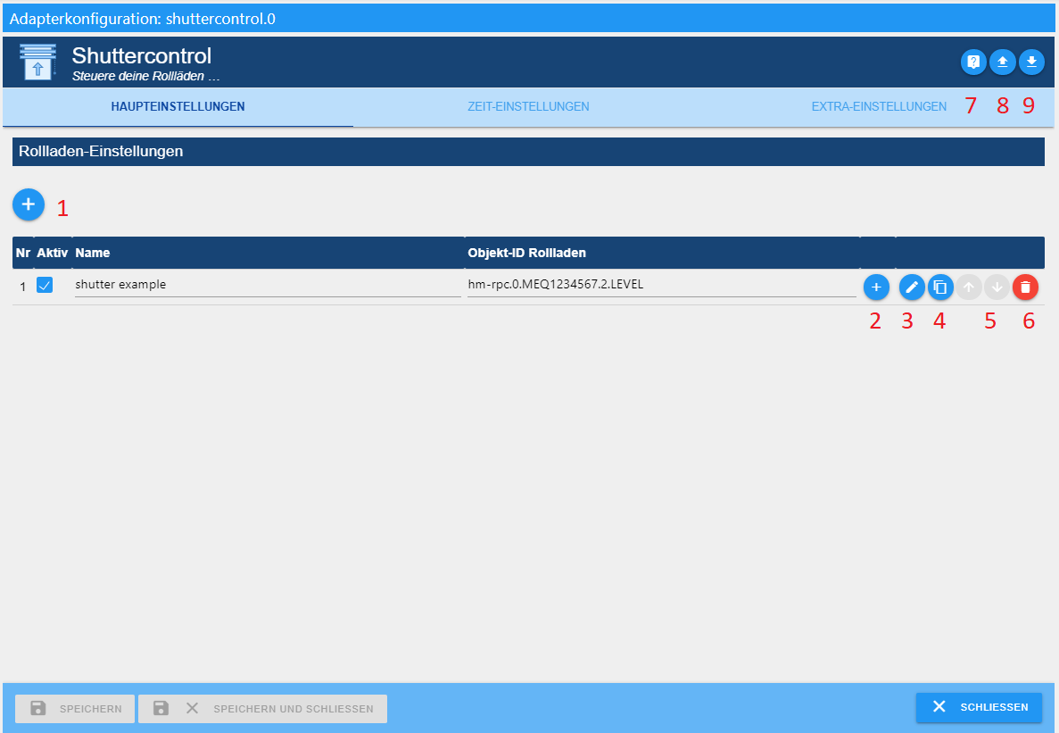

:point_right: The example actuator shutter example is automatically created, please delete it via the waste bin (5).
Now add your own shutter actuators by clicking on the (+) (1). The ID selection opens and select the data point LEVEL that represents the position of the desired roller shutter.
ID_Selector_DP_Levelg

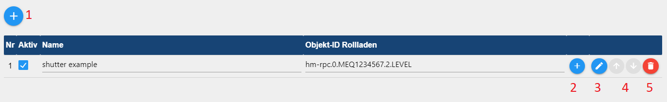

Structure of the table:
tab
  • No: consecutive number of the listed shutters.
  • Active: Checkbox for activating/deactivating the control of the corresponding roller shutter.
  • Name: *Name of the actuator is automatically read in from the objects when the ID is selected and can then be changed according to your own wishes.
  • Object ID shutter: Unique ID of the data point to be controlled in the objects.
  • (+) Change a selected roller shutter actuator * Pencil * *Modify a selected roller shutter actuator
  • Pencil Open individual configuration of the respective roller shutter.
  • Double sheet: Copy roller shutter
  • Arrows: *Determine the order in which the roller shutters move with the same settings.
  • Trashcan:* *Deletes the shutter actuator with all configured data.
After the roller shutters have been created, pressing the pencil (3) on the corresponding roller shutter with the tabs MAIN SETTINGS for roller shutters, SUN PROTECTION SETTINGS and EXTRA SETTINGS
each shutter is further configured individually.

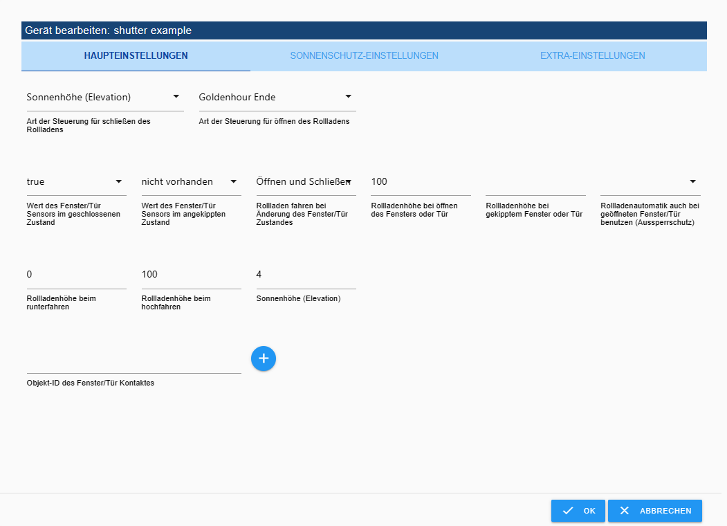

In the upper area, the times for opening or closing the shutter are selected are selected separately via a pull-down menu.
:point_right: These times have already been configured in Time settings.
Selection options:
  • Off: *Do not use timers.
  • Living area: *The shutter moves at the times as configured in Living area settings.
  • Living area (automatic):** * *The roller shutter moves at the times configured in Settings for the living area. and in addition, the shutter is activated in response to the trigger defined under Extra settings. Object ID for activating/deactivating the auto living area''. If If this is set to false, the roller shutter will not be moved automatically.
  • The roller shutter is moved at the times configured in Sleeping area settings.
  • The roller shutter is moved at the times configured in Settings for the sleeping area. and in addition, the shutter is activated in response to the trigger specified under Extra settings. Object ID for activating/deactivating the auto-sleep area''. If this is set to false, the roller shutter will not be moved automatically.
  • Children's area: * *The roller shutter is moved at the times configured in Children's area settings.
  • Children's area (automatic):* *The roller shutter moves at the times configured in Settings for the children's area. and in addition, the shutter is activated in response to the trigger defined under Extra settings. Object ID for activating/deactivating the auto children's area''. If this is set to false, the shutter will not be moved automatically.
  • Sunset/Sunrise:** * *The shutter moves at sunset or sunrise.
  • Sun elevation:If the elevation falls below the value set here, the roller shutter is closed.
  • Golden Hour:** * *The roller shutter closes at Golden Hour, which, depending on latitude and time of year, is approx. 1 hour before sunset or after sunrise. before sunset or after sunrise, depending on latitude and time of year.
  • Brightness sensor:** * *The roller shutter only moves according to the brightness sensor, which is set under Brightness sensor settings.
  • Manual operation only:** * *The roller shutter can only be moved manually in the selected direction. :point_right: No movement is possible via the buttons under shuttercontrol.0.control.
    point_right: This can be useful for awnings, for example, which should not be opened together with other roller shutters. which should not be opened together with other shutters.
Value of the window/door sensor in the closed state: *Here, the value is defined that the trigger under Object ID of the window/door contact (e.g. window or door contact) can have. (e.g. window or turn handle contact) at which the automatic roller shutter system is allowed to move indefinitely. :point_right: Values such as true, false, 0, 1 or 2 can be selected.
point_right: If the roller shutter is not in the uppermost position and the sensor status specified here changes, the roller shutter moves to the uppermost position. sensor status changes, the roller shutter moves to the roller shutter height when the window or door is opened.
Value of the window/door sensor in the tilted state: *This sets the value that the trigger under Object ID of the window/door contact (e.g. window or door contact) is set to. (e.g. window or turn handle contact) at which the automatic roller shutter system is allowed to move indefinitely.
:exclamation: If no window contact with tilt function is present, this value should be set to "not present".
Move roller shutter when window/door status changes: Pulldown to select the function that is to be carried out when the window/door sensor moves should be carried out:
Off: no movement
  • Open: When opening the window/door, the shutter moves up and remains there, when closing the shutter does not move.
  • Close: After closing the window/door, the roller shutter moves to the blackout position, when opening, the roller shutter does not move. Opening and closing: The roller shutter moves up when the window/door is opened and moves down again when it is closed.
Roller shutter height when opening the window or door: *Wanted roller shutter position from 0-100, e.g. for windows 25% for ventilation, or 100% for doors to be able to pass through. for doors to be able to pass through.
Roller shutter height when window or door is tilted: *Wanted roller shutter position from 0-100, e.g. for windows 25% for ventilation.
Use automatic roller shutter even when window/door is open (lock-out protection) * If, at the time of automatic closing, the window/door sensor does not correspond to the value entered there (window/door closed), the following will be carried out according to the selected setting: *.
  • Off: Lock-out protection is active in both directions, the shutters do not move when the window is open.
  • Open: Only raising is allowed. At the end of darkening / shading, the roller shutter moves up even though the window is open. The roller shutter is not closed automatically when the window is open.
  • Close: Only closing is permitted. At the start of darkening / shading, the roller shutter moves down despite the window being open. The roller shutter is not opened when the window is open.
  • Opening and closing: The roller shutter may move in both directions when the window is open.
Also use these heights when an automatic closes with an open or tilted window: If this option is active and the window is open or tilted when the automatic mode drives down, the roller shutter afterwards moves to Shutter height when opening the window or door respectively Shutter height when the window or door is tilted. So far those heights are only used when the window / door sensor changes — with this option they also apply when an automatic closes. If Value of the window / door sensor when tilted is set to "unavailable", the height for the open window is always used.
:point_right: The roller shutter first closes completely to the darkening position and only then moves to the ventilation height. This is intentional: shutter motors are usually faster downwards than upwards, so the same percentage reached from above is a different position than reached from below. Starting from the closed end position, the configured value always matches the position that is also used when the window is opened.
:point_right: Between the two drives the adapter waits the Waiting time for checking the shutter status configured under Extra Settings (60 seconds by default). That time has to be at least as long as the run time of the roller shutter. The acknowledgement of the device is not a sufficient criterion: some devices — those connected through zigbee2mqtt for example — report the target position a few milliseconds after the command instead of at the end of the drive. A second command sent while the motor is still running is lost on those devices — the roller shutter then reports the ventilation height but stays closed.
:point_right: The option only changes the target height, not the drive permission. Whether the roller shutter may move at all while the window is open is still decided by the lock-out protection. If that is set to "Off" or "Open", the roller shutter still does not move when the window is open.
:point_right: An active frost alarm takes precedence — the frost protection position is still used in that case.
:point_right: If the window is closed while the roller shutter is still moving to the darkening position, it stays there and the ventilation height is no longer used.
:point_right: The full darkening position is stored and driven to as soon as the window is closed. This requires Shutters move when the window / door status changes to be set to "Close" or "Opening and closing", or Drive to position after window has been closed to be enabled.
:point_right: The option applies to all down automatics (time automatic, sunrise/sunset, golden hour, sun elevation, brightness sensor and late down). Sun protection and the manual "all down" button are not affected.
Roller shutter height when moving down: *Position value when the roller shutter is closed.
Roller shutter height when raised: Position value when roller shutter is open.
:point_right: The roller shutter height must be entered according to the actuators used (0-100 or 0-255): 0 = closed and 100 = open or 0 = open and 100 = closed.
Object ID of the window/door contact: Use the (+) to select the sensor (state) that is to prevent a roller shutter movement (e.g. door contact).

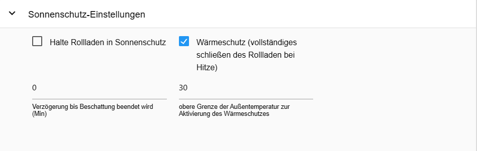

Sun protection settings
mainExtraSun
Keep roller shutters in sun protection If this option is switched on, the roller shutter remains in the sun protection, even if There is no longer any sun protection requirement and remains in the sun protection as long as until the “close” signal comes in the evening. This prevents the roller shutter from going up and down several times a day. Very practical in blind operation when the height is kept down (option checked), and just open and close the slats.
Delay for falling below the brightness until shading is ended (minutes) The time is set here at which a delay should take place if the shade is darkened and the brightness falls below the set level. The default value is 0 and can be adjusted if required. This option only works in conjunction with a brightness sensor
Heat protection This option allows the roller shutter to be completely closed in hot weather. After activating this option, the field for entering the temperature in °C appears.
:point_right: If a roller shutter is adjusted manually and the position does not correspond to that automatically, the automatic system stops!
:point_right: If the roller shutter is manually moved to the configured height for opening, closing or sun protection, the automatic function remains.

Alarm setting
mainExtraAlarm
Here the alarms predefined for the current roller shutter via Alarm Settings are activated or deactivated.

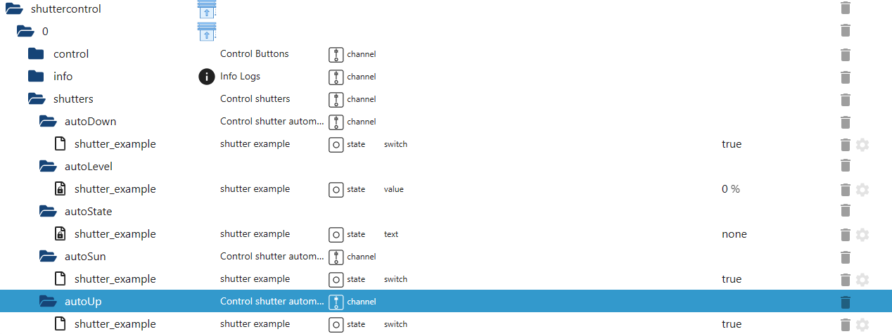

Data points
Shuttercontrol creates various data points under the following folders:
  • shuttercontrol.x.control
  • shuttercontrol.x.info
  • shuttercontrol.x.shutters
:point_right: x stands for the respective installed instance

shuttercontrol0shutters
datapointsshutters
  • autoDown For each roller shutter, automatic closing can be deactivated here with false or activated with true.
  • autoLevel Shows the current position for each roller shutter (roller shutter cannot be controlled via this).
  • autoState Shows the current status (up, down, Manu_Mode, sunProtect) for each roller shutter (roller shutter cannot be controlled via this).
  • autoSun The sun protection function can be deactivated for each roller shutter with false or activated with true.
  • autoUp For each roller shutter, automatic opening can be deactivated here with false or activated with true.
