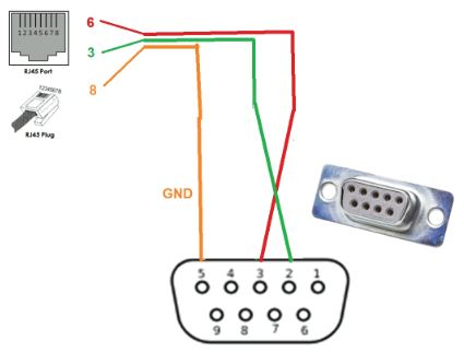

RJ45
| RJ45 | signal | DSUB | signal |
| 3 | TxD | 2 | RxD |
| 6 | RxD | 3 | TxD |
| 8 | Ground | 5 | Ground |

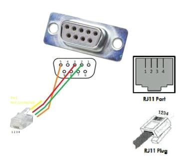

RJ11 / RJ12
The RJ11 and RJ12 connectors are the same size. The RJ11 has only four contacts, the RJ12 has six contacts. The contacts of the RJ11 are in the middle of the plug, which is why they are counted differently. Physically the contacts are in the same place.
| RJ11 | RJ12 | signal | DSUB | signal |
| 1 or 4 | 2 or 5 | Ground | 5 | Ground |
| 3 | 4 | TxD | 2 | RxD |
| 2 | 3 | RxD | 3 | TxD |

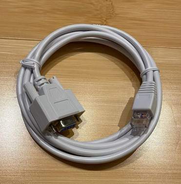

There are RJ45 console cables with USB port for Cisco routers. These do not have a compatible occupancy. However, with a little experience the RJ45 plug can be replaced.

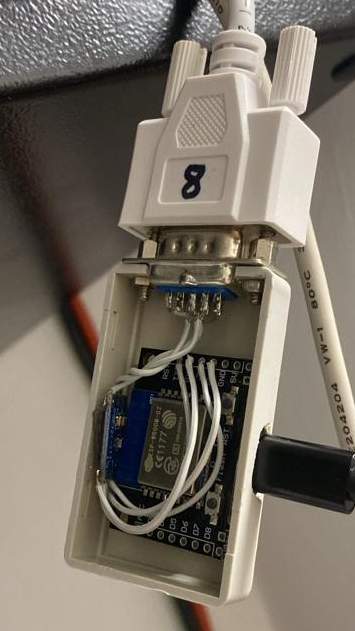

If there is no USB port nearby, you can build a serial to WiFi adapter with an ESP.
These adapters speak a kind of Telnet and essentially extend the serial interface through the WiFi. Here it is important to install a driver module for the serial interface. E.g. the MAX3232. Please pay attention to the voltages but most of them are 3V.

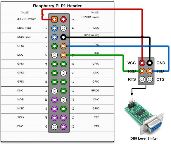

Raspi with MAX
Since the Raspberry also offers a TTL interface with 3V, you can also connect a MAX3232 here.

ESP with MAX
There are several projects that connect ESP or ESP32 to Telnet. Please remember the MAX. If the MAX gets hot then either the signal level of 5V is too high because you got a 3.3V model or you have connected a 3.3V version to 5V operating voltage.

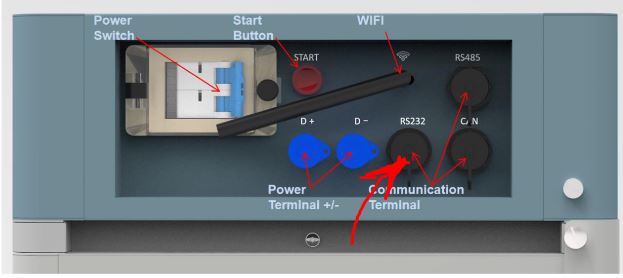

At the Force there is also a terminal.
